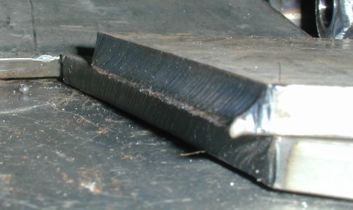

I would say that is either cutting too fast or cutting too thick for the power. The cut lines are at an extreme angle, they should only be slightly trailing.That’s extreme there’s something else going on. Current too high maybe
The plasma will generate a kerf due to the gasses swirling but most manufacturers cant the torch over so that you get one straight edge and one sloping that way you at least have a choice.Magnetic effect? Plasmas can be directed by magnets

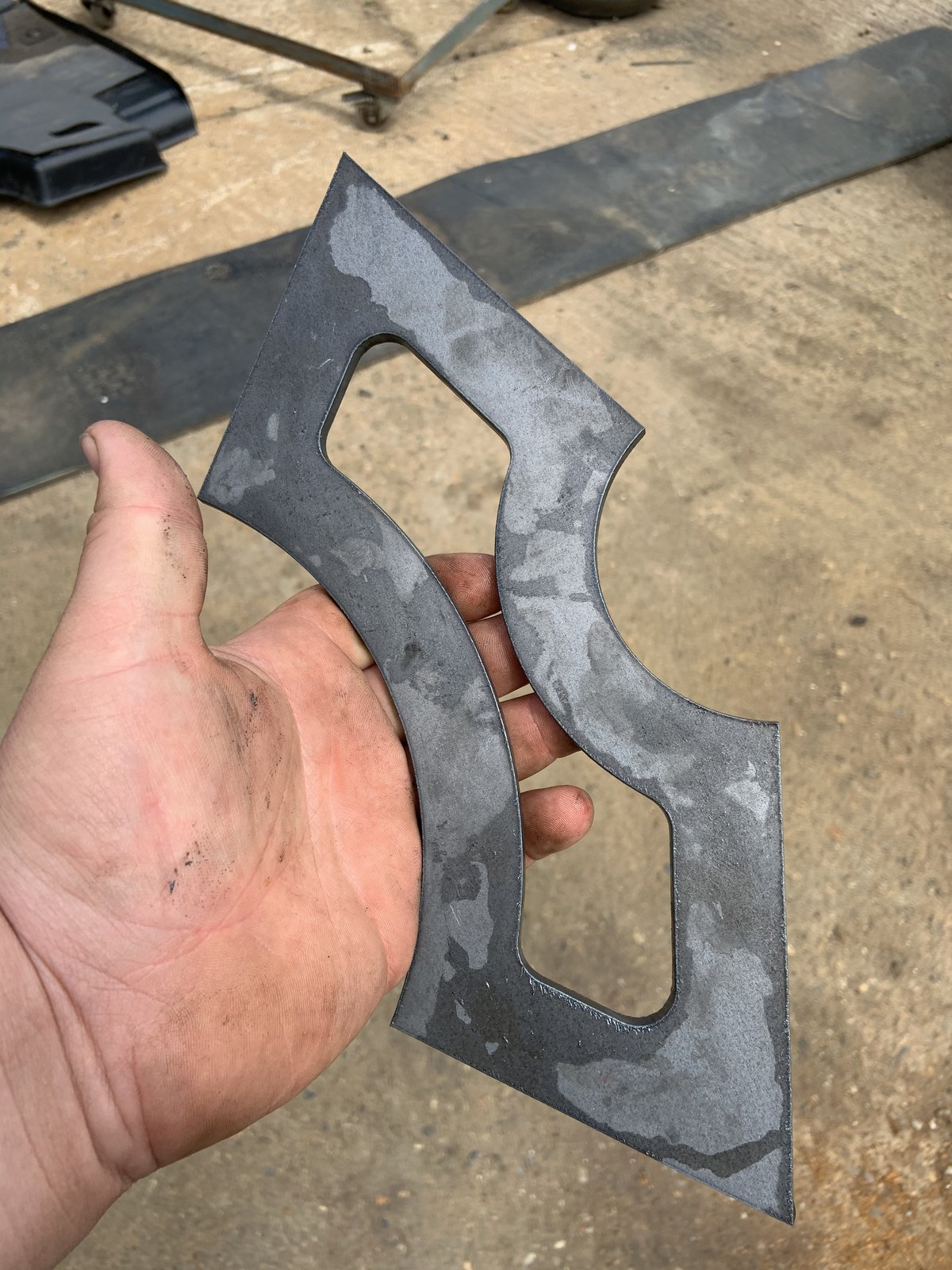

Yeah, a new problem. I was wondering though if I’ve knocked the magnetic torch/breakaway head and it isn’t quite inline as it’s only just started happening. Was cutting 5mm today and it’s probably 3-5° of taper. Certainly didn’t do it before. Will try consumables first that’s the easy thing.I would imagine Brad knows about the part/scrap directions, torch height bevels etc as he has been using the plasma for a while.
I suspect this is a new problem that has just happened and he is wondering why.

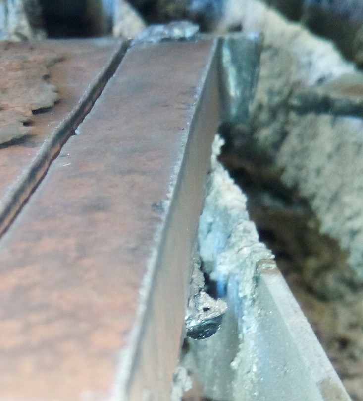

That is not good at all, I cut 20mm the last day with the new Jasic and there was minimal bevel as you can see here and my table is covered in crud and not exactly level in the first place.Just got my 45xp back from HT after they replaced the torch head due to the bevel problems I've been having.
I'm still getting 3-5deg on 5mm MS.

That’s not good. I wonder if this goes back to the fact Hypertherm isn’t made in USA anymore. Might as well have a Jasic in many respects now.Just got my 45xp back from HT after they replaced the torch head due to the bevel problems I've been having.
