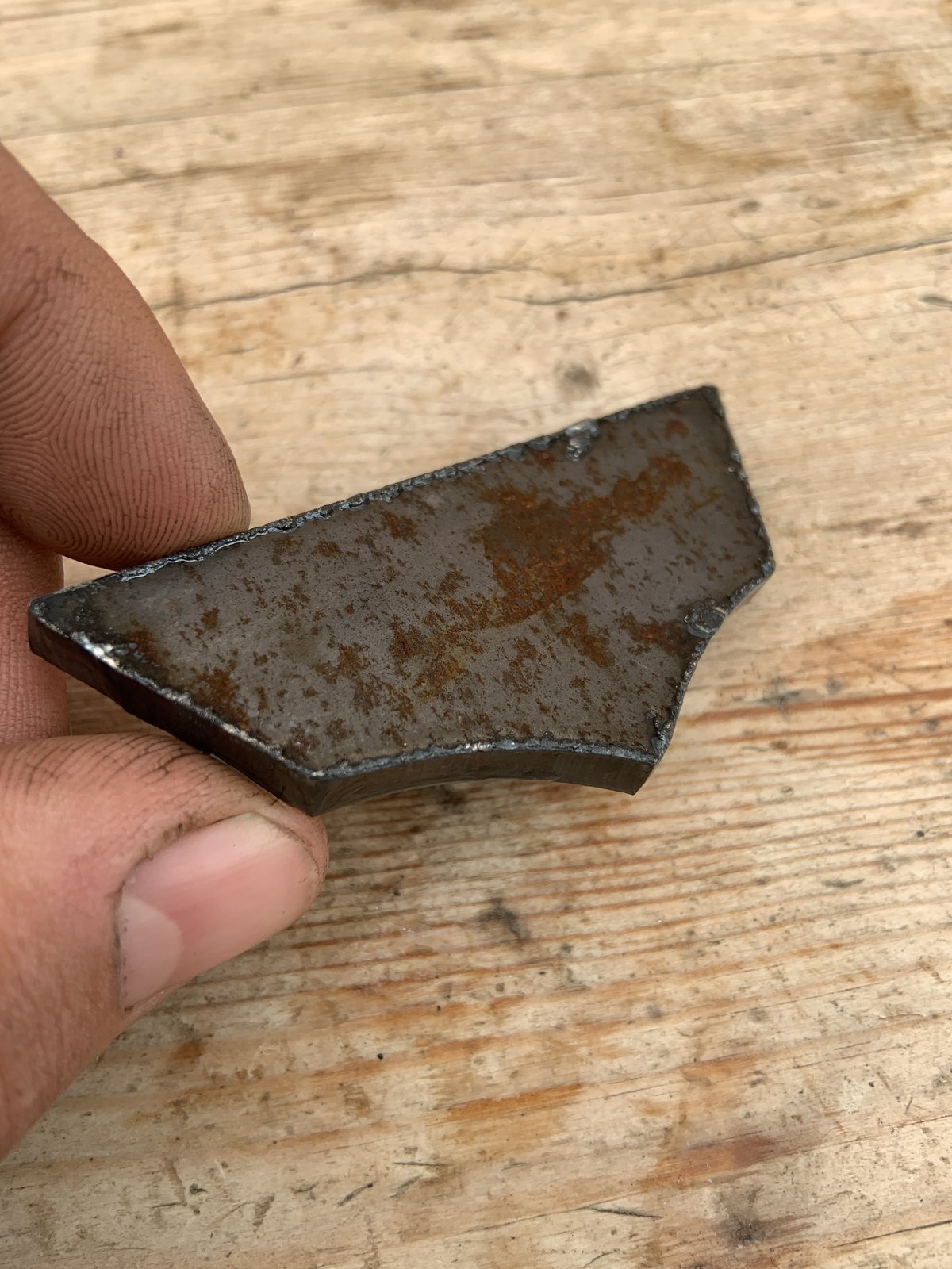

It is not quite as good at the ends but very acceptableAre all the sides like that John?
My guess is @MattH won't have soon. . Its not that far up the M5Dear god. Poor old Matt & me have got Hypertherms and are miles away from them results

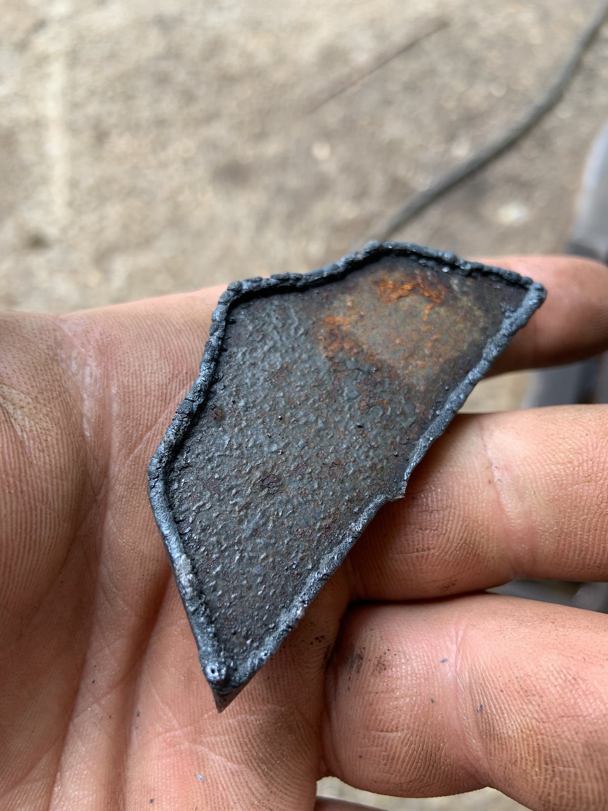

I’ve cut some 6mm today, and the quality just isn’t acceptable. It’s miles away from how it was when we got the plasma.
I don’t know what’s happened but something is definitely wrong, just the amount of dross is wrong.
This is so bad I’m gonna have to outsource these parts. Which means this table is actually costing more than if we didn’t have one at all.

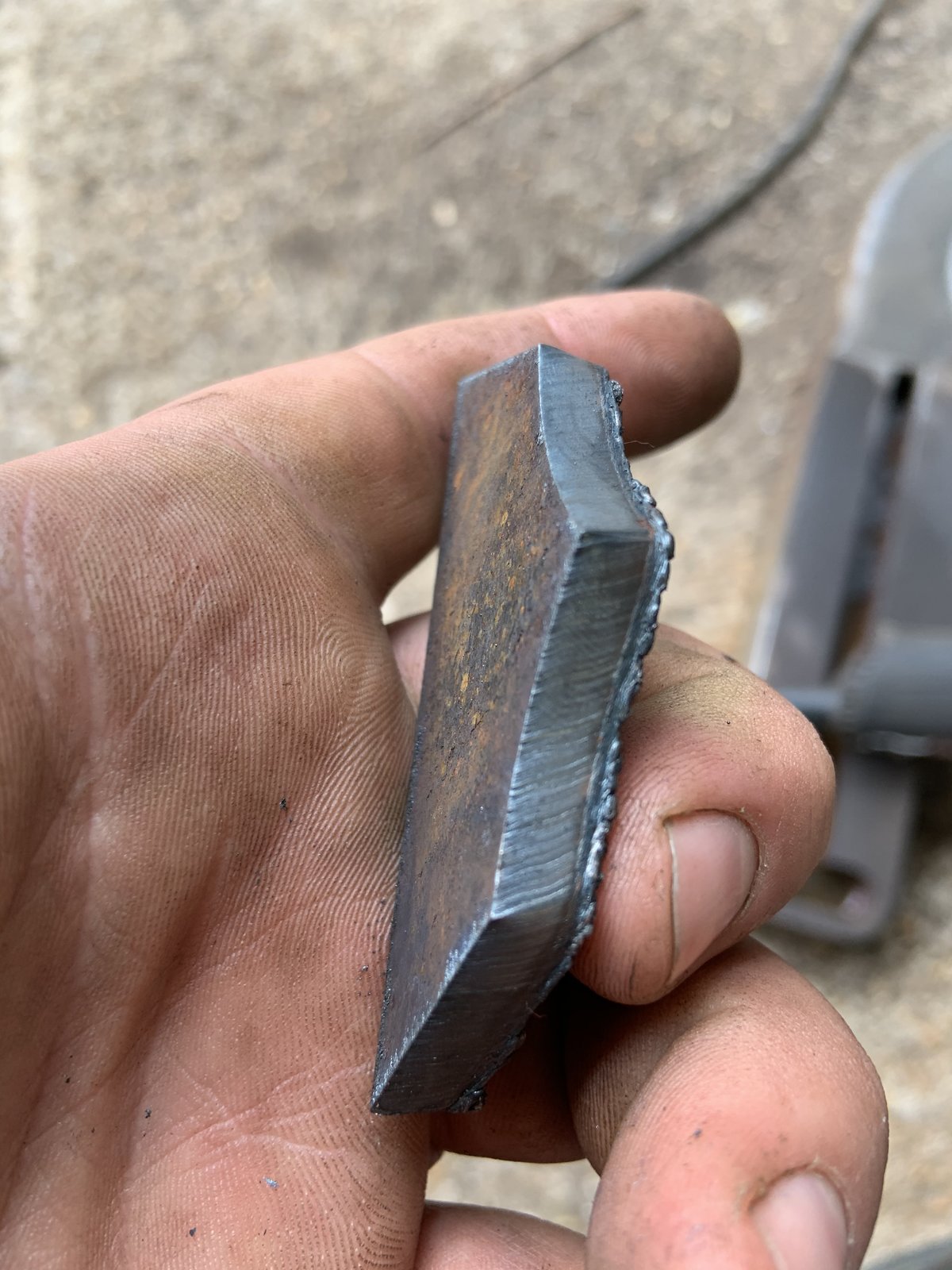

Nothing that isn’t on the Hypertherm website. They’ve said 5° taper is acceptableAny feedback from Swiftcut?

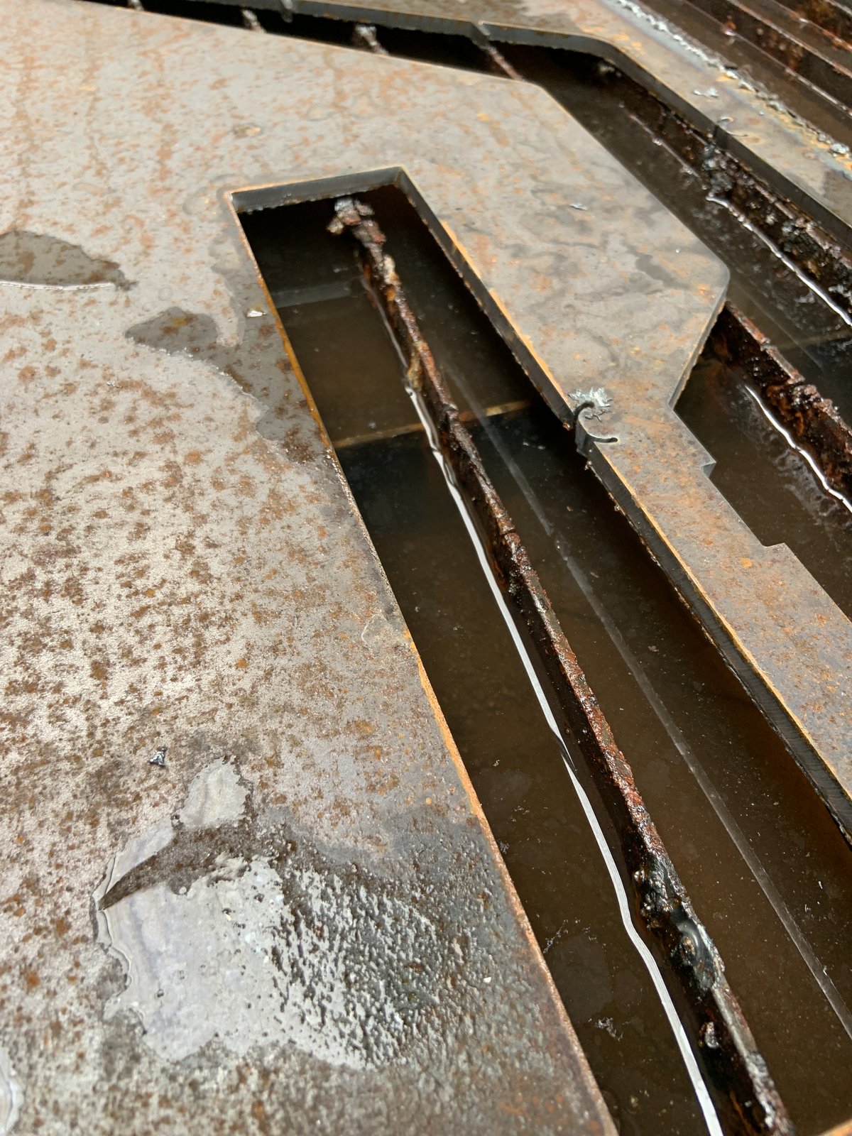

Is it nice clean plate?
Looking at the plate, its reasonable, but I'd have given that an extra volt or so... really rough plate up by a couple...looking at the way the cut edge and dross is, I'd say your cut speed is too fast.
When you did initial setup test cuts, and changed the default speeds and voltages in the libellula, are they saving? Theres a sequence to saving them, I think you had to save, then close the libellula software and restart before they take effect.
Most of the default settings we eventually put in from test cuts etc were a good few V higher than the HT default settings.
