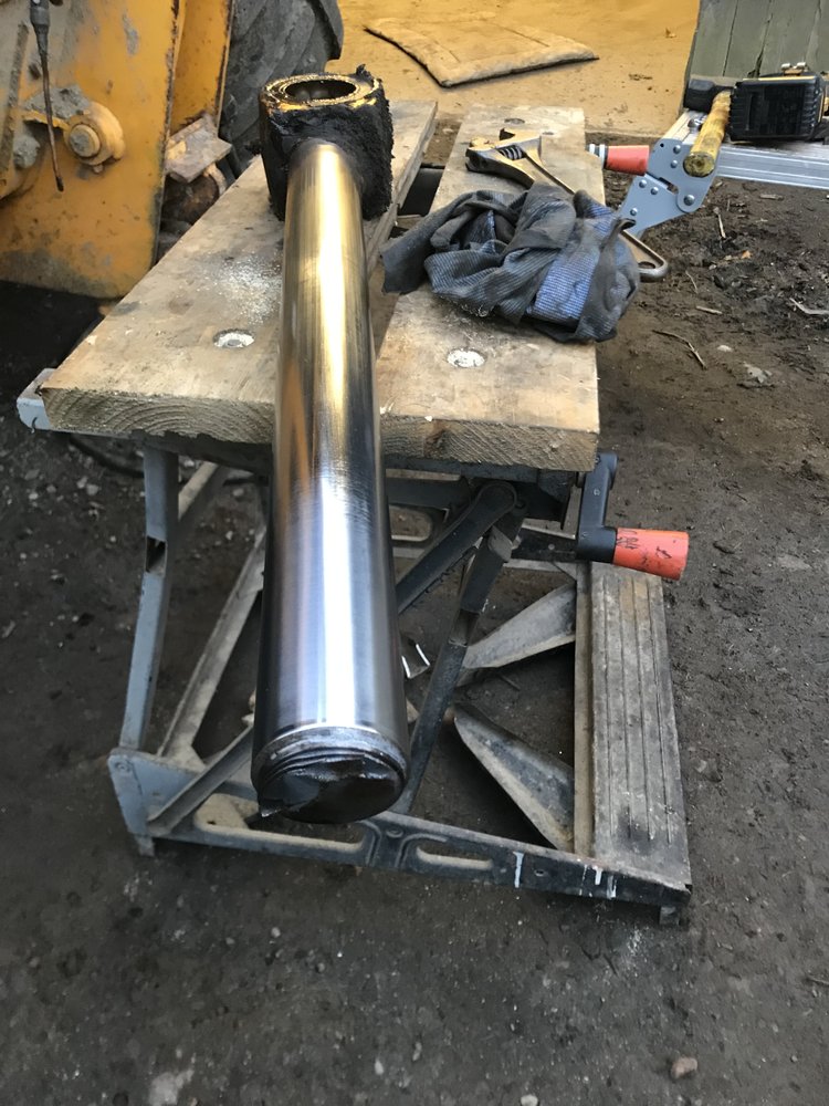

The compensator ram seemed loose inside, so I took the top pin out:
Piston has sheared off:
Looks like new ram time to me. Plan is to blank off the hoses (5/8” BSP?) and leave the top of the ram disconnected, so we can use the machine for now. I assume this is ok.
Then (somehow) take out the bottom pin and take the lot to a local hydraulics place.
