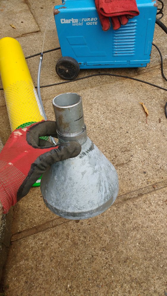

Do it as a series of spot welds with a big gap between each? Use an air line to cool the metal between welds....I'm going to have another go. This time I'll Dremel off the galvanising from the inside of the cowl. What I found when welding was that it'd seem to be going fine then I'd hit like a pocket of "gas" and a bit of the cowl would hole/disappear. Pushing forward with the torch seemed to work, starting on the thick tube then edging the molten pool up to the thinner cowl material to fuse it.
Someone suggested trying 0.8mm wire might be easier?

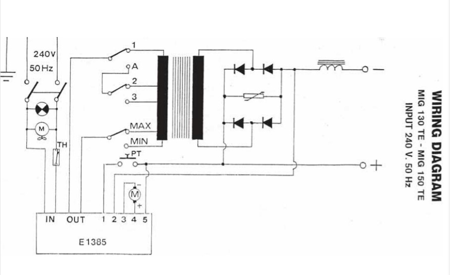

I'm thinking I'm limited on settings with this old welder? Presumably with a modern, inverter mig you can just turn a dial to set the amps?
I know nothing mind... I read it in a book....![]()
You need a shedThat was the plan. A proper pita having no specific, secure, covered workspace. Having to first fetch the welder, then the bottle now the compressor all onto the patio. You're always hoping it doesn't rain then having to put it all away again after.
