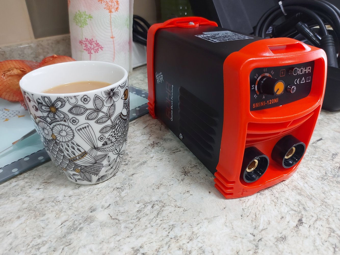

I mentioned this in other threads and some of you were curious so here are my thoughts.

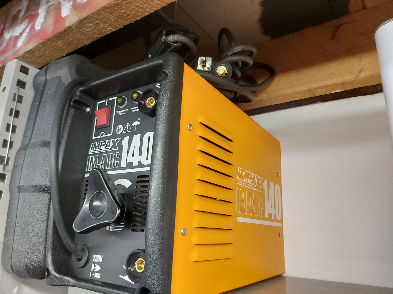

I already had this Impax Arc Welder and rods from screwfix. Bought it a couple of years back and used it on the roof of my carport for light box purlin welding.
More recently I used it to weld some brackets on my garage door. Both times I used it I found it hard to start off an arc unless it was a brand new rod and very careful. Most of the time it stuck badly and buzzed during this until I broke it free. Most times I junked the rod when that happened.
Therefore I was a bit frustrated with it. I don't use it often but when I do it was very difficult!
Some of you mentioned newer inverter arc welders being better. My TIG has arc function but it's too big to take on a roof for example and I also don't want to risk it!

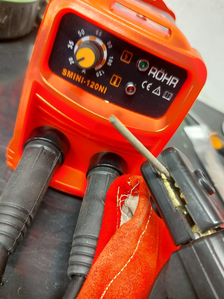

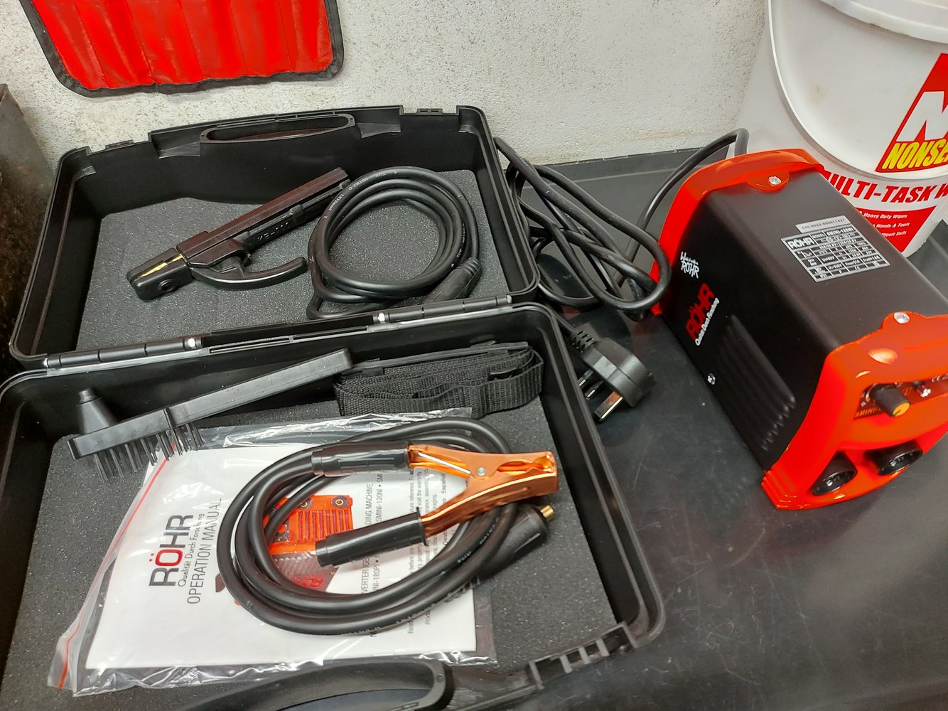

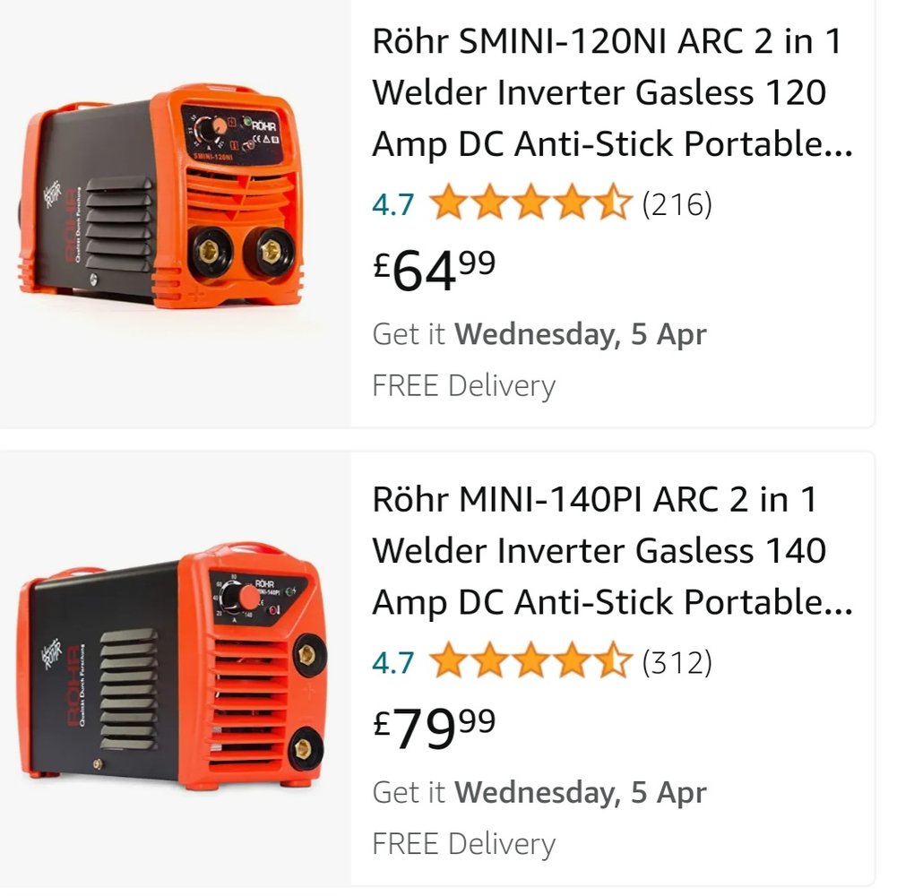

I did alot of research including hours on the old you tube and the Rohr branded 120NI on ebay or Amazon was the best bet.
I chose amazon but doesn't matter which they are both the same vendor. £65 posted. I ordered late Thursday night and it was here sat morning RM 24hr service.
More to come in 2nd post
