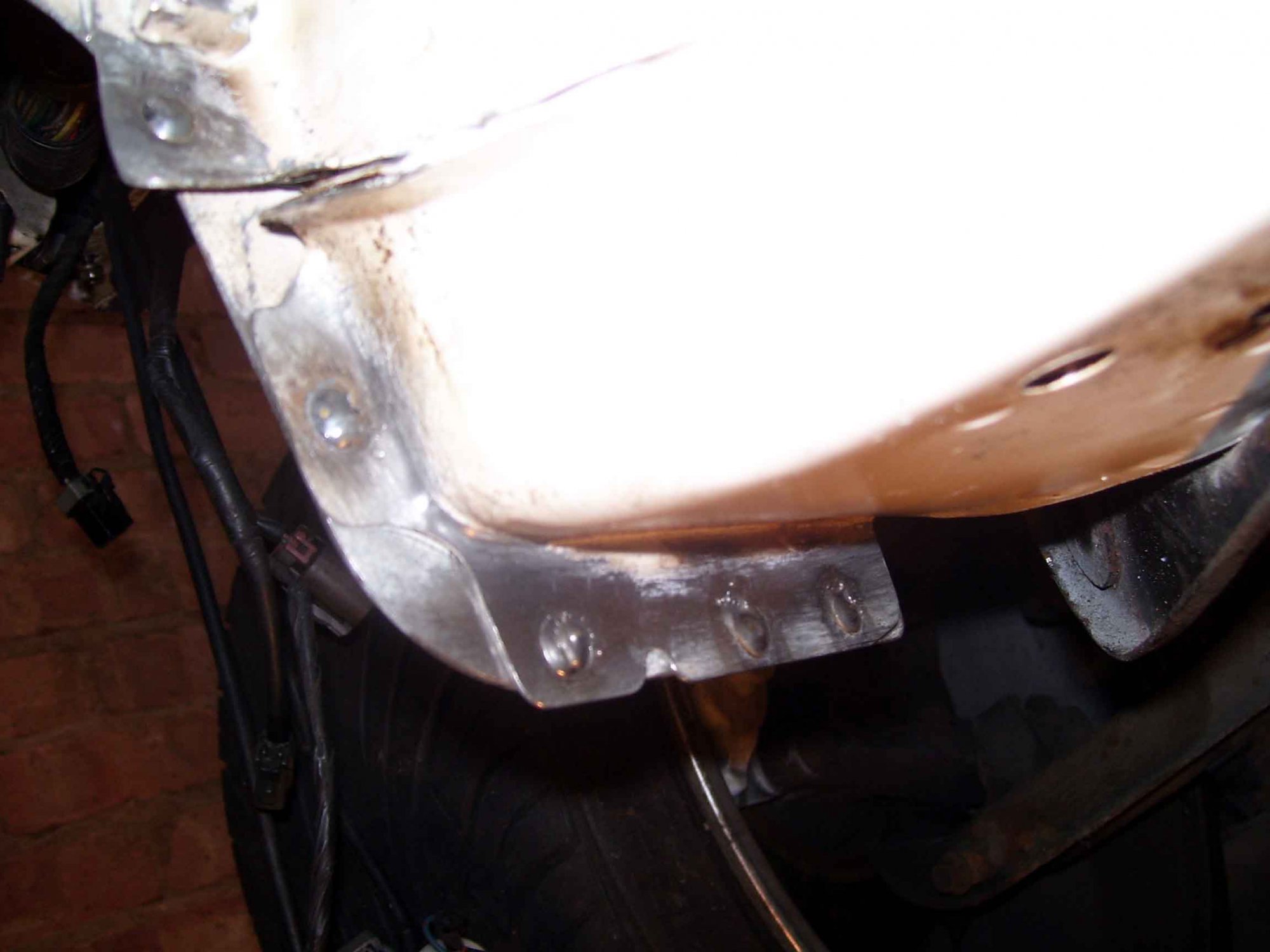

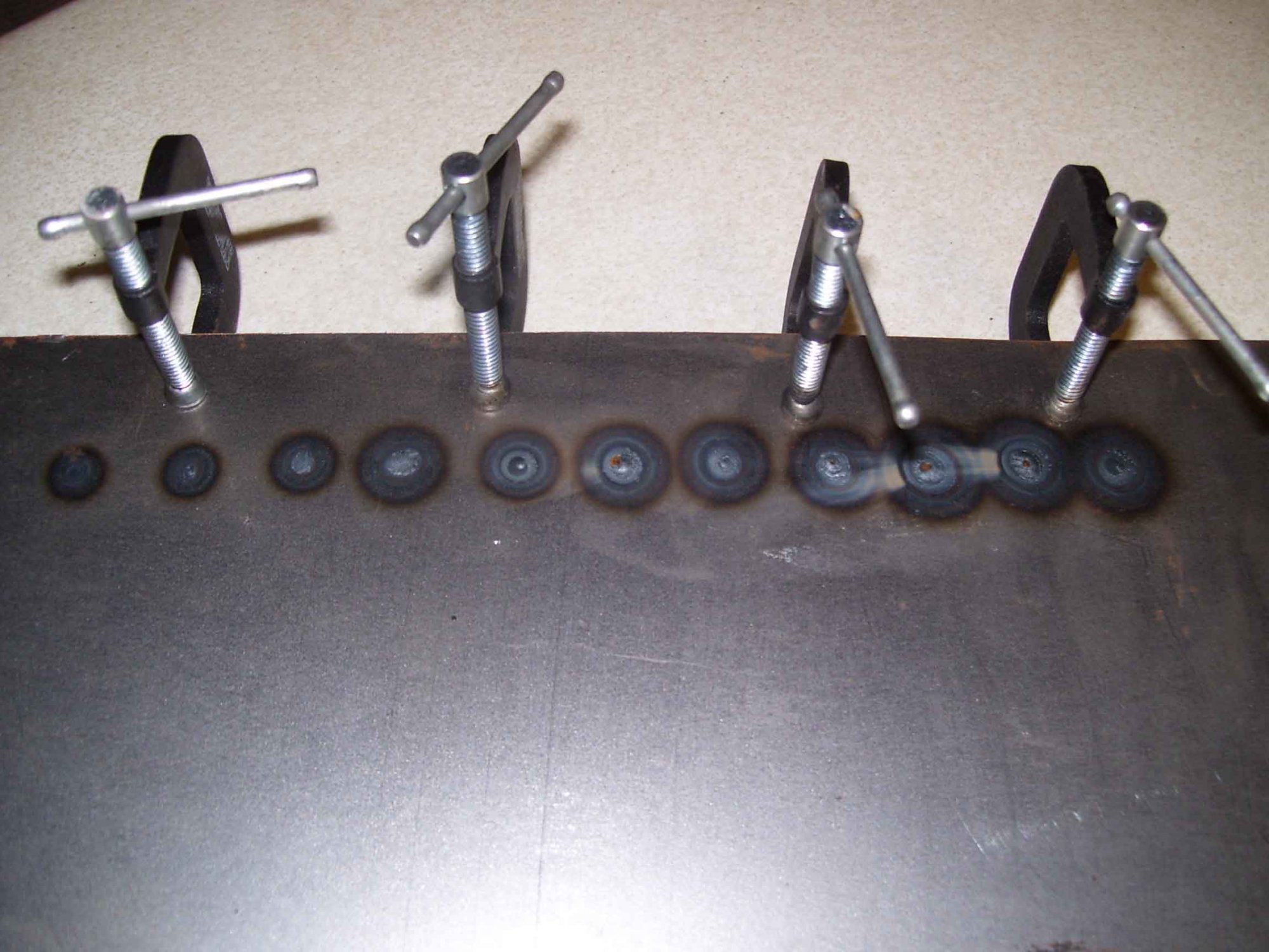

Your description and experience with the Clarke 135te sounds exactly like my Telwin (130A), I'm wondering if they're the same machine - slide-up side panel with louvres? Two flimsy plastic wheels and protruding flat bar handle on top? Overly-sensitive wire feed knob with markings in a square shape?

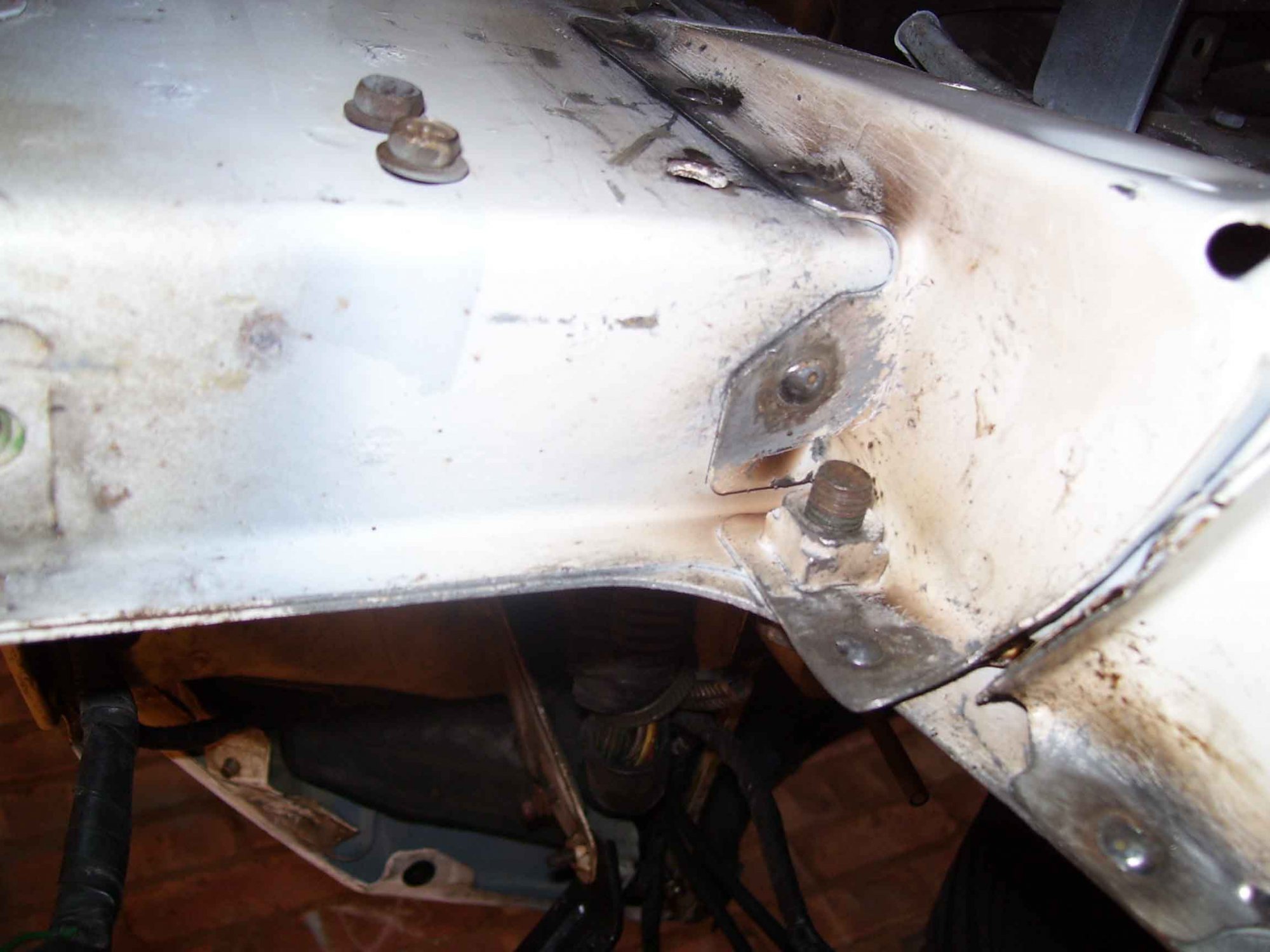

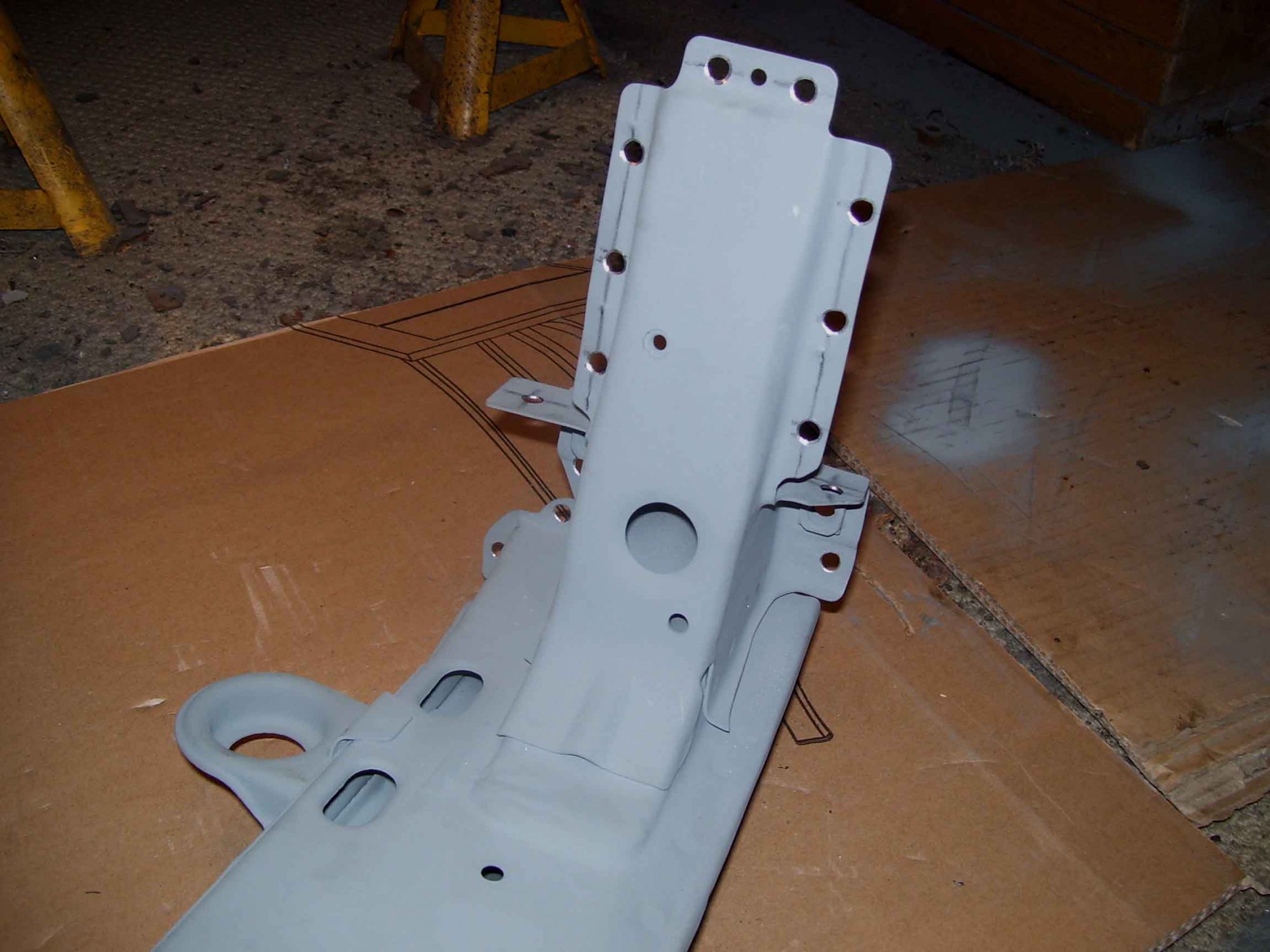

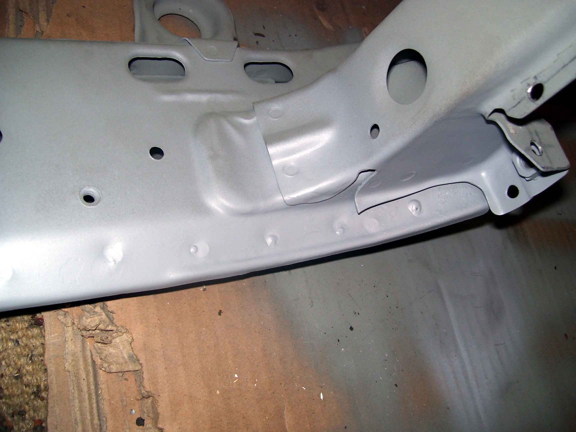

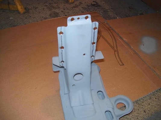

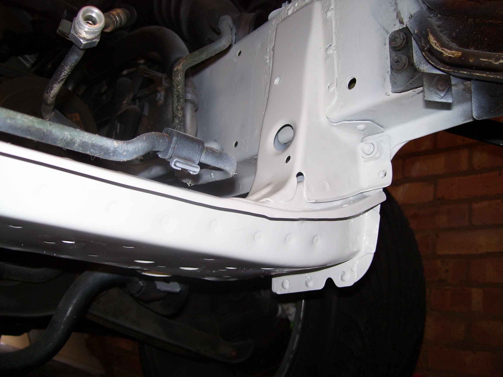

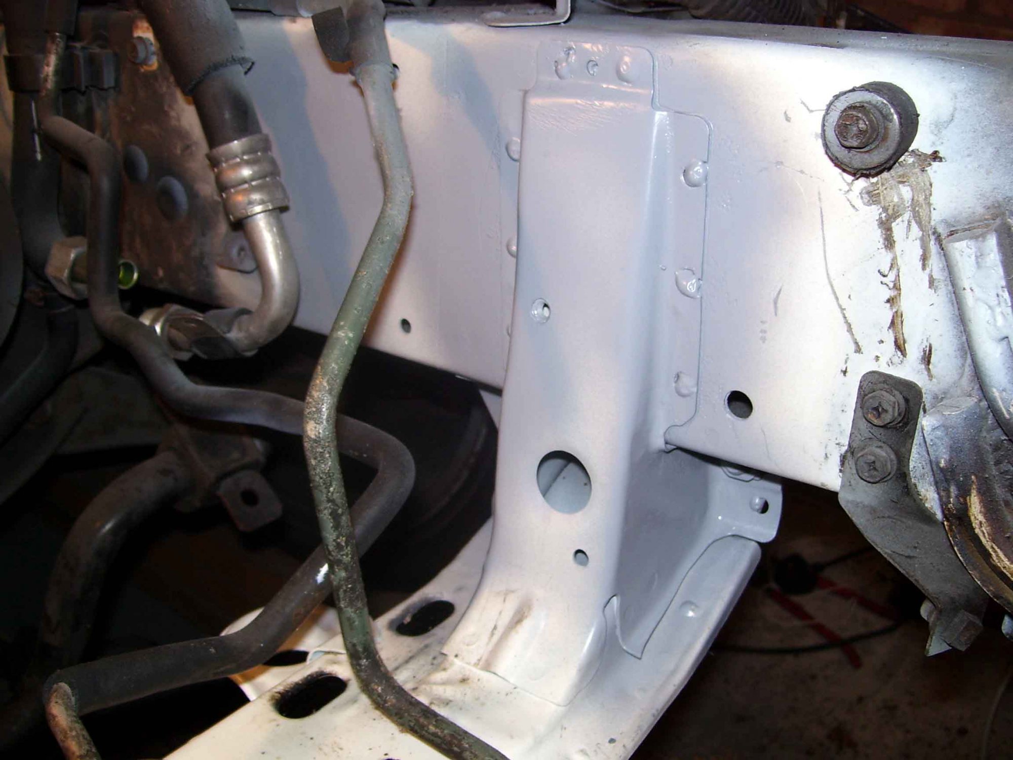

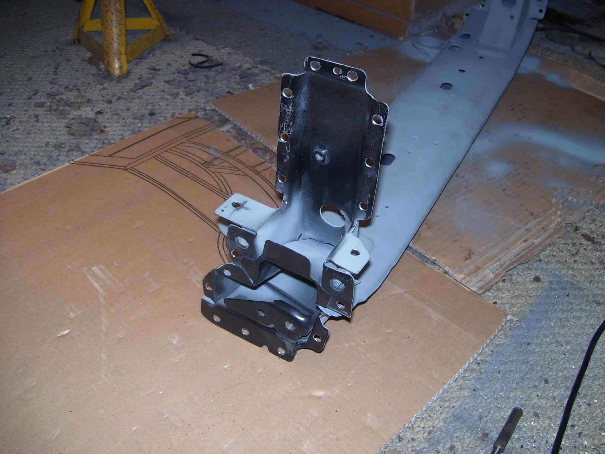

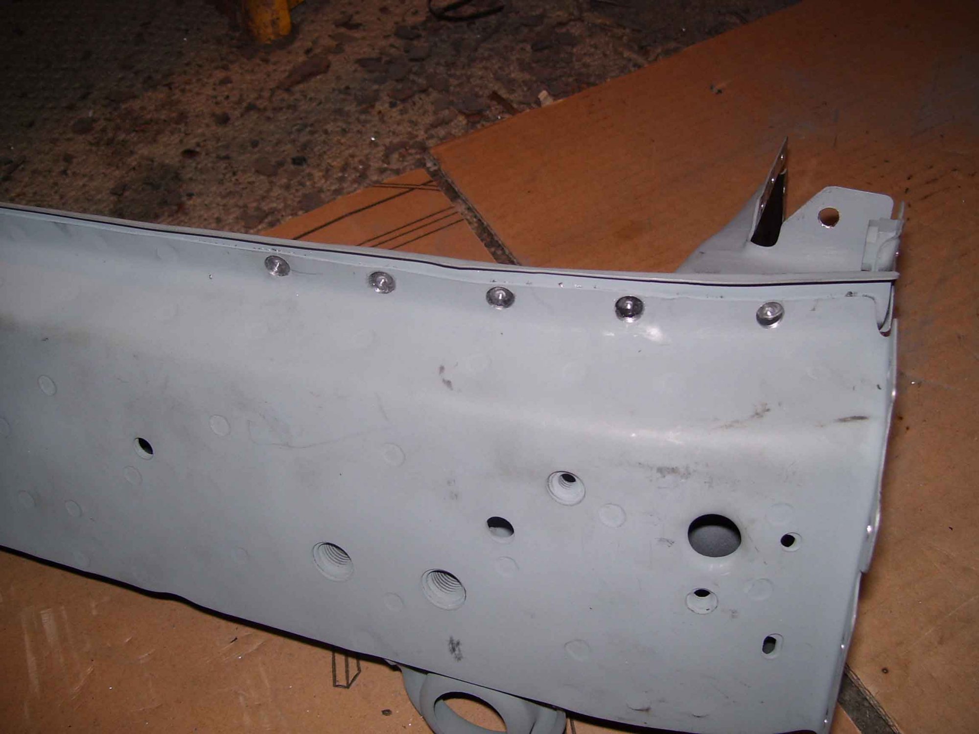

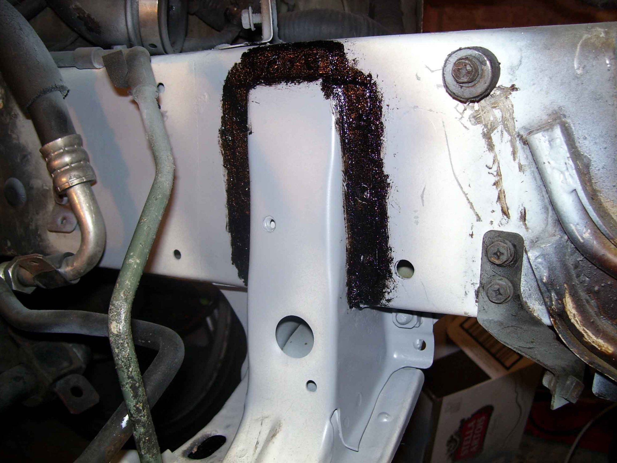

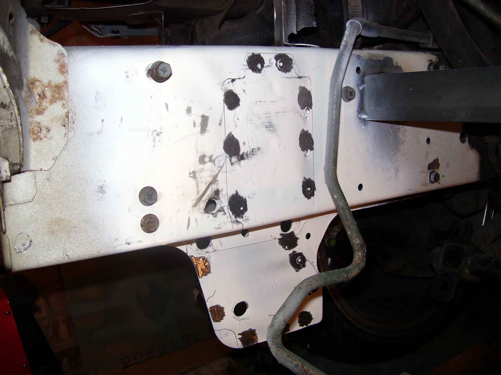

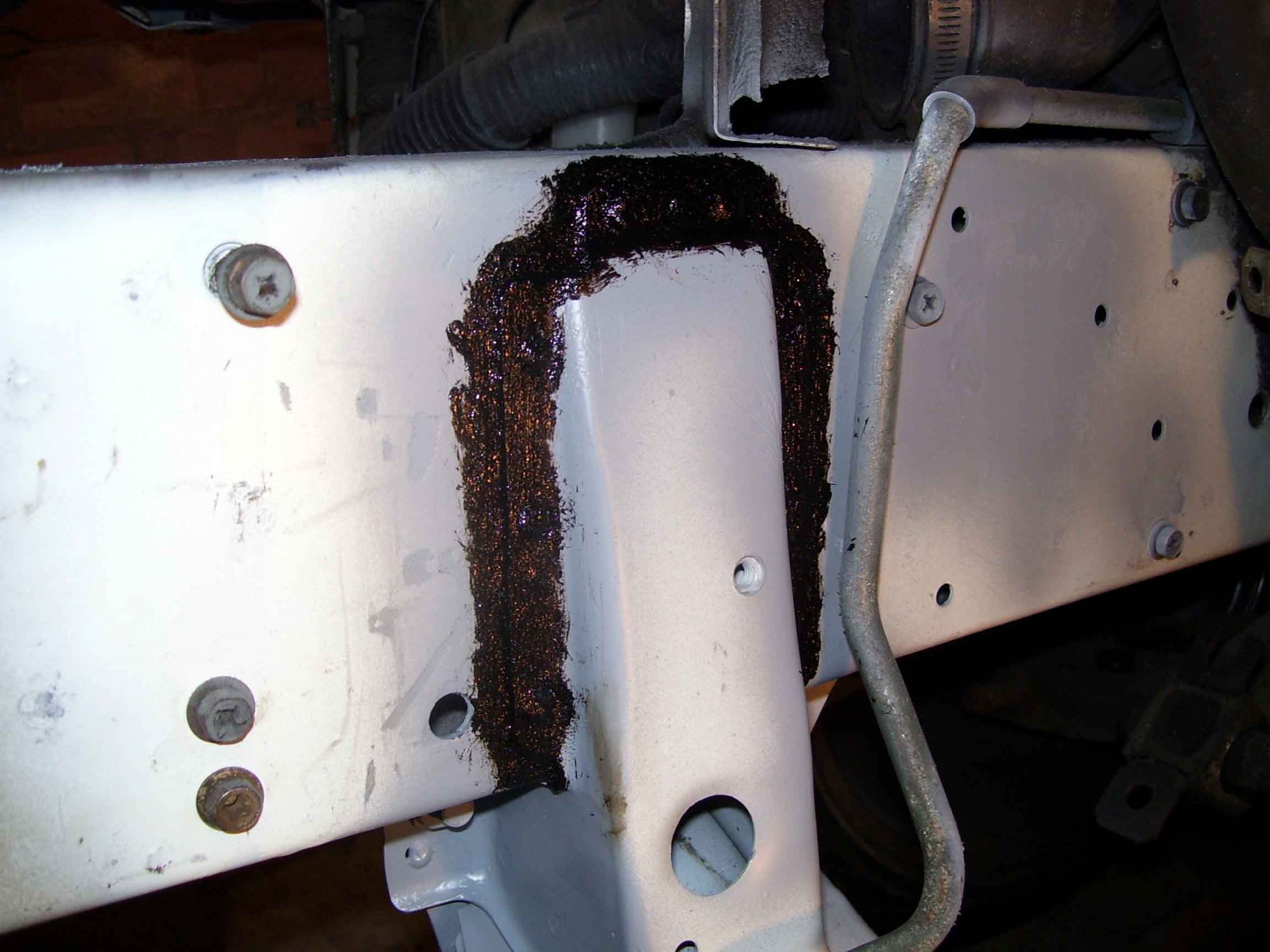

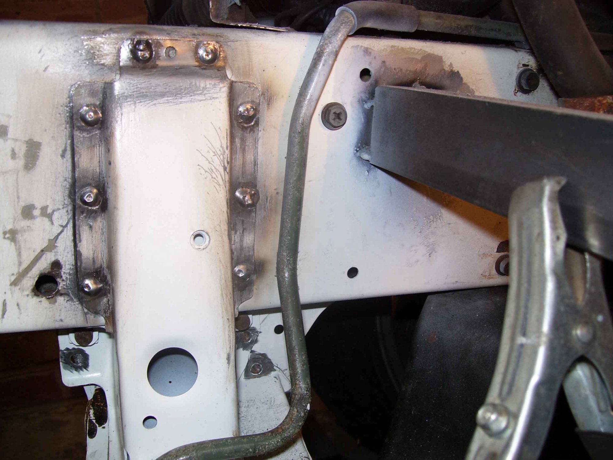

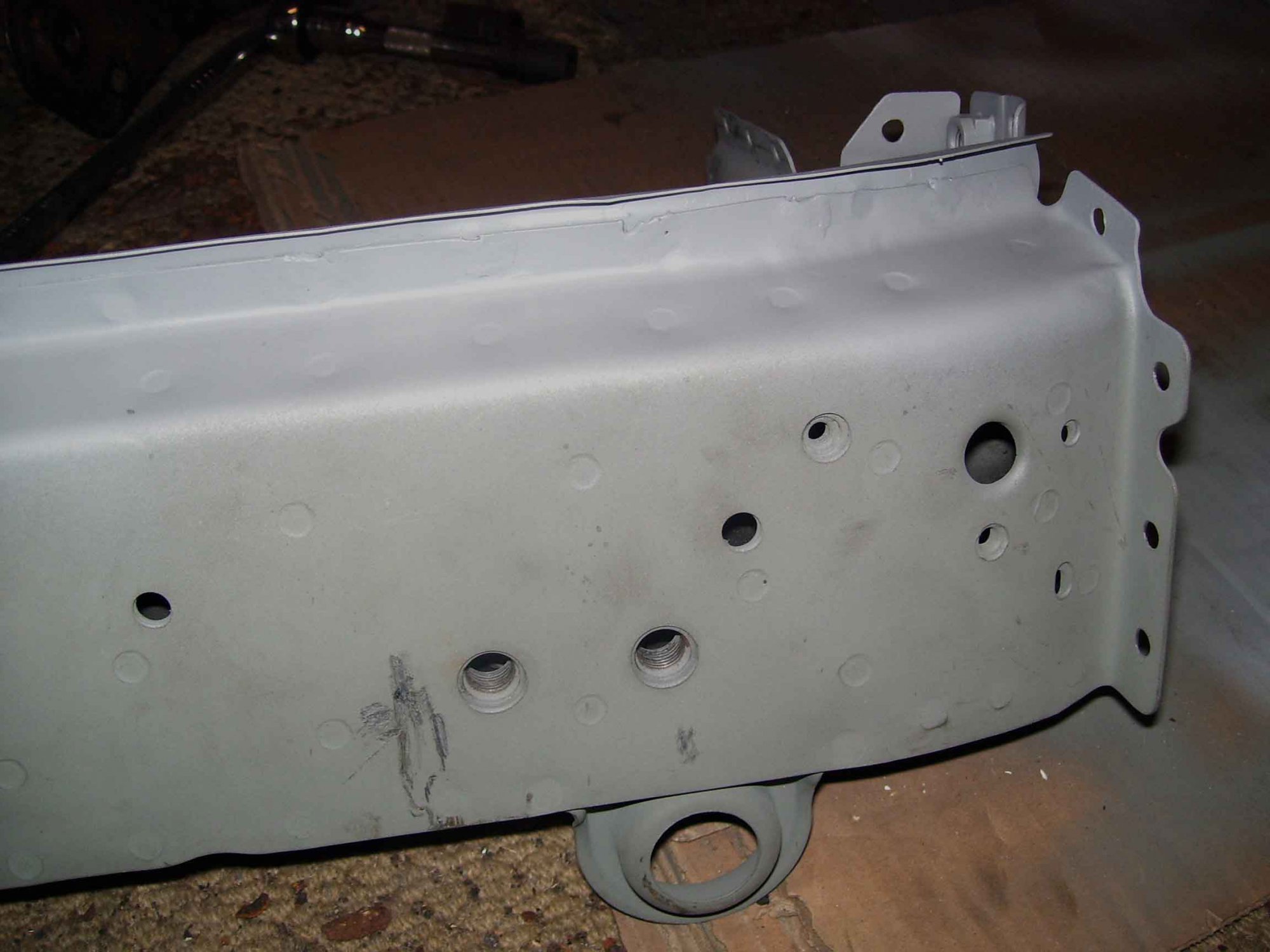

I'm not an expert but to me, your welds 6, 7, 8 seem better than original spot welds in strength and quality, look tidy to me, and you're getting a similar diameter of penetration on the back with nice even HAZ.

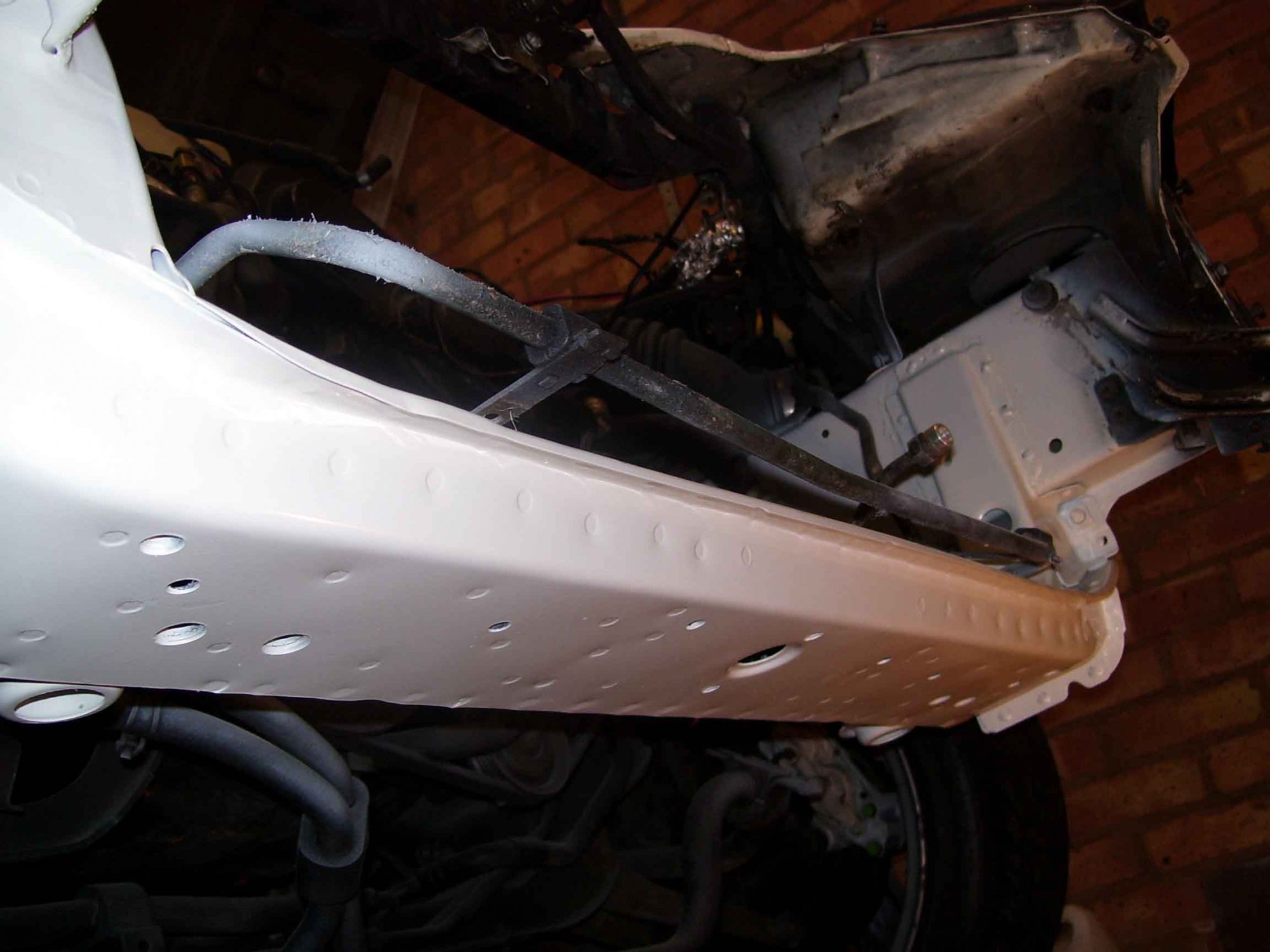

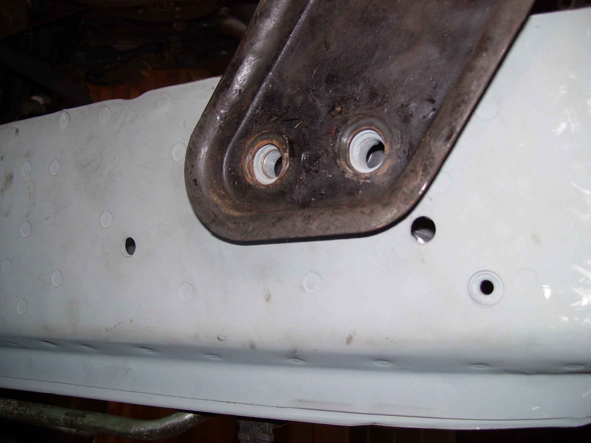

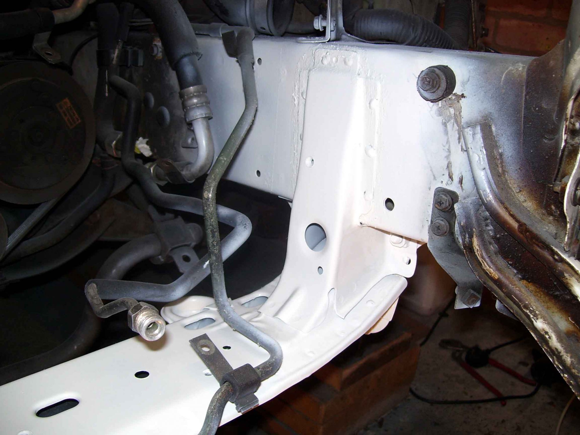

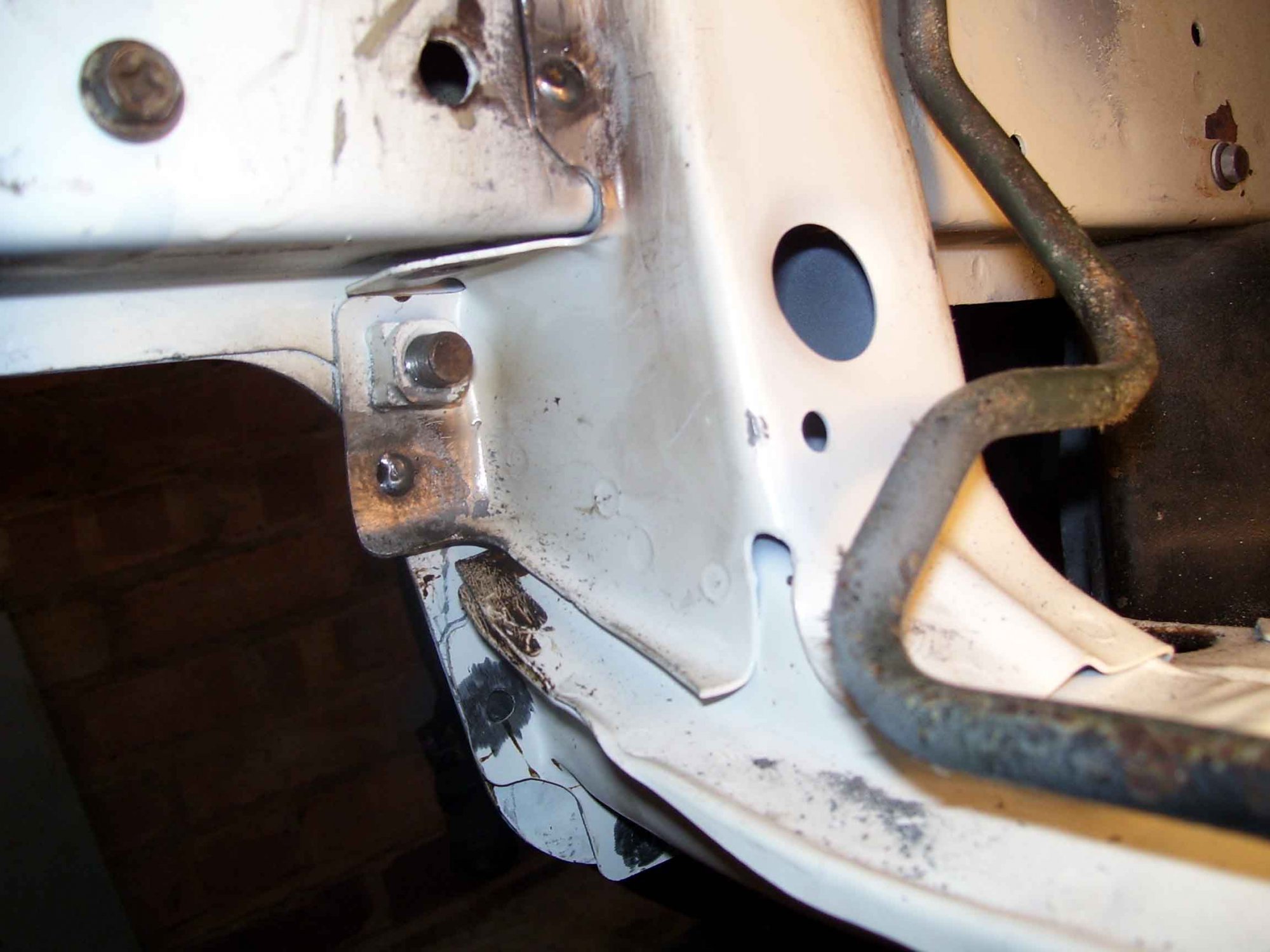

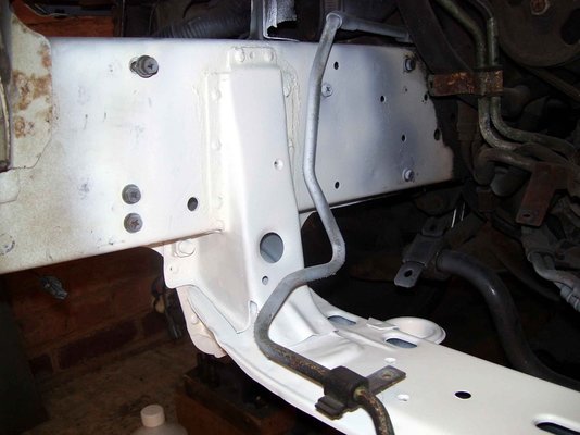

Why not just drill and blitz those failed OE welds on the new subframe in the same way - bound to be an improvement?
I'm really impressed by all the work evident in drilling out dozens of spot welds and getting everything to fit just so.
