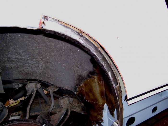

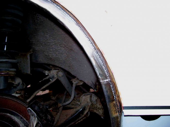

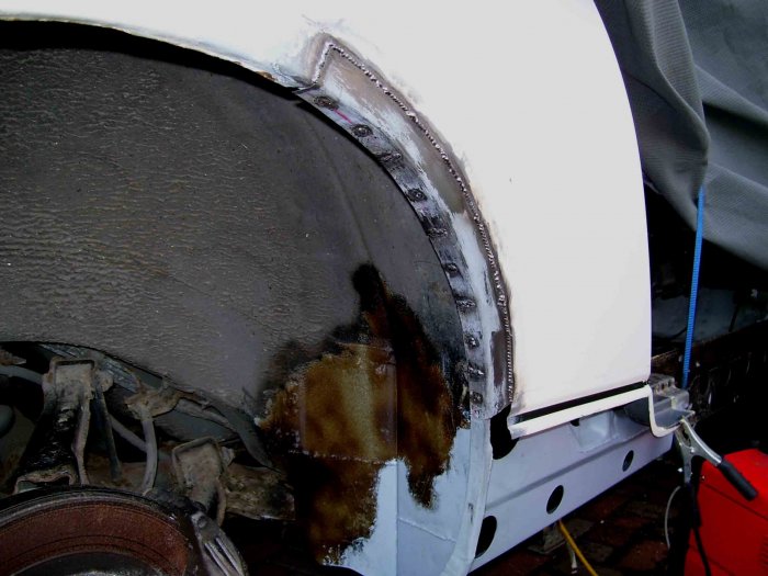

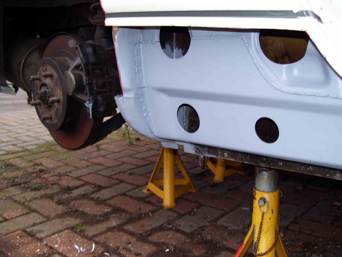

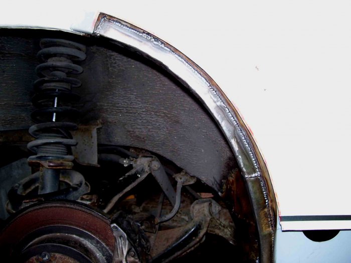

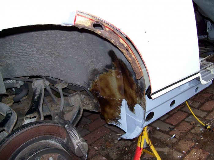

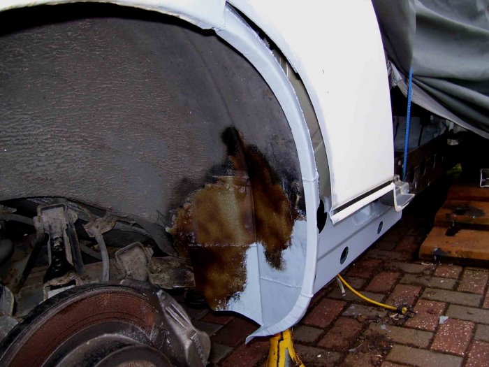

More cutting and shaping than welding today, Managed to get a bit of inner wheelarch welded in though. This will let me weld in the outer sill return on to good metal, which in turn will allow me to fit and weld front outer sill. One thing that concerns me is the sound deadening on the inside of the outer rear wheelarch, I am worried that when I close up with the last patch that it may catch fire. What would you guy's advise?
hi redwine300, your cutting and shaping is out standing you say you've only bin doing it for 6 months there is some well tidy work there mate, well i started work on the land rover done some welding on the back wheal arch i just couldn't shape the new metal so i just put a patch over and it's not to bad the local garage said it will pass a m.o.t so that give me some confidences so this weekend i done some on the floor by the back door by the end of Saturday i wished i never started the thing effaced i wished i never got a f*@*?*g welder. then i sat and looked at your work again and got down to the message you replied to me and at the bottom you said ( Good luck with the Discovery by the way and remember, just as you think you wish you hadn't started don't give up it will come) so with that i went out on the Sunday after the snow had gone and tried again was there for 2 hours and got more dun than i did on the hole of Saturday and it was well nice. i will get some pics up soon. but thanks for that cos thats what gave me a extra push. i use this car every day for work so can only do a bit at a time. keep up the good work it looks spot on
sometimes you can cheat. put some cuts in where bends and dips need to be. weld the rear edges then start tapping the metal into shape, form as you go.

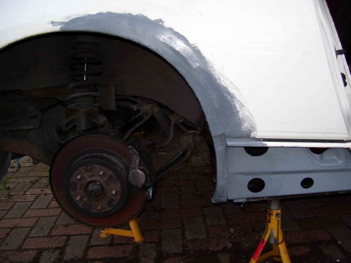

Well managed to get a bit more done today, Tried the tip from autocare reference the cutting before bending etc' worked a treat. Helped me shape a bigger section of the wheelarch. By the way colinyr77, have you managed to take any photos yet? I would be interested in seeing how you are getting on. I have posted some pictures of my progress today

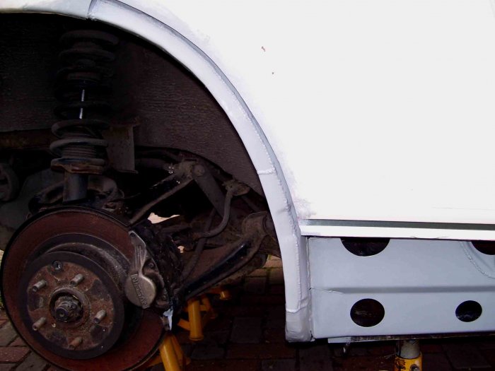

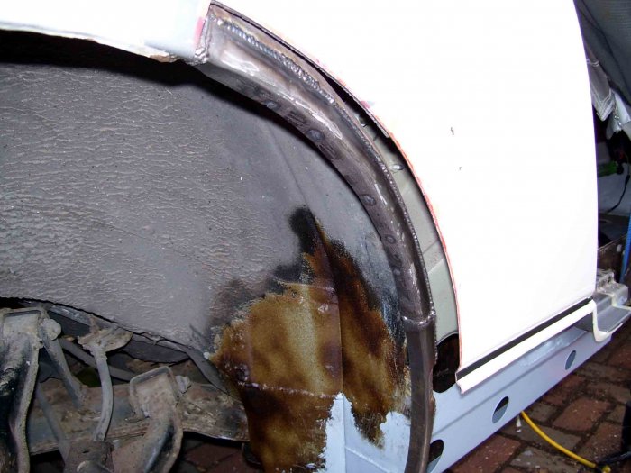

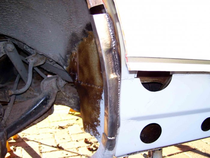

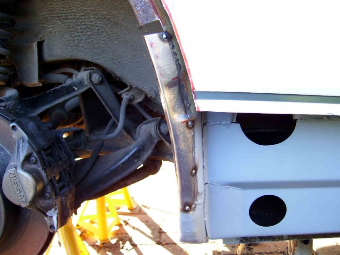

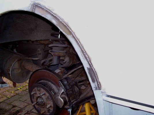

Roll on the summer, I hope to have the Nissan on the road by then. Managed to fabricate and weld into position outer wheel arch repair today. No matter what I did I still ended up with slight panel distortion. Would someone take a look and describe just how I should have approached it so as to avoid distortion in the future please. I must be missing something.
It doesn't look that bad from the photos. Can you not just grind down the welds and skim with filler???

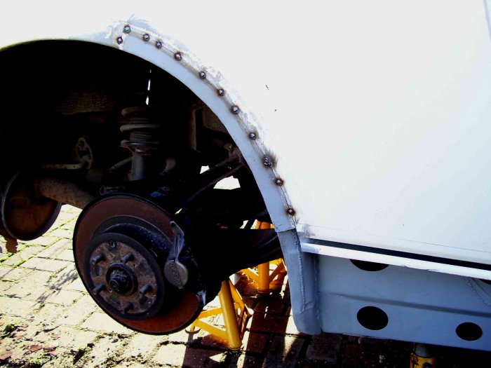

An approach to lessen distortion would be to put a swage (or joddle) in the repair section, punch holes in the rear 1/4 panel and join with plug welds and a small overlap. Then fill the outside before painting, seam seal, paint and wax protect the inside, though, the overlap being inside the car and being in a dry part of the car, it should not rust from this point.

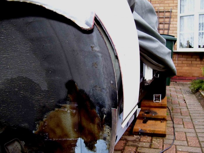

Problem there is my photographic skills leave a lot to be desired and with the colour being white it just comes out to bright. I have looked at it, as you say with regards to filling and sanding back. Fortunately the distortion has gone in wards, so if I build up with filler as you say and use a large flat sanding block I should get away with it. Spent all day fettling and shaping outer rear sill section ready to weld in to position, this is why I really need some advice so as not to mess it up. Must me about 1 meter in length of weld. Should I space my tacks at 30mm intervals and start from the middle and work my way to either end equally? Any other tips would be welcome.
How did you weld the section in after tacking it?? Was it from one end to another?? To minimise distortion you should weld between the tacks, alternating to different areas of the repair, allowing time to cool, so the heat does not build up in any one spot.
I welded with a alternating pattern as you say but I think my impatience gets the better of me. I probably welded the latest piece complete in less than ten minutes, Perhaps a little to quick?? Another thing I would like to ask, am I making my joints to close, therefore not allowing any room for the weld to shrink back causing interference? I have watched various programs on TV and thought there gaps were just poor workmanship but perhaps it's just the opposite? Gaps are there by design?

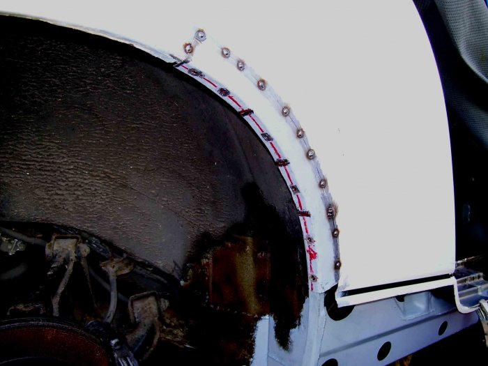

You're going to have to skim with filler before painting, lucky the distortion was inwards! As I said above, to minimise distortion on a visible section like that, I would joddle the repair section, punch holes every 1"- 1/2" in the rear 1/4 and plug weld the two together with a 1cm overlap. If the two pieces were held together tightly at the overlap, by, for example self tapping screws or self drilling screws, then there should be less distortion and less to fill.
I have done this kind of repair on the bottom of doorskins.
Not sure about the gap and distortion. Flatish panels tend to distort when welded, it is having structure that holds things in shape. have a look at the wheel arch repair on this site http://www.mig-welding.co.uk/wheelarch.htm, malcolm used an overlap.
I don't very often do an overlap, but sometimes it is better if distortion is going to be a problem, and you can use weld through primer on both pieces so the inside of the overlap is painted as well to minimise the chance of rust developing there.
Cheers Chickenjohn, Thanks for the link, I think I understand what's been done there. Also a couple of useful tips there with reference to self tappers etc' Again, thank's
