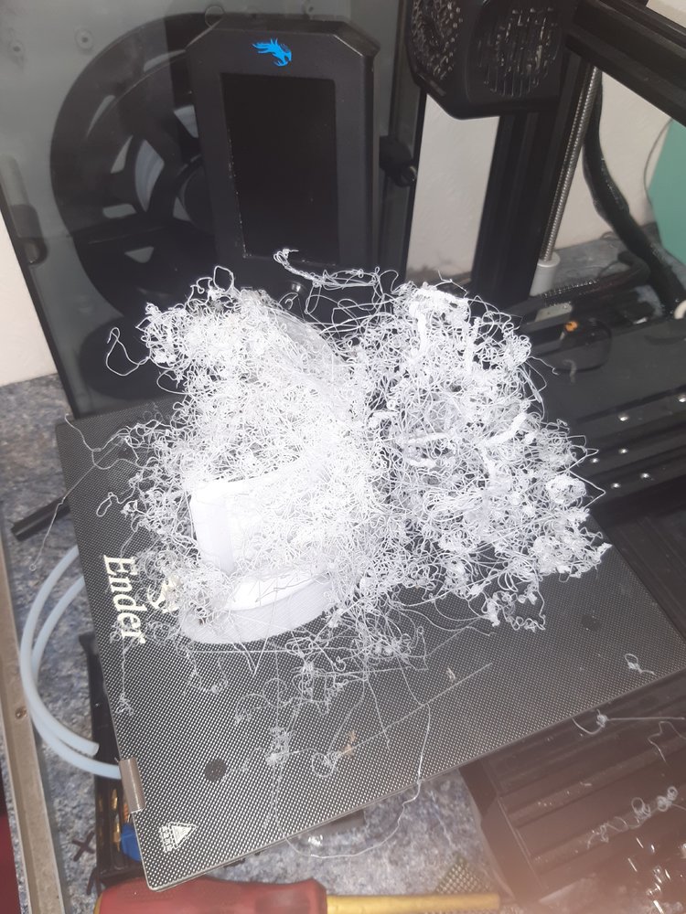

Woke up this morning to a birds nest
Looks like the nozzle came loose or wasn't tight in the first place.. I had recently fitted a direct extruder bracket and things were working well
Think maybe the short piece of ptfe was a fraction too short

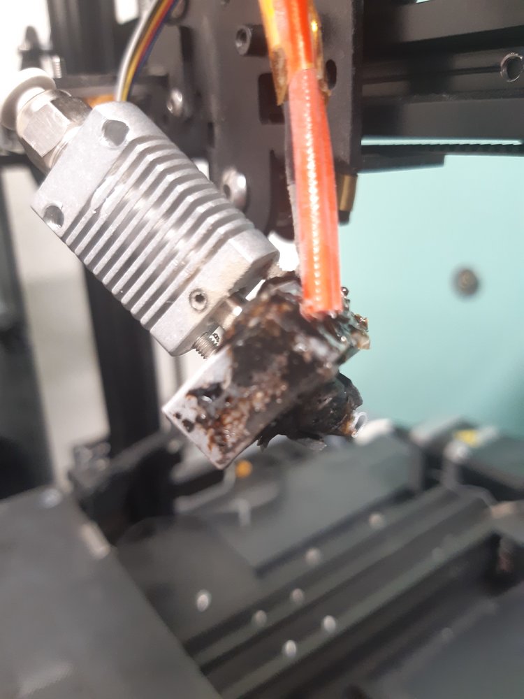

Manage to clean up the hot end.. Will want a tap m6 by 1? ? To clean the threads

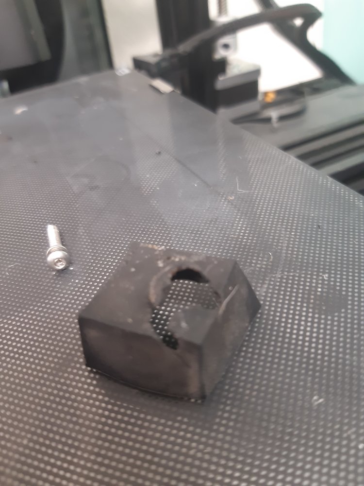

It's out of action till I get a new silicon heat shield as it tore comming off
