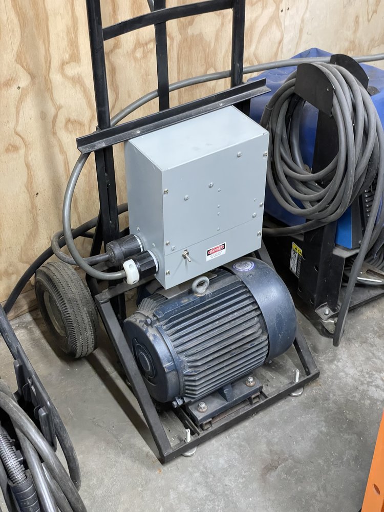

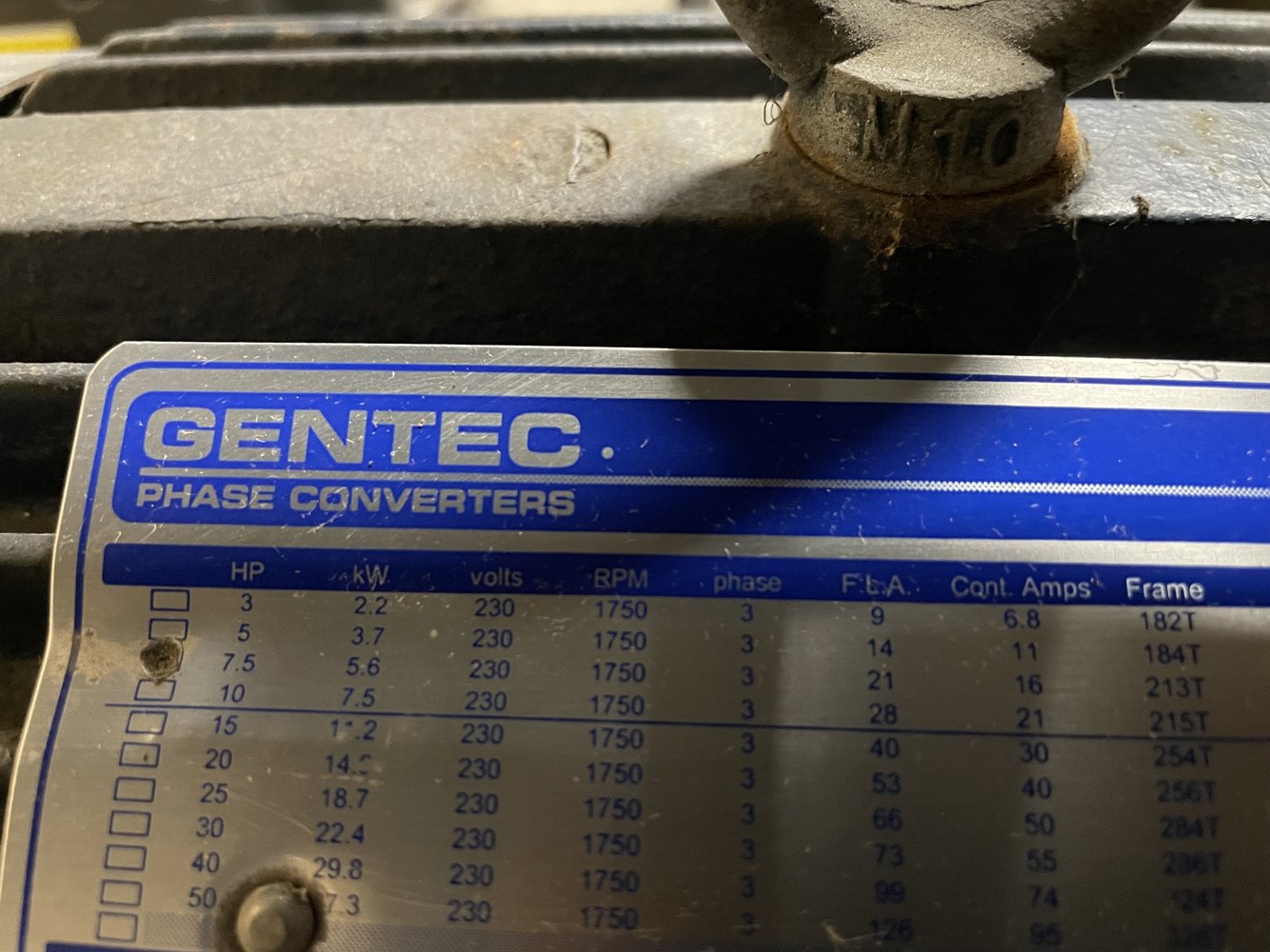

I set up a 220-240V rotary 3-phase converter about 17 or 18 years ago. I don't remember where I got the components, but as I recall, the idler control circuitry was preassembled and installed in the steel box. I seem to remember wiring up the receptacles, switch, mains cord, and idler connections. It uses a 7.5 hp Leeson/Gentec idler, with no external shaft. I wanted the converter to be portable, but have a steady base, so I modified a hand truck to accommodate it. It's still working fine and runs my mill and lathe smoothly. I wish I could give you more specific information, but it's been quite a while since I set it up. I do remember that I saved a fair amount of cash by buying separate components and doing the rest of the work myself. I might still have the instruction manual around someplace....be glad of some ideas please.......I have only limited knowledge of this kinda thing....Ta
