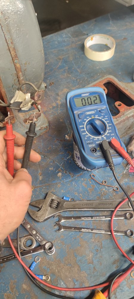

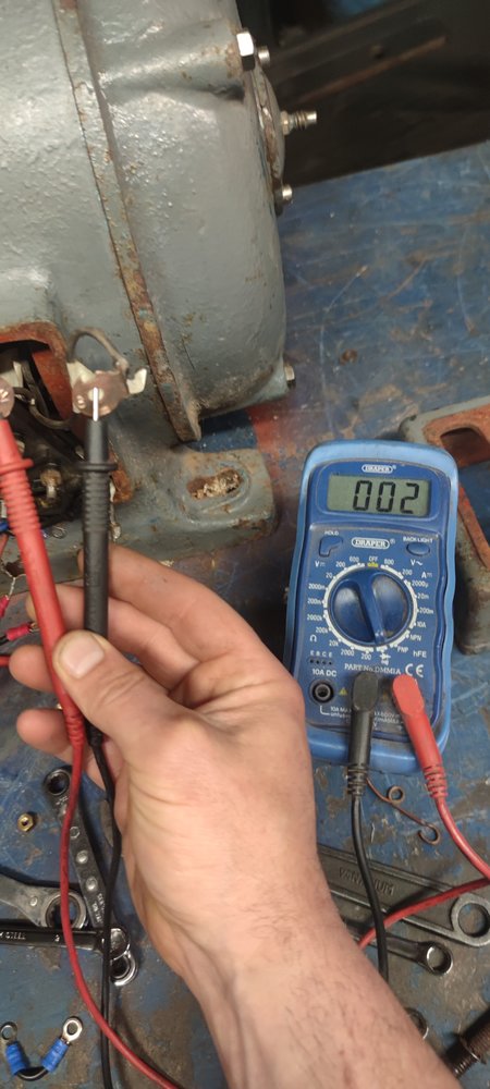

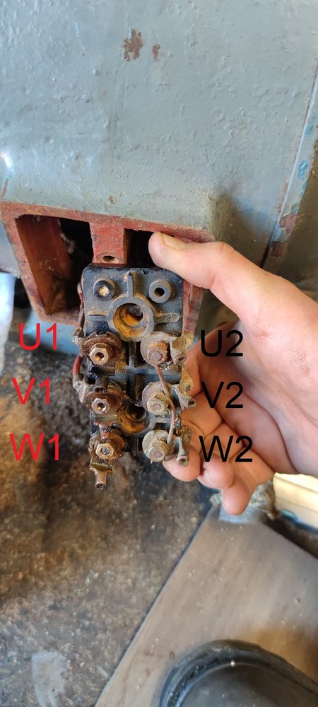

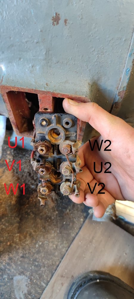

I did not take a photo and was typing a lengthy reply of how I am SURE I connected it up correctly explaining what I have done.Could you show us a picture of the way you have connected it for running in delta. There might be something subtle that you have missed.
.The block is wired correctly now (second photo) and the motor runs in DELTA.The block is wired correctly. Strapping across each pair should have worked.
Is the labelling taken from the wires or from the block? Or, are you assuming that the wiring plate information is as they are presented?
