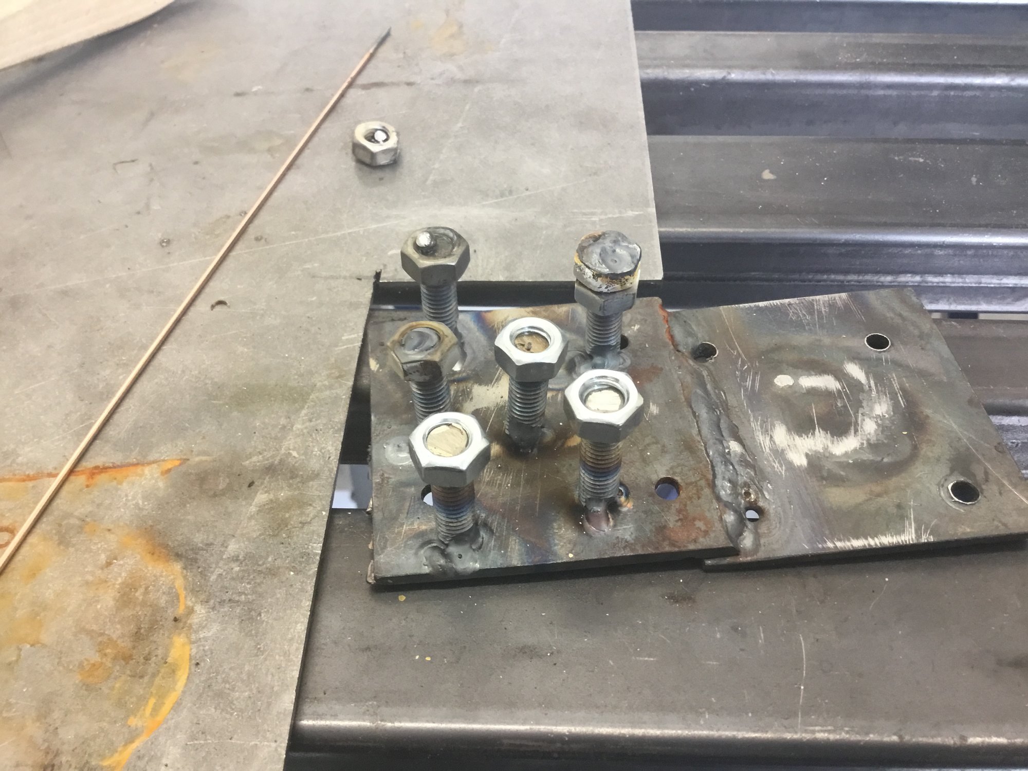

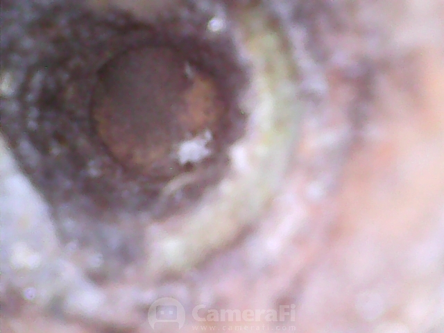

I thought about how to gather experience for the TIG welding approach. Here is my test scenario:
I bought a threaded rod M8 (imperial sizes are hard to get - at least in a hardware shop here in Germany) along with suitable nuts. I cut the rod in small peaces, welded it on a plate an bolted nuts on them, so that there is a recession left. Then I began to weld a tower on the rod so that I was finally able to weld a second nut to the tower. If the lower nut is freely movable and the upper can’t be torn off then this should be similar to the situation of the bolt in the cylinder head.
I chose a 2.4 Tungsten and around 100A short bursts and it worked (upper right) ... I can’t simulate the rust, of course. However, what do you think?

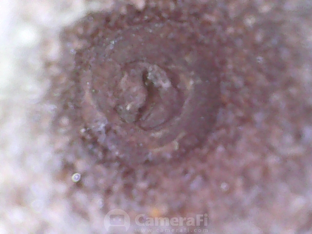

I have got no better resolution at the moment.
