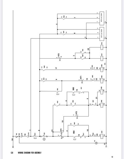

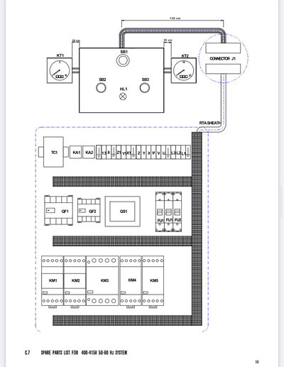

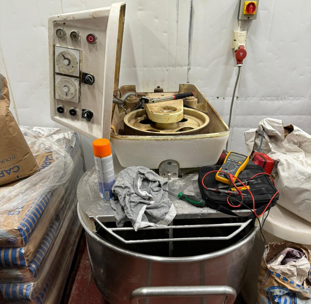

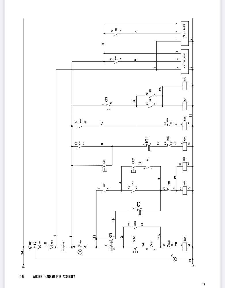

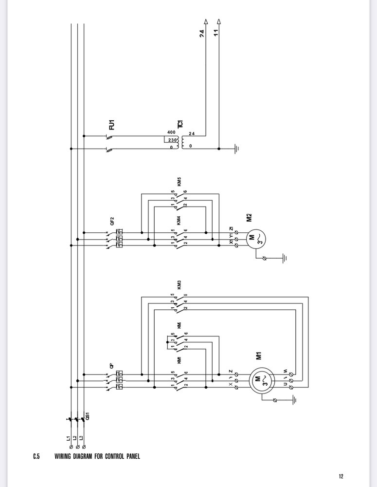

I have a few customers now with machines from the 90s that used mechanical timers.
They have failed, used to be able to send them to a company up north, now they've been taken over by sulzer and they no longer repair them.
Basic operation of the machine is such:
Two speed three phase motor.
Set first timer to say 3 minutes, motor runs at slow speed, after 3 minutes the machine switches over to high speed, where a second timer runs for 12 minutes, after which the machine stops.

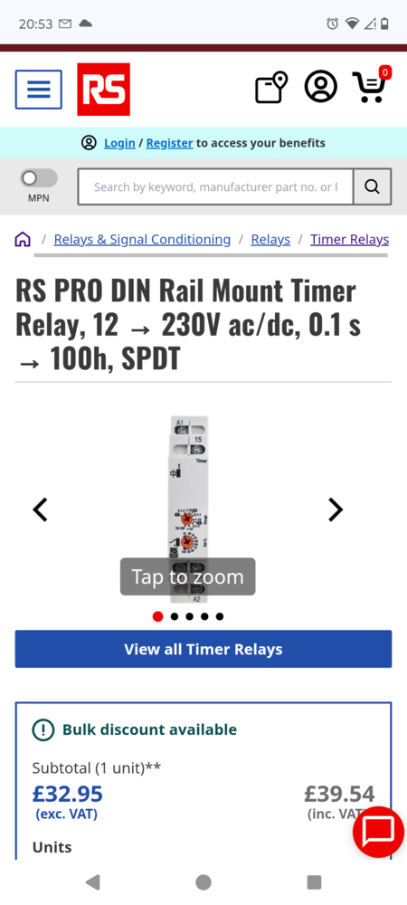

Now i've found these Finder timers which are well within budget.
But i have no idea what ones i would need.
Anyone with experience in such matters?
