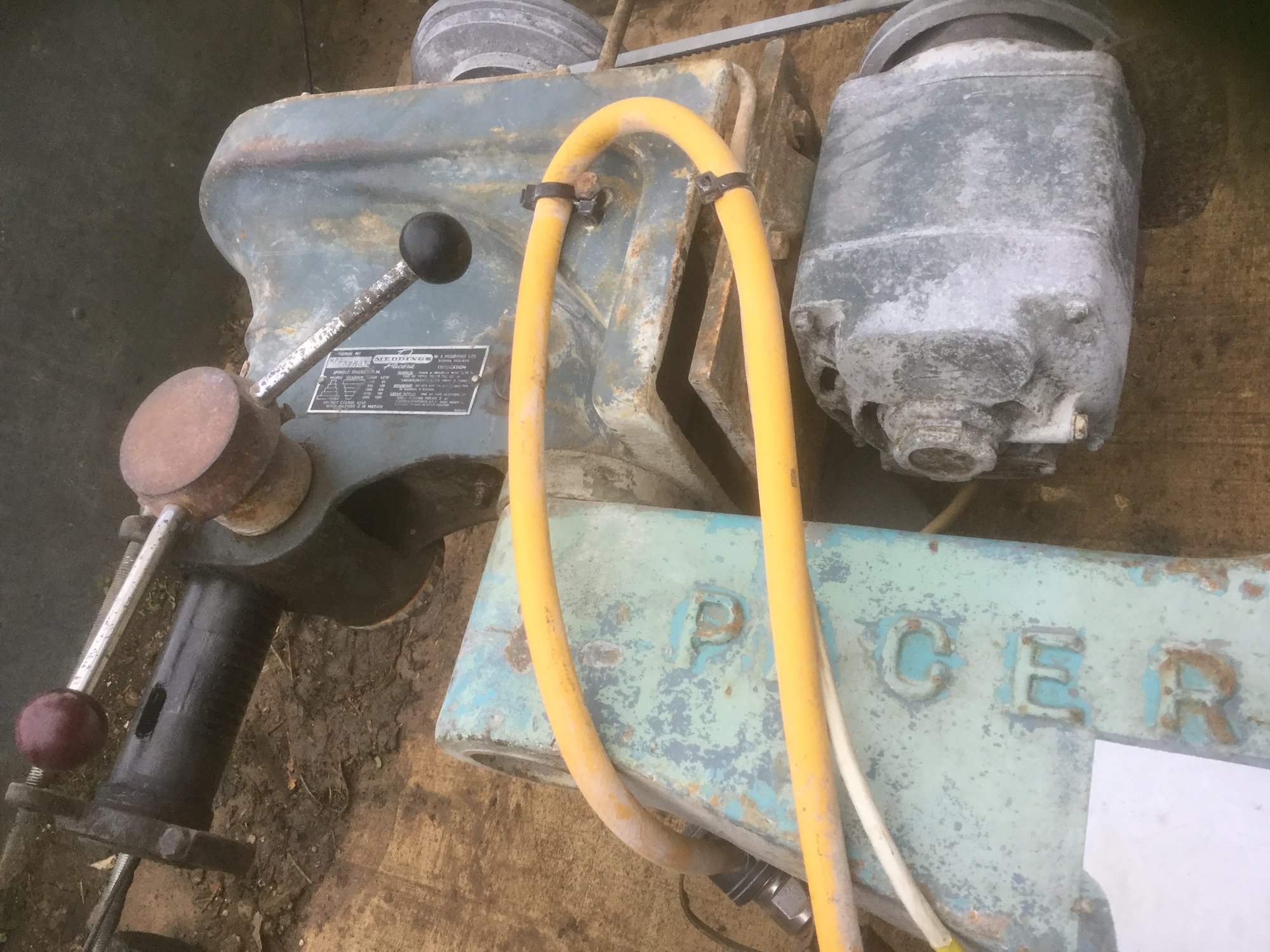

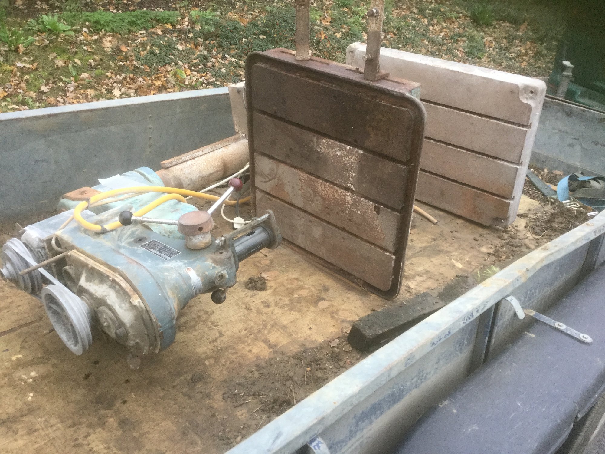

Today I acquired a gurt rusty radial arm drill
Today I acquired a gurt rusty radial arm drill]

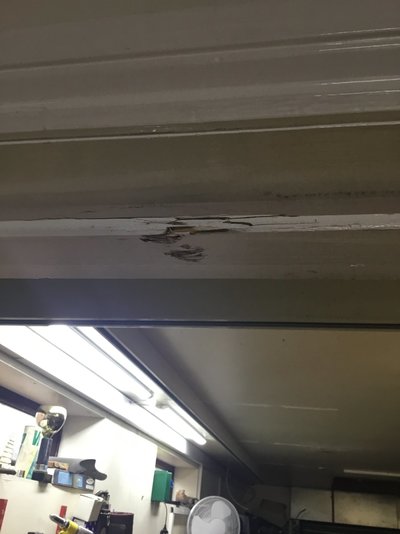

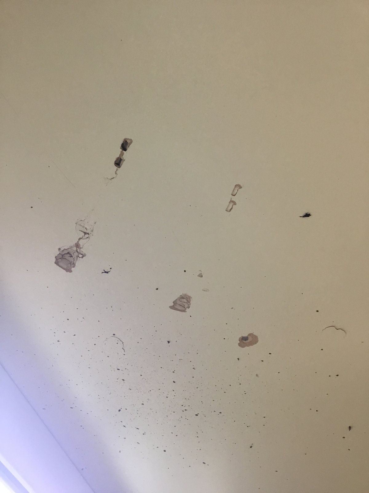

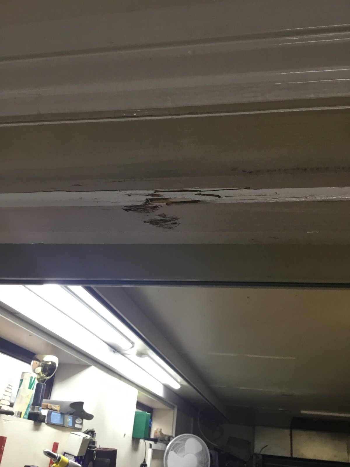

If you are going to run 10 bar of air through the alkathene pipe if you blow off a fitting your free end is going to whip about like crazy if it's not restrained. I'd suggest extra restraining clips near to any connections.

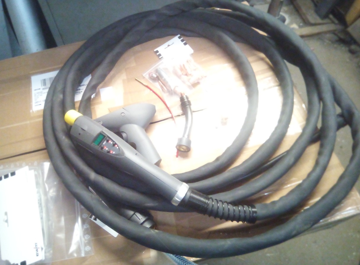

Looks like an expensive acquisition! Guessing it's water cooled too?Today I acquired this, not had much of a chance to mess with it but did do a few welds to test it out.
For a moment I thought that last pic was from the 'Police Squad' TV series, the episode where Frank Drebin is working undercover at a locksmith's - the ceiling was festooned with keys that had punctured the plasterboard.Yup, it will make a mess of what ever it hits. First is the door casing, 2nd is the ceiling in my workshop. Id been stand right next to the fitting moments before it let go. Clean undies required
