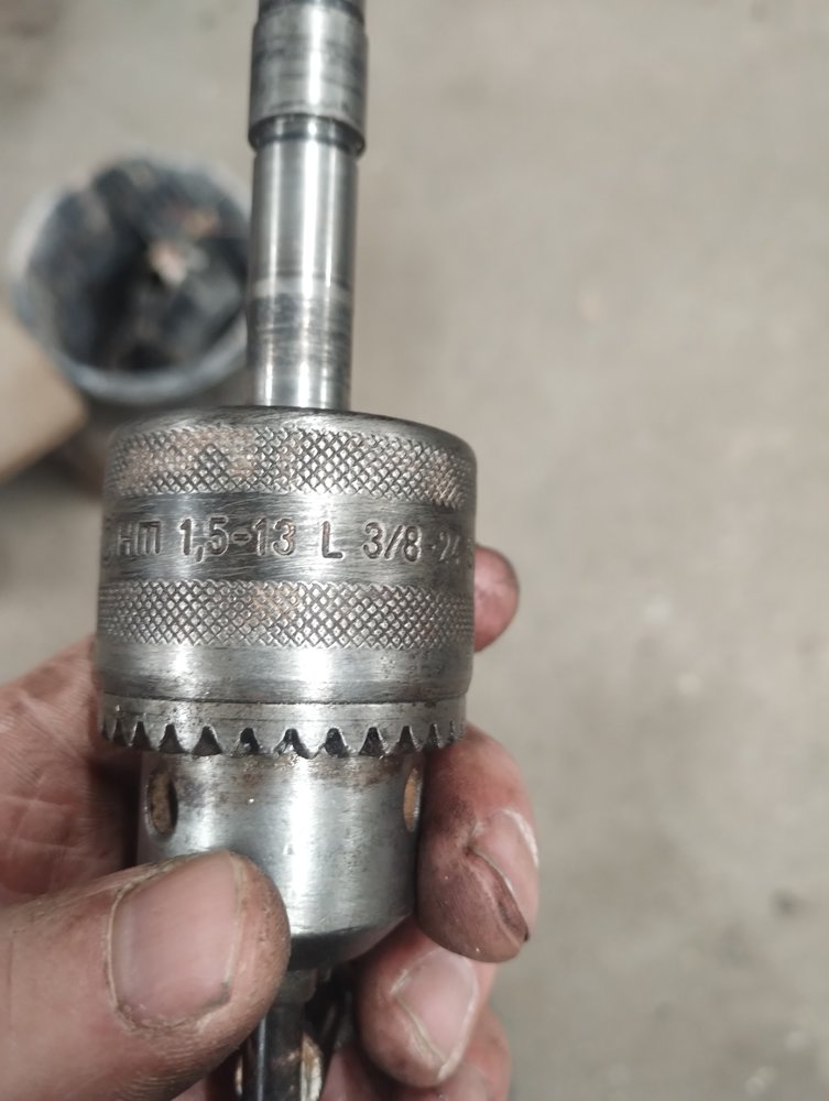

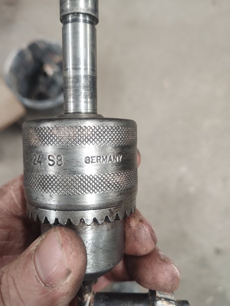

Chuck it in the late and cut a B taper then go shopping for a suitable shankA nice little rohm chuck off an black and decker I killed, whoops. Arbor is threaded into the chuck and did have a "locking" LH thread screw, before I removed it.
Am I right in thinking I can get a different Arbor to get this to fit in the lathe and pillar drill (mt2)?
That's a lot easier said than done. A worthwhile challenge though.Chuck it in the late and cut a B taper then go shopping for a suitable shank

Chuck it in the late and cut a B taper then go shopping for a suitable shwnkA nice little rohm chuck off an black and decker I killed, whoops. Arbor is threaded into the chuck and did have a "locking" LH thread screw, before I removed it.
Really not that hard.That's a lot easier said than done. A worthwhile challenge though.
That's the easier said than done part.using a small boring bar after setting the compound at the correct angle
Plus the fact that the taper isn't given as an angle but as a ratio.That's the easier said than done part.
MT2 to 3/8x24 (unf) thread arborA nice little rohm chuck off an black and decker I killed, whoops. Arbor is threaded into the chuck and did have a "locking" LH thread screw, before I removed it.
