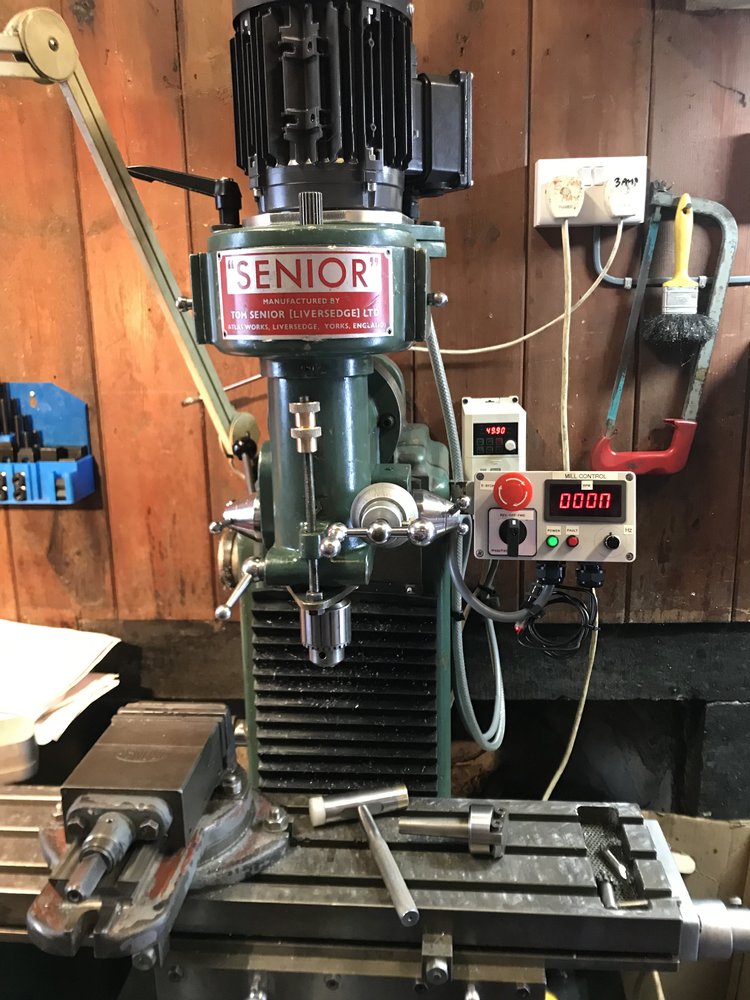

D71its original one
stuck a VFD on it
Nothing special, just remove motor and top cover, drive pulley, then four bolts to remove the motor mount housing. The spindle is fine so I left it at that. The play in the spines is no big deal, just a light knocking when doing interrupted cuts eg fly cutting.Id be interested to see how the head was striped.

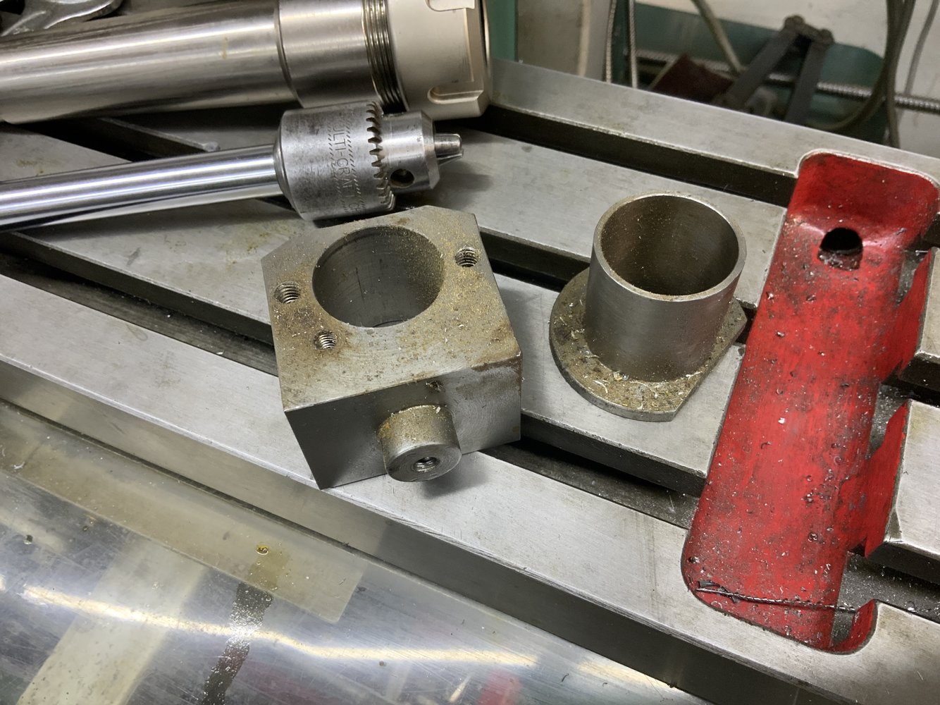

Ballscrew with an antibacklash nut would be cheaper. Ive started the ballscrew holders for both X and Y travel.I had some thoughts about the backlash in the X and Y directions. The screws are more worn in the middle, and I guess there’s some wear in the feed nuts as well. There’s a company in the US (Roton) that supplies Acme LH 5 tpi threaded rod for only about £12 per foot. With this, and a suitable LH thread tap, could I not make up some new feed screws/nuts?

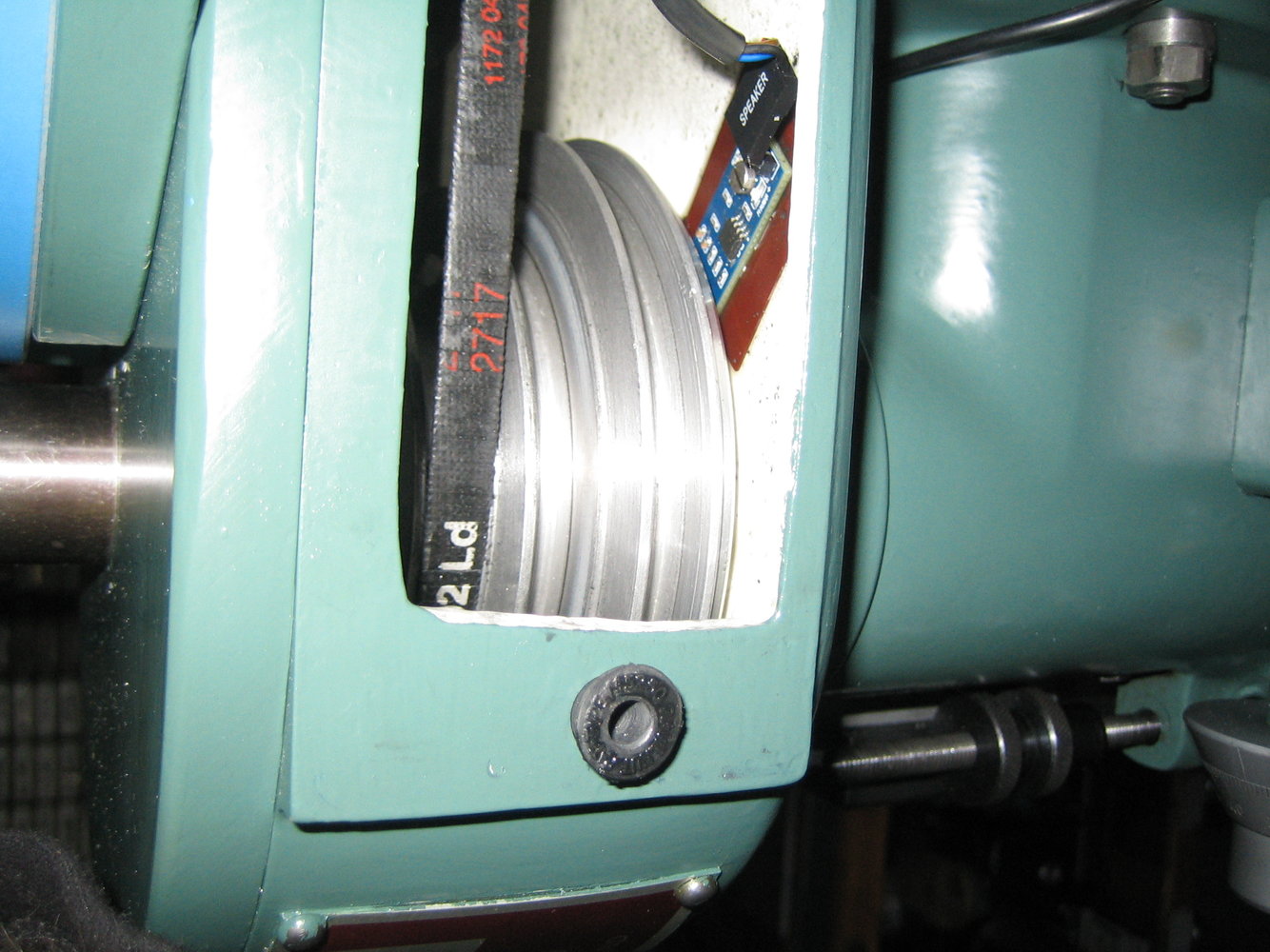

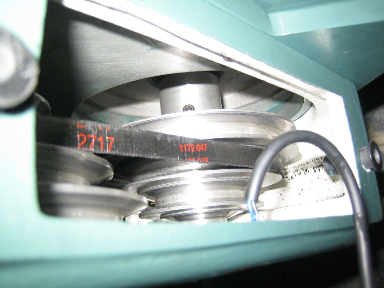

Currently building up a mill control box (rev-off-fwd, e-stop, power and fault lights, rpm meter, speed pot) from an adaptable box and bits. Since the new motor shaft is only 40mm long, and the mount adapter is 10mm thick, I’ve only got a small amount of shaft inside the pulley, which is leading to vibrations if the belt is set to normal tightness. I’ve left it loose for now. The motor shaft has a 6mm thread in the end. Would it be feasible to turn a shaft extension of 19mm diameter, with a similar thread inside, and lock the two together with a length of 6mm studding? Also, I need to mount the RPM sender somehow. Reading a plastic disc, with magnet embedded, mounted on top of the spindle pulley seems feasible. Any other suggestions? |
I did email them, but got no response. Will try again. Do you have a link to what you bought?Hi I brought some Roton Lead screw and it works great. Made a anti -blash nut from a couple of Roton nuts and it works great.
