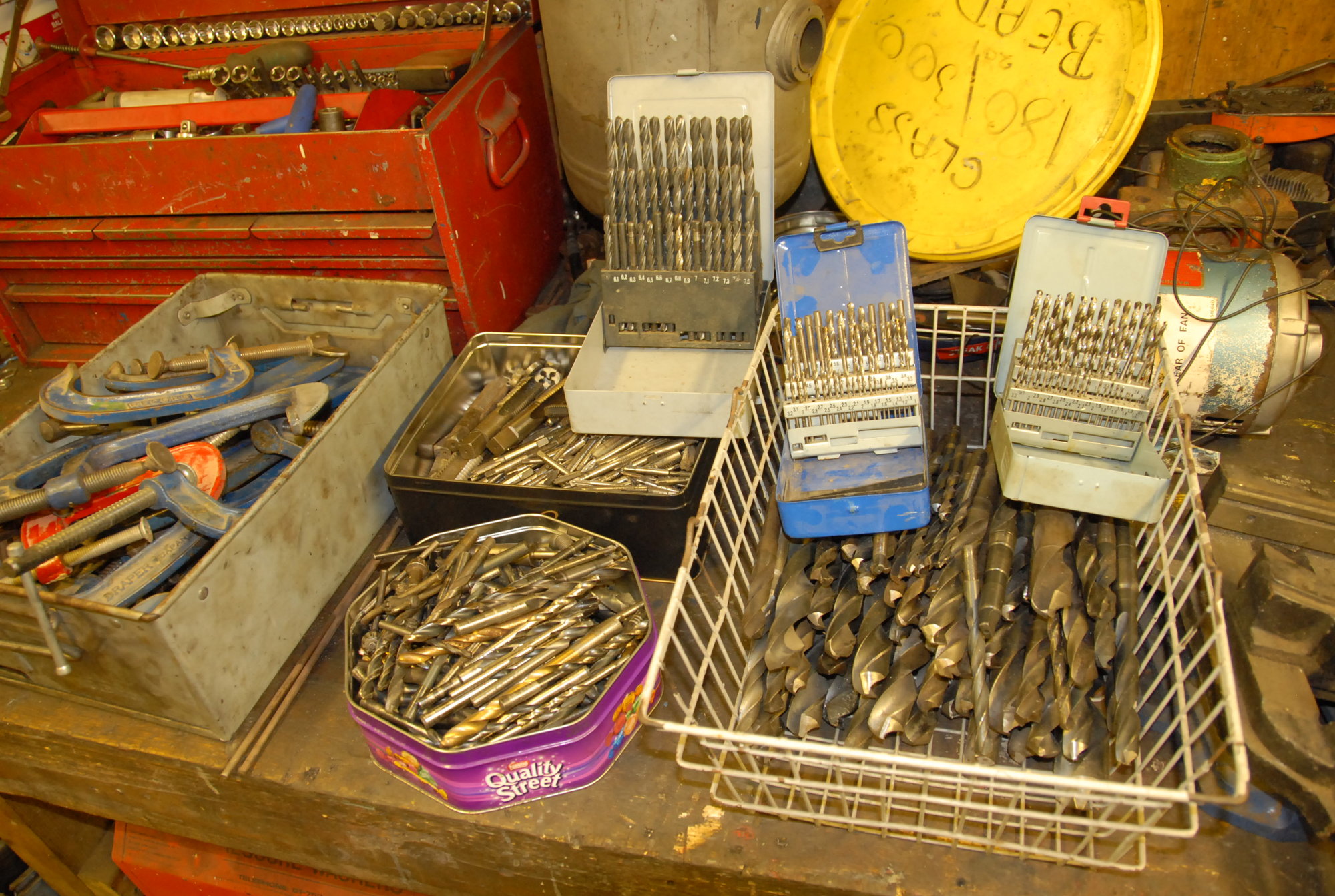

Don’t worry you’re not doing milling at 15000rpm

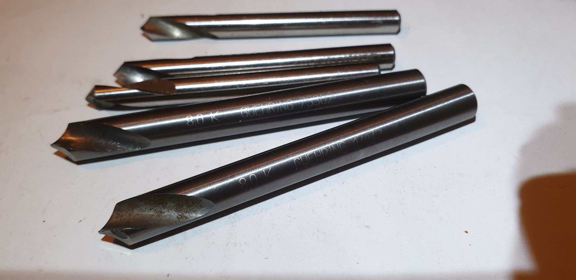

sorted I do feel a numpty sometimesthe holes are for cooling fluid going through them
EH I will have a look around as they may not be ant good as my Kerany trecker dont have fluid in the head, it on the outside.
OMG what a result. I been doing some reaserch on these bits first looked for Guehring bits found them on the Guehring the tool company then found on the net the Mitsubishi SSA drill bits there all carbide drills pretty high end stuff. I will have to definitely blag them off father and only use them for special drilling and milling jobs
Ive down loaded the Mitsubishi SSA drill bit Cutting Condition and I think I have found the drill that will drill those bead roller dies I hardened.

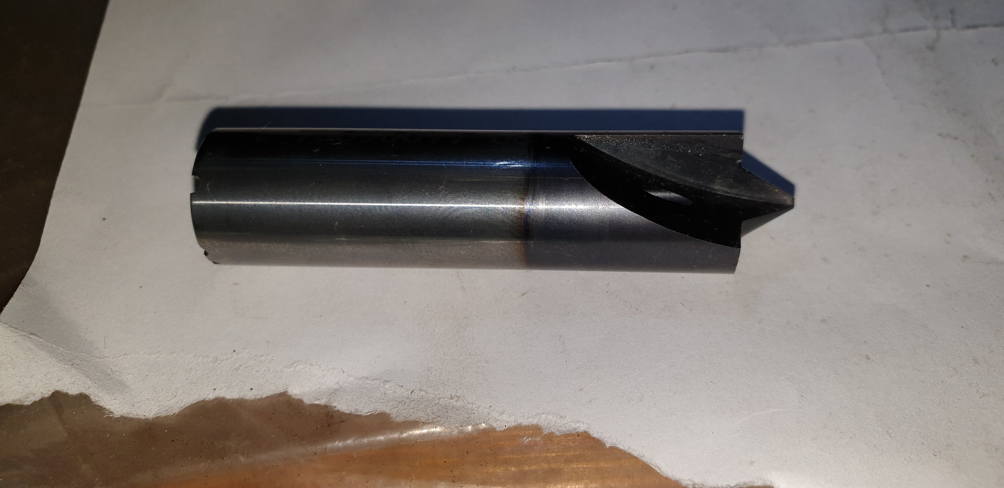

Still looking for this one though is it for milling or drilling
Could be a counterbore, with the cone for locating / piloting in an existing drilled hole - is the cone point sharp, with a relief so it cuts?
Carbide definitely feels and looks different, weighs about twice as much as the same size HSS cutter - almost as heavy as gold, heavier than lead! You'll need the right wheel on your TCG to sharpen it, green grit is OK for roughing but won't produce a good edge (more chipped into shape than ground)!

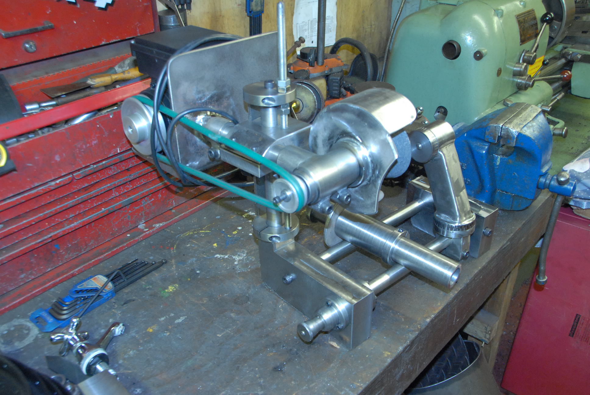

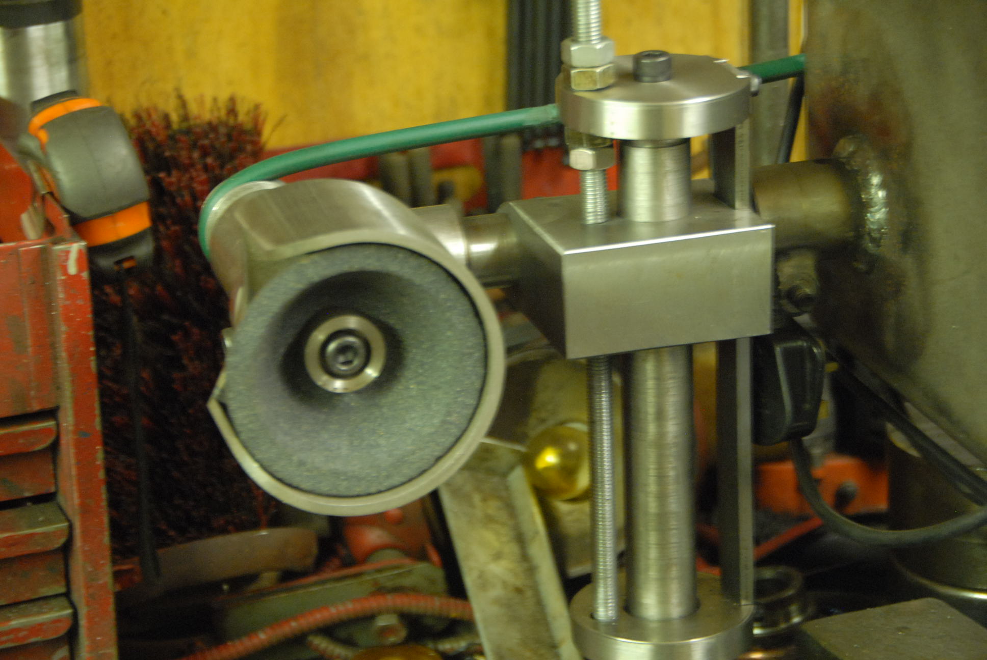

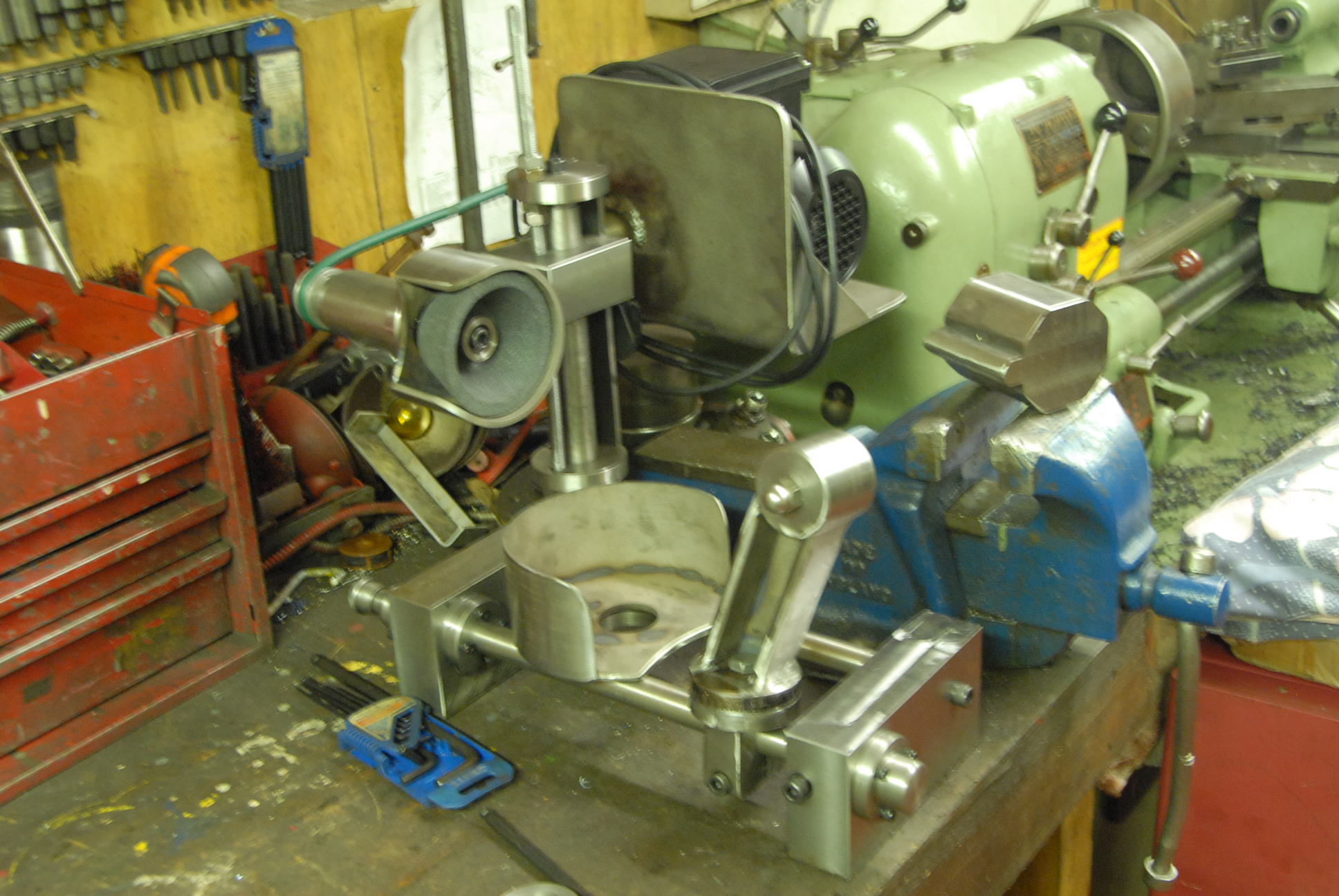

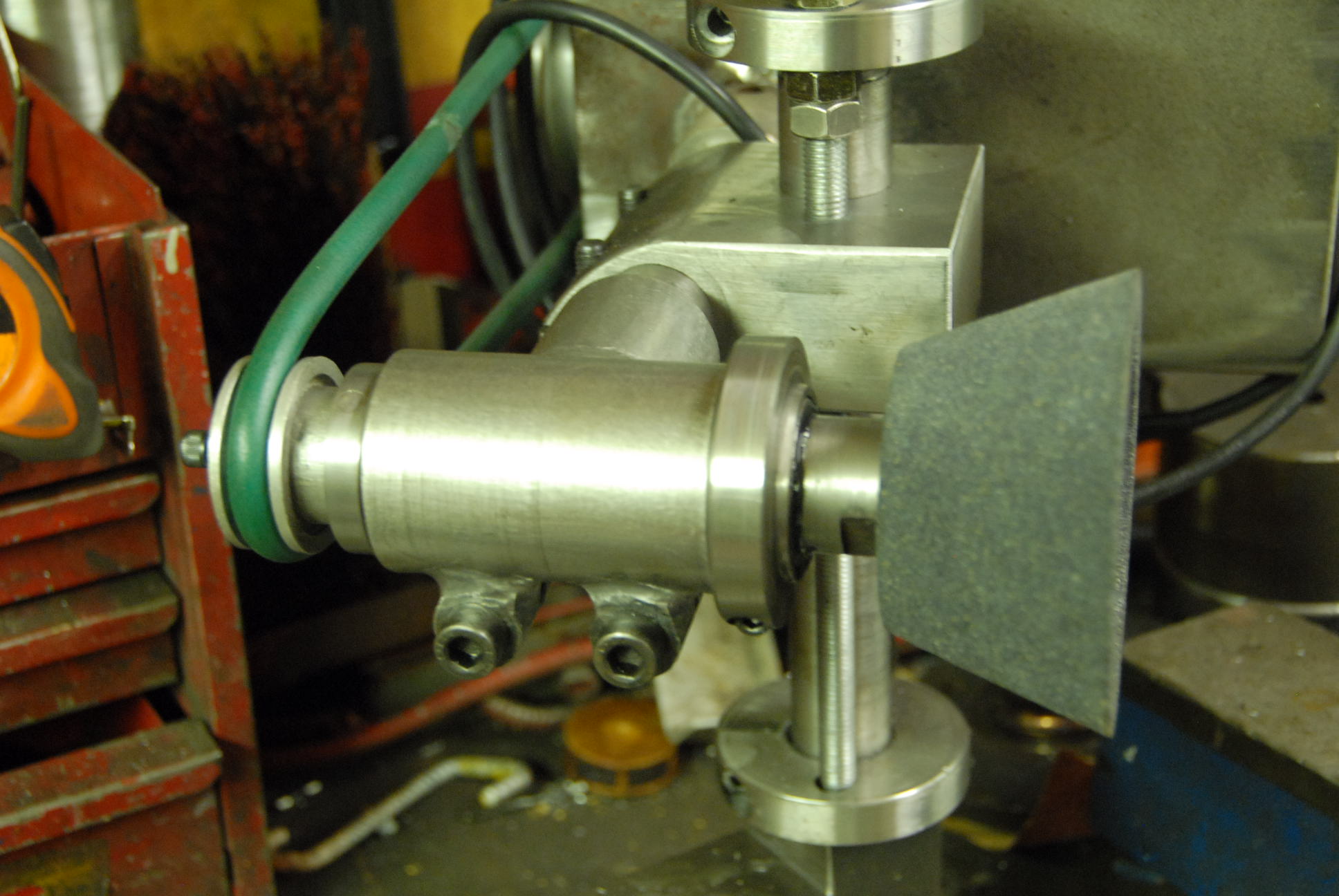

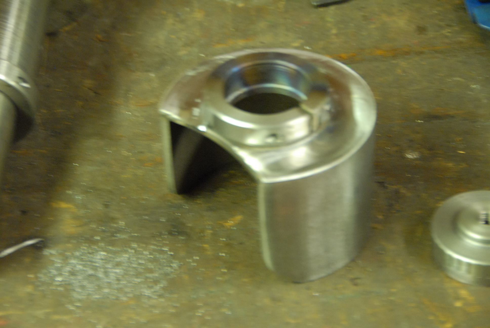

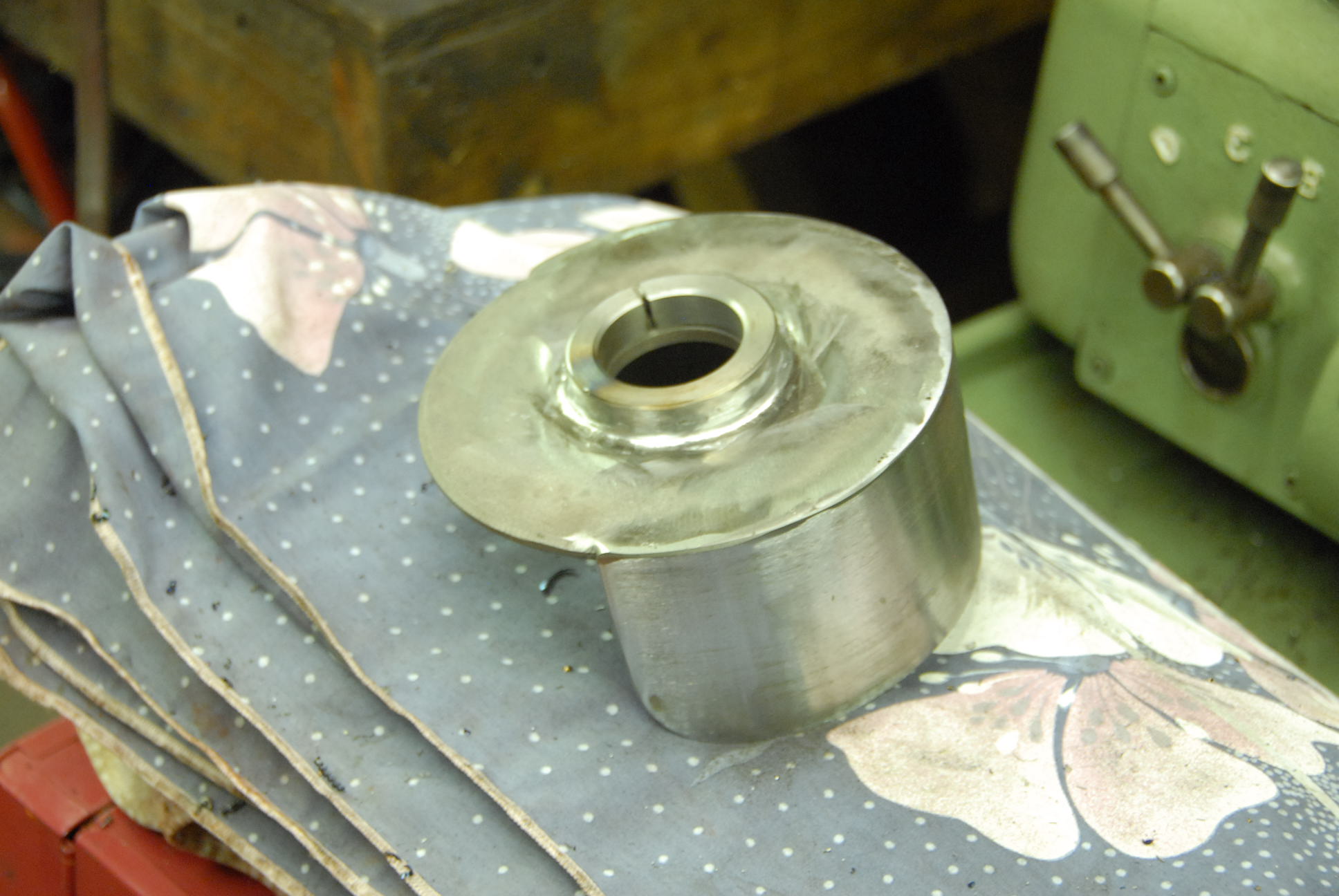

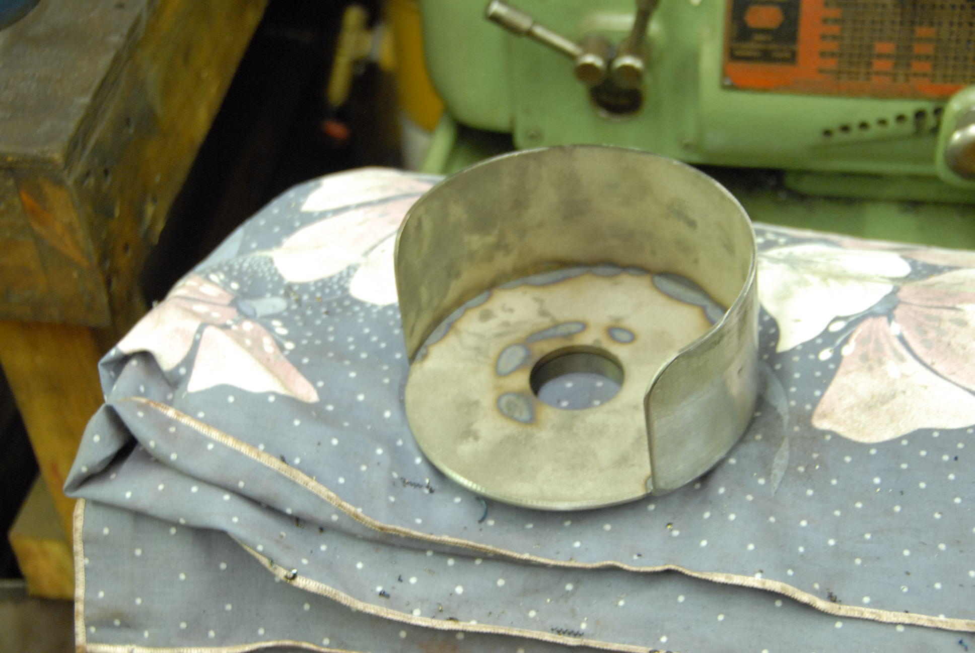

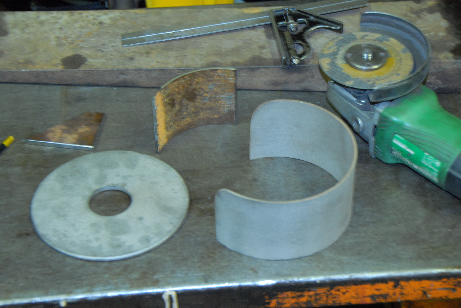

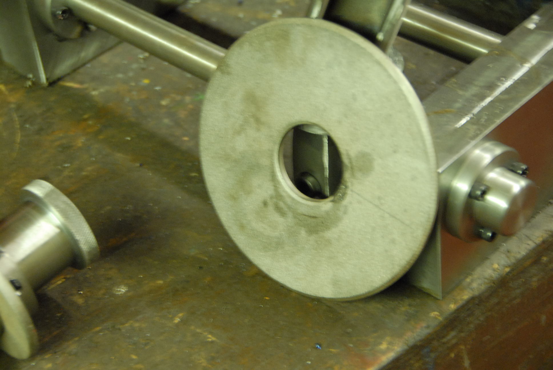

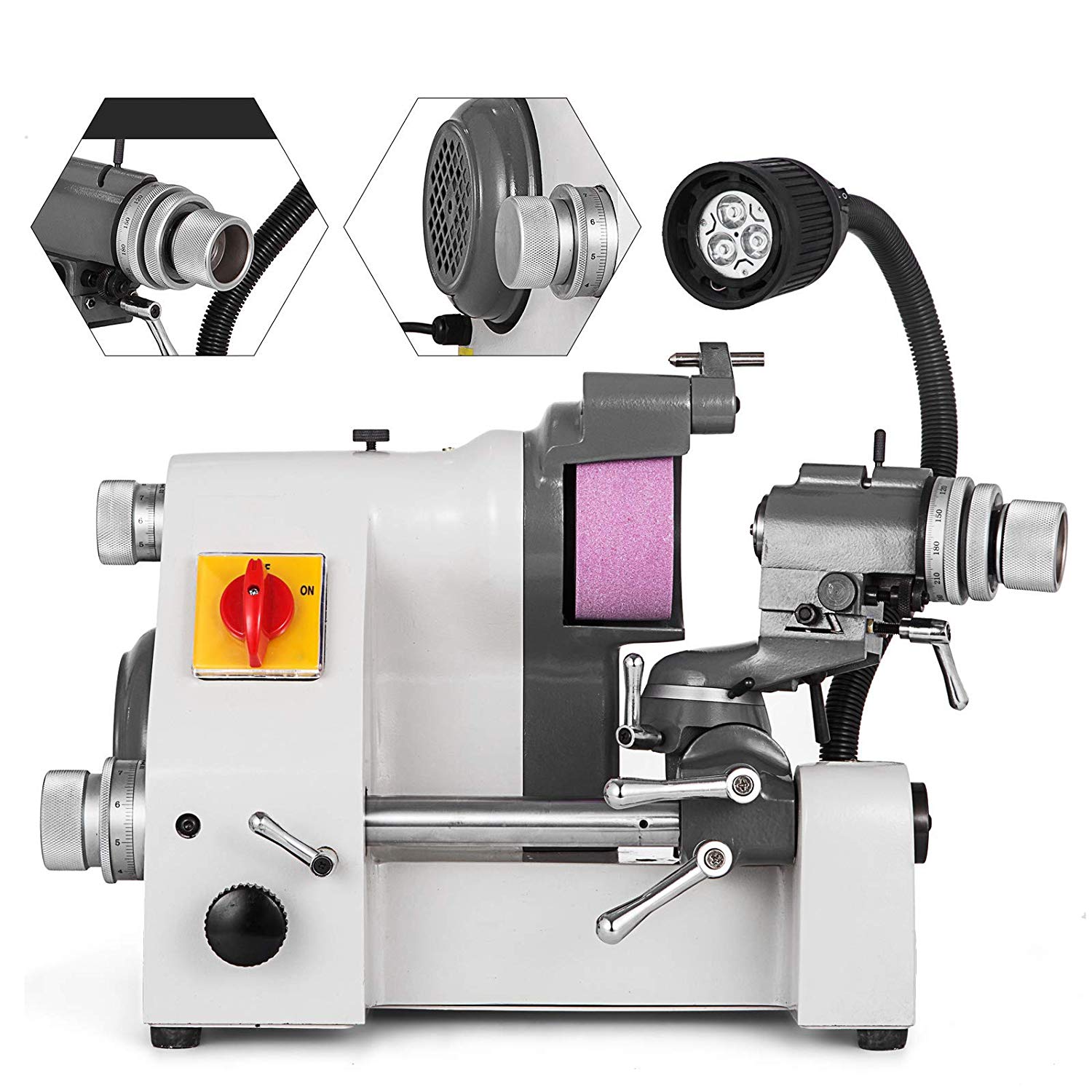

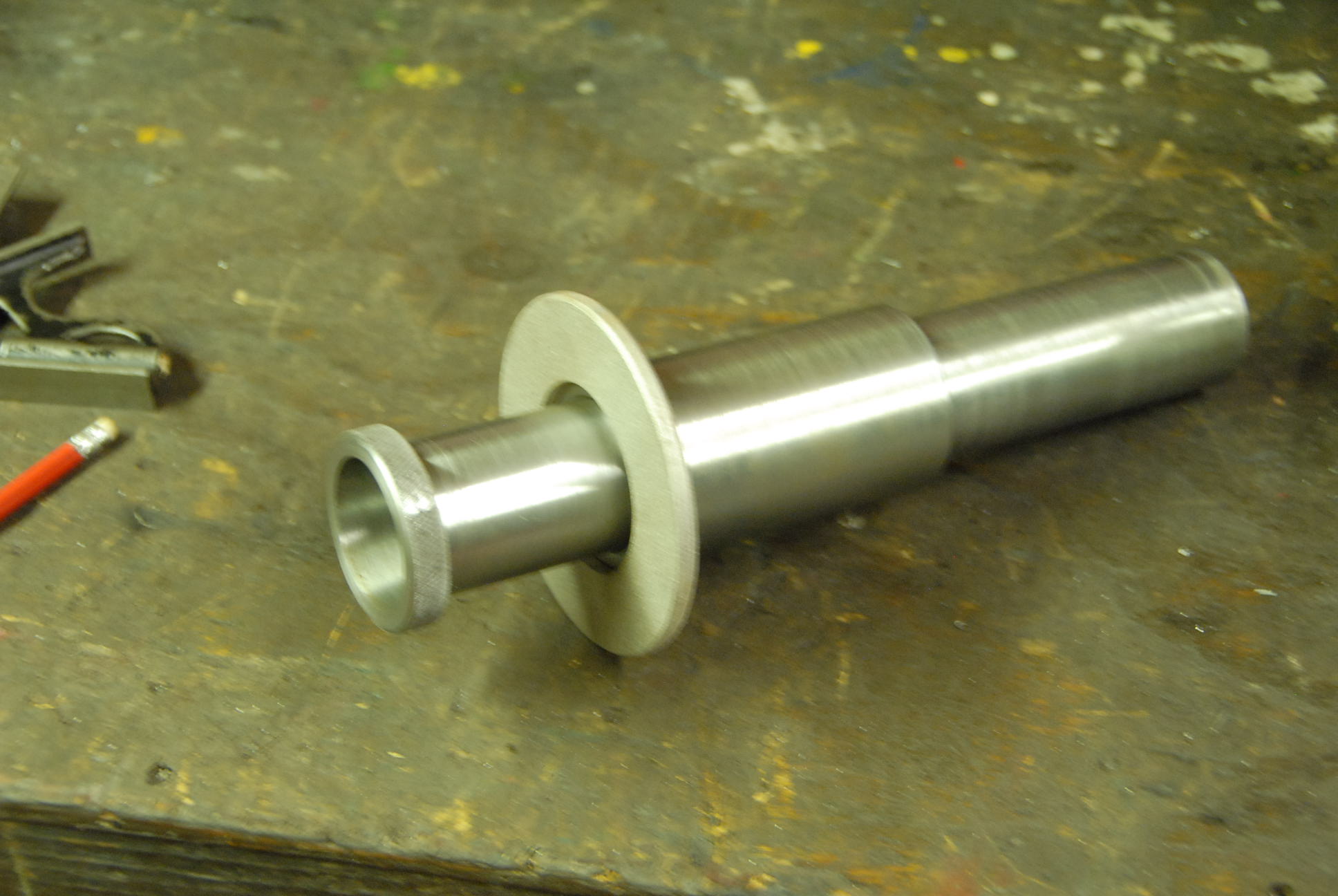

i would suggest you make that cover a little wider than what you are doing
id rather that disc give inside of it an dhave soemwhere for it to go than close proximity it has got
if you look at the design of any grinding machine it has an 1/2-1" clearance around the disk and its the same with big grinders
they kinda have a relief gap between grinding disc and the sides i presume its to allow the disc to disintergrate within the shielding
yours really has no space so if it gives its coming at you
others that use them might have other reasons for this gapping with grinding machines or @Parm might know

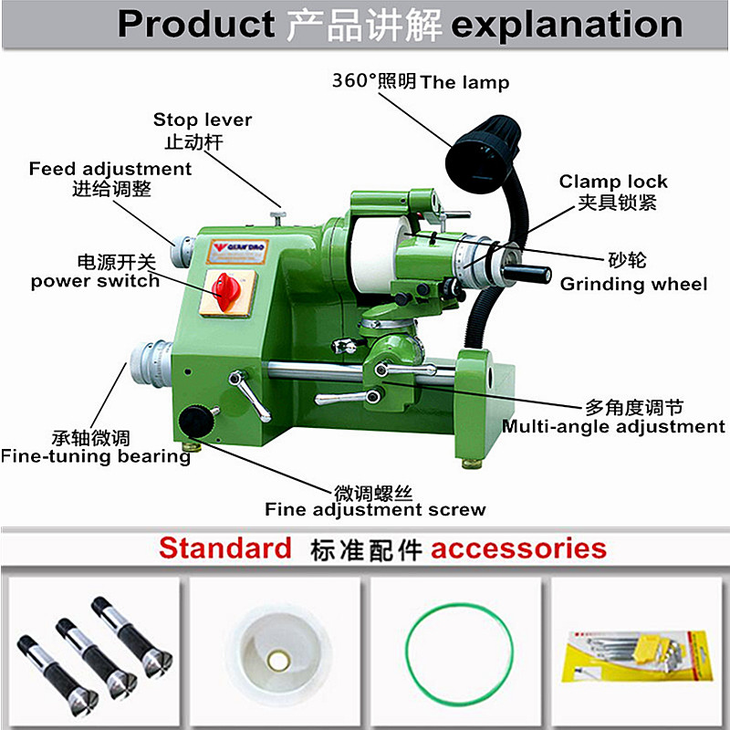

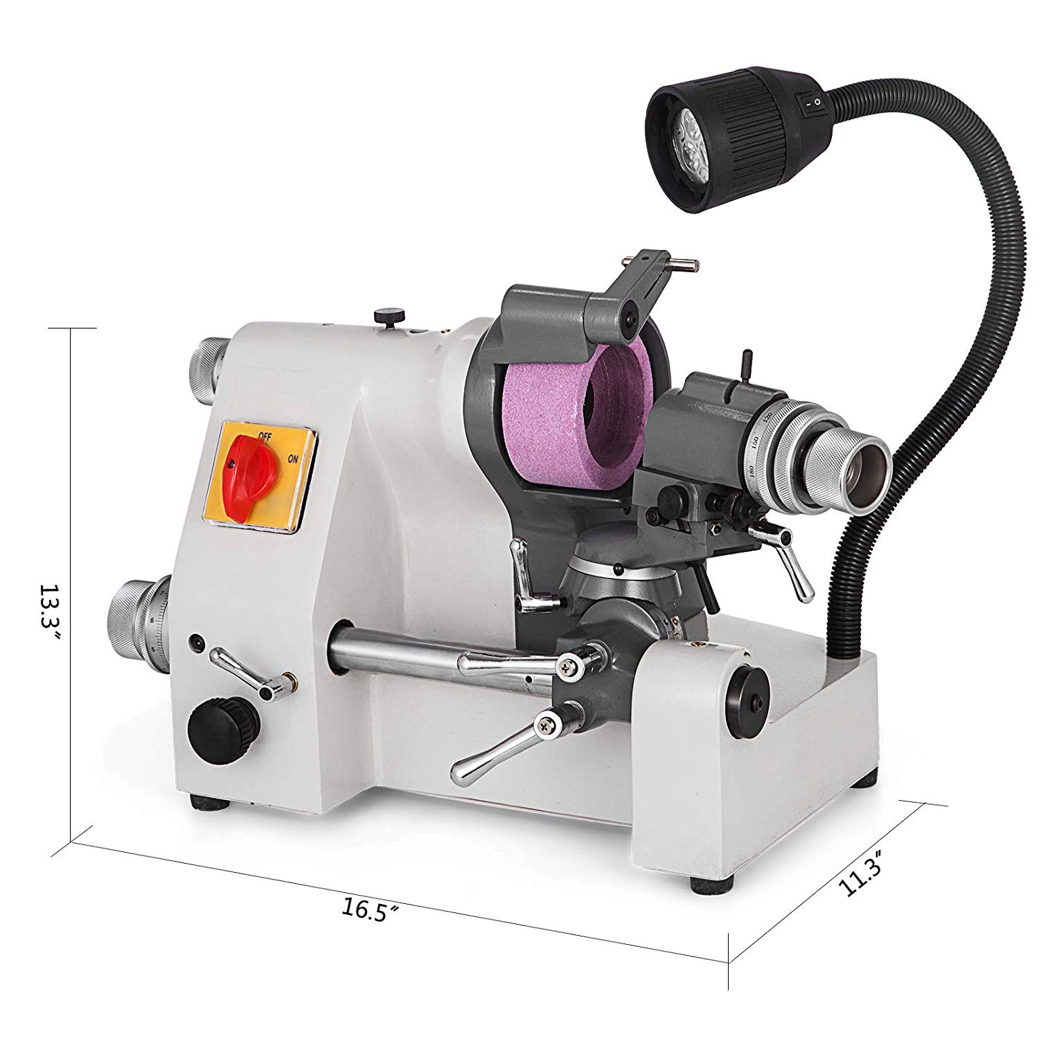

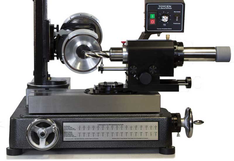

From all the research ive done on these universal tool and cutter grinders they all have seam to have approx 5mm clearance, here's a few examples.
View attachment 209846 View attachment 209847 View attachment 209848 View attachment 209849 View attachment 209850

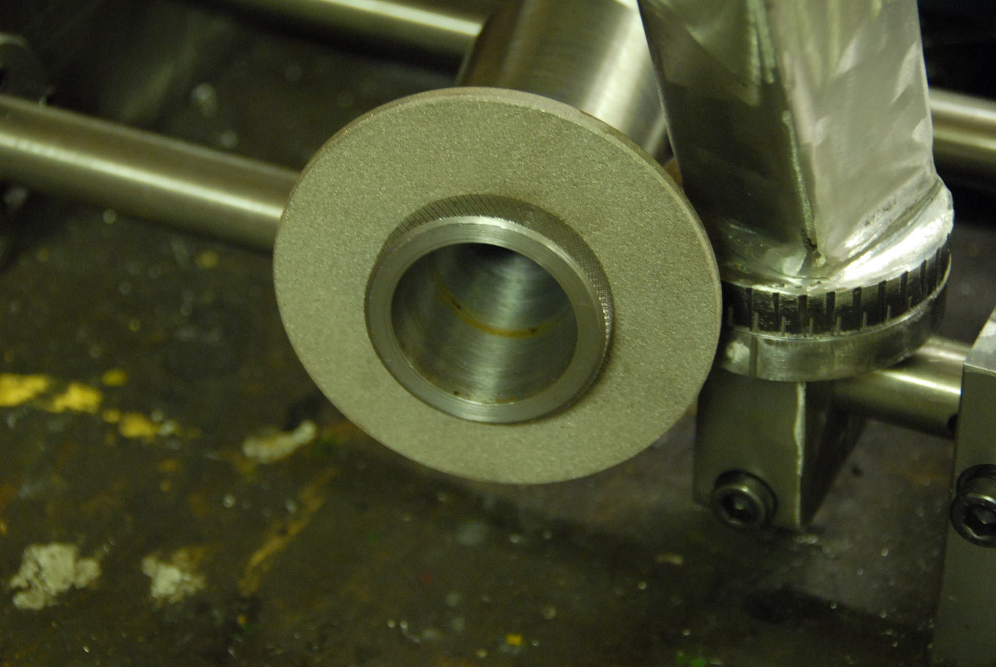

On the 100mm wheel I have actually 6mm. Also the 6mm clearance is only the last few mm as its a cup wheel.
I do intend to mainly use diamond wheels.
