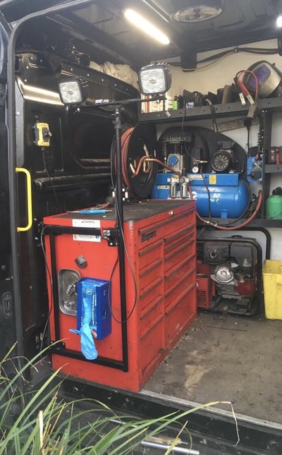

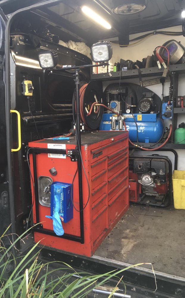

The angle iron frame sounds a good idea. I always mount mine on the right of the sliding door, giving me full walk in access but it probably makes the chest flex even more because it's not against the bulkhead.The only purpose built top box I know of that survives a van life, is the Snapon Road Box bur megger expensive.

I cut a plywood insert to support the complete base, then built an angle iron frame around the tool boxes allowing access to all storage
The frame was bolted to the floor and bulk head to stop the box from flexing, which is what kills any roll cab or top box in a van...
