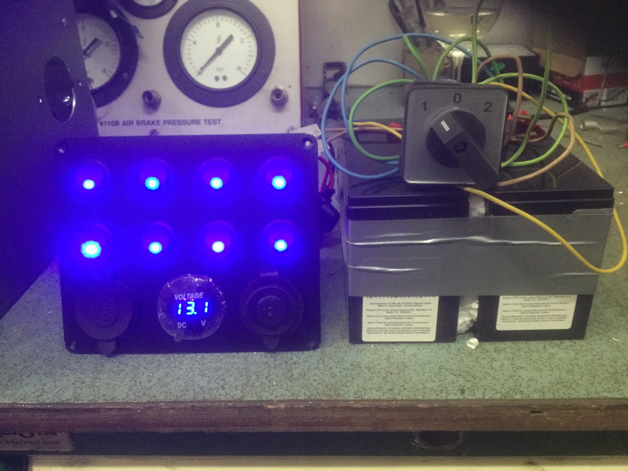

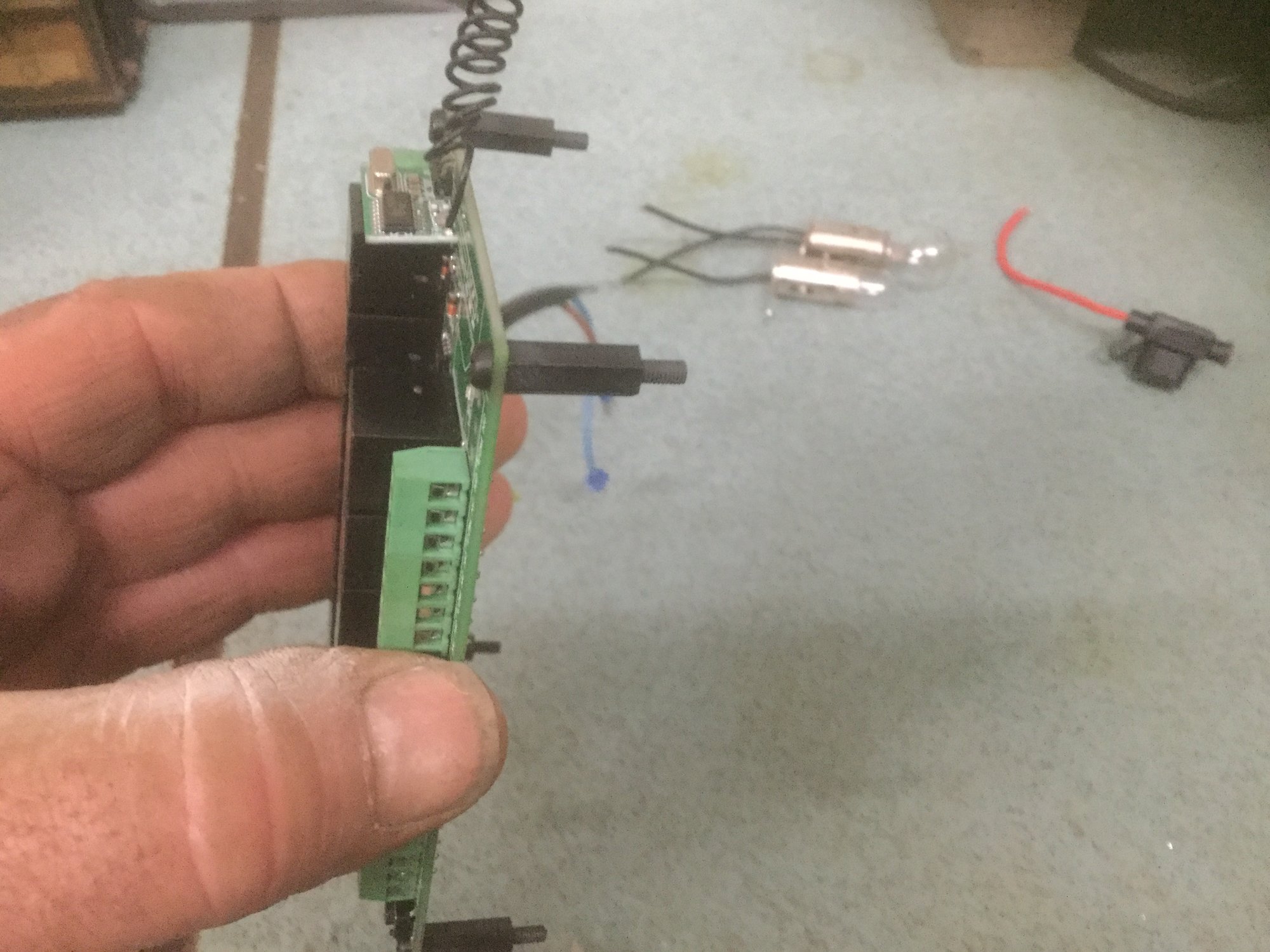

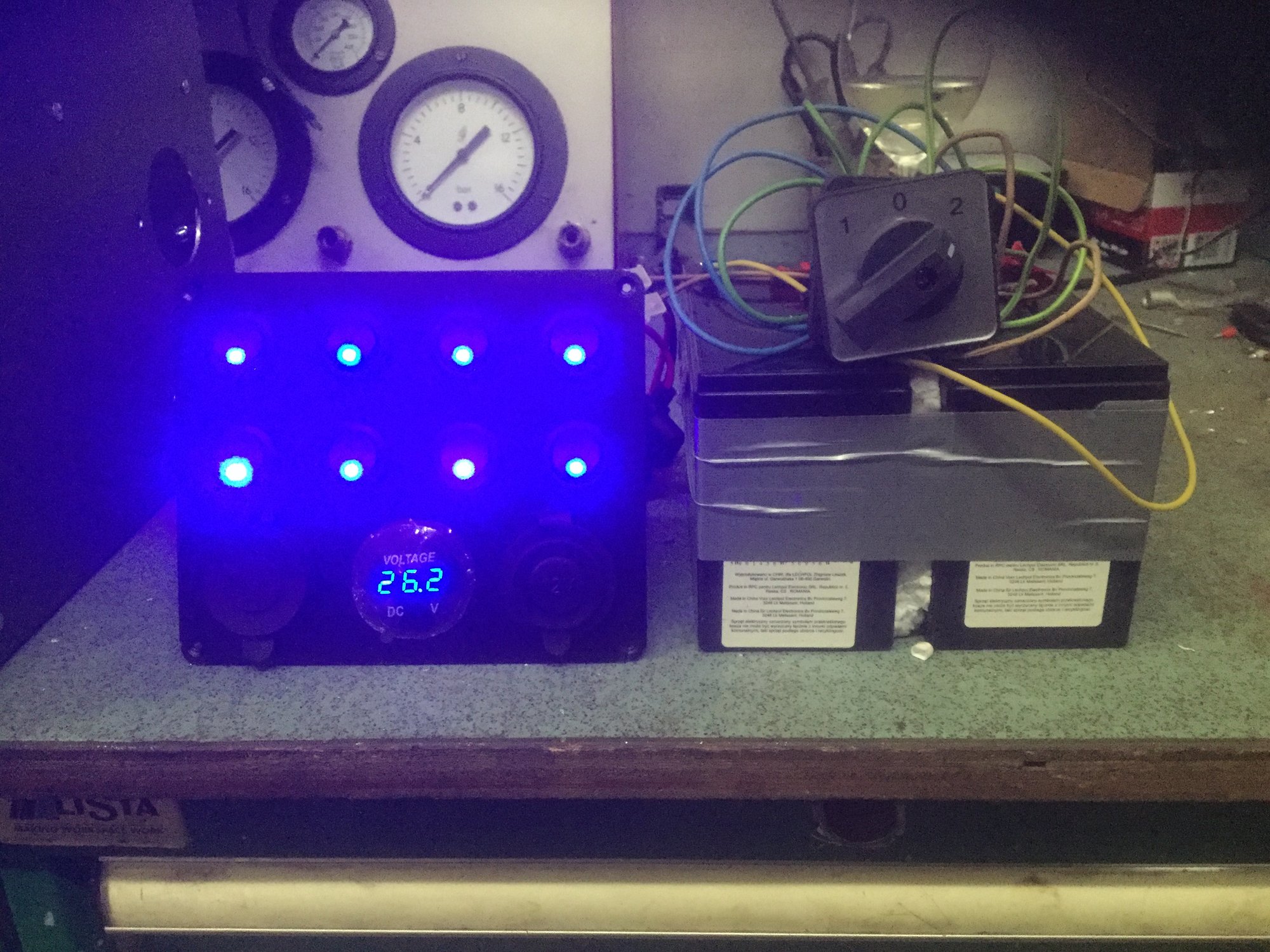

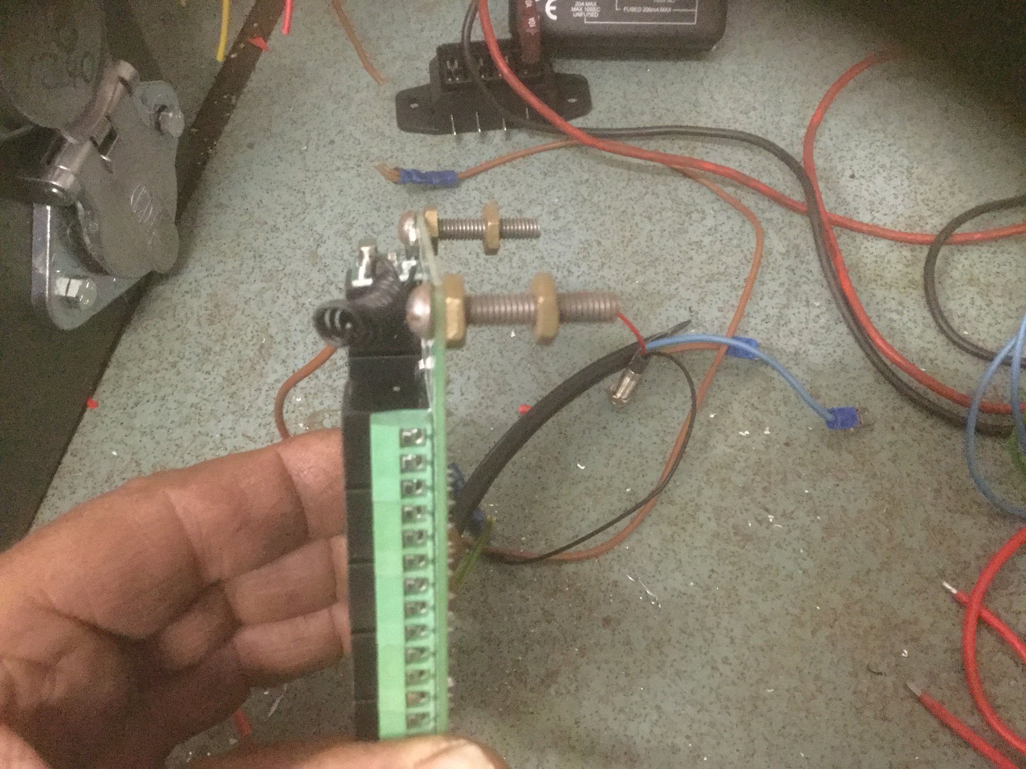

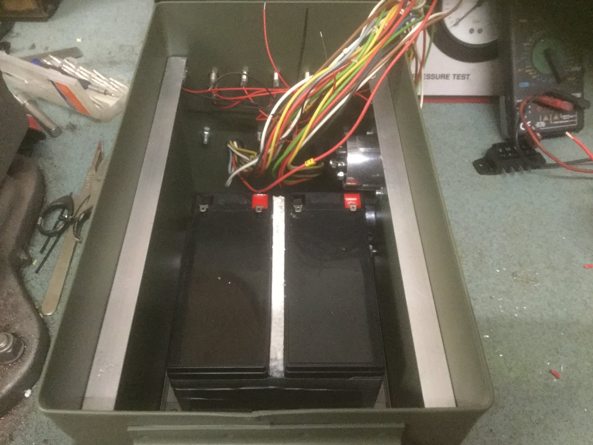

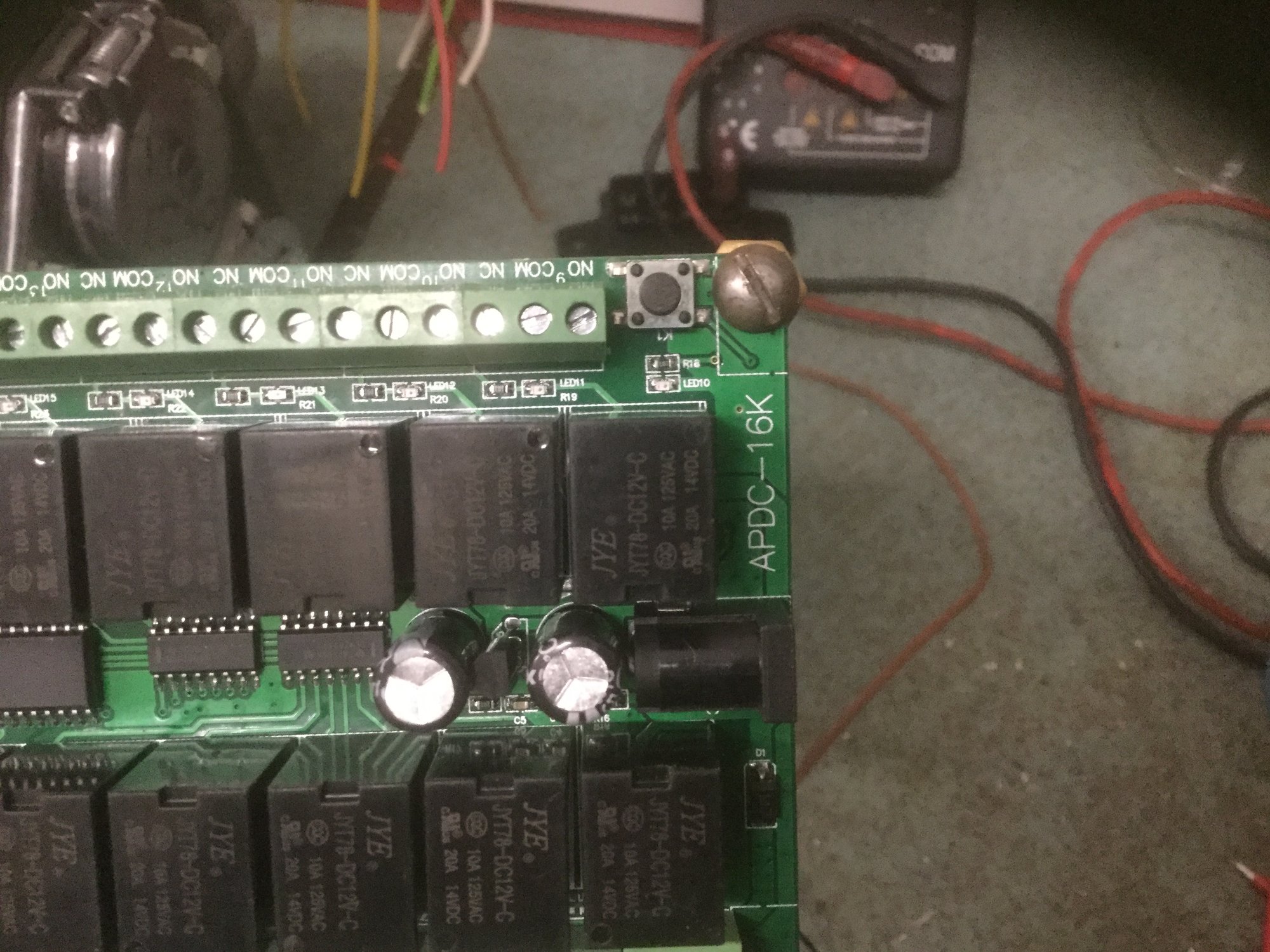

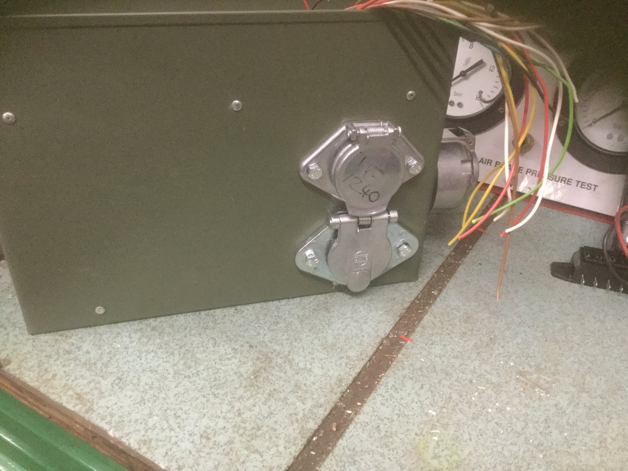

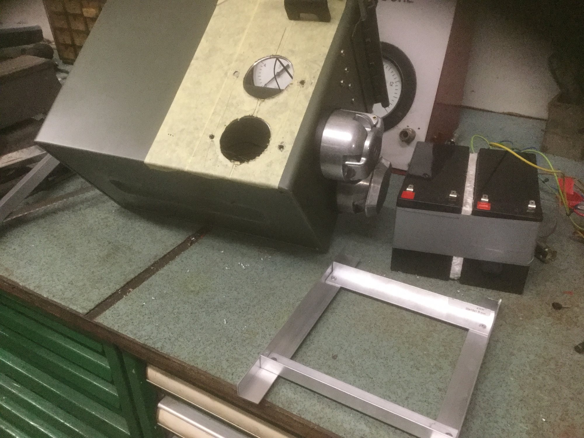

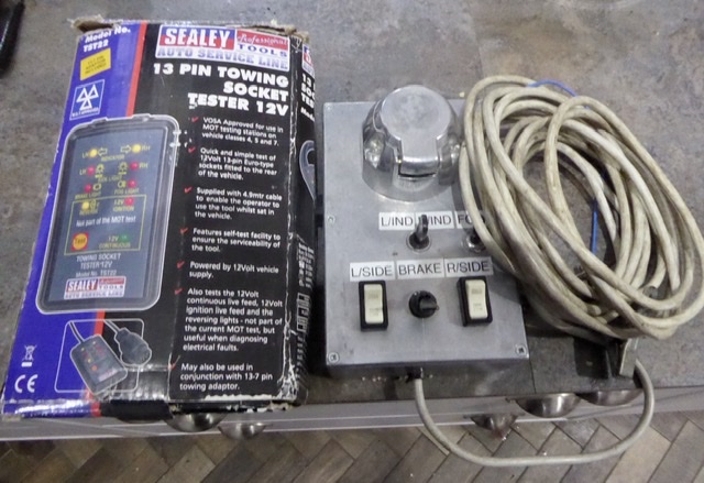

Unfortunately I am not that gifted At 7am in the morning in the pitch dark and with three guys waiting (at my expense) to go to work I need to be able to check both truck and trailer as quick as I can, it’s not their problem they have ripped the wires off the day before and failed to mention it , it’s mine. I haven’t found anything better than the Mk1 so I am just refining the concept and bringing it up to date so it’s completely stand alone. A few mates have copied mine and they all swear by them, also means I can take trailer boards and trailers into my workshop and Wire/test/ repair them without needing a vehicle in there.

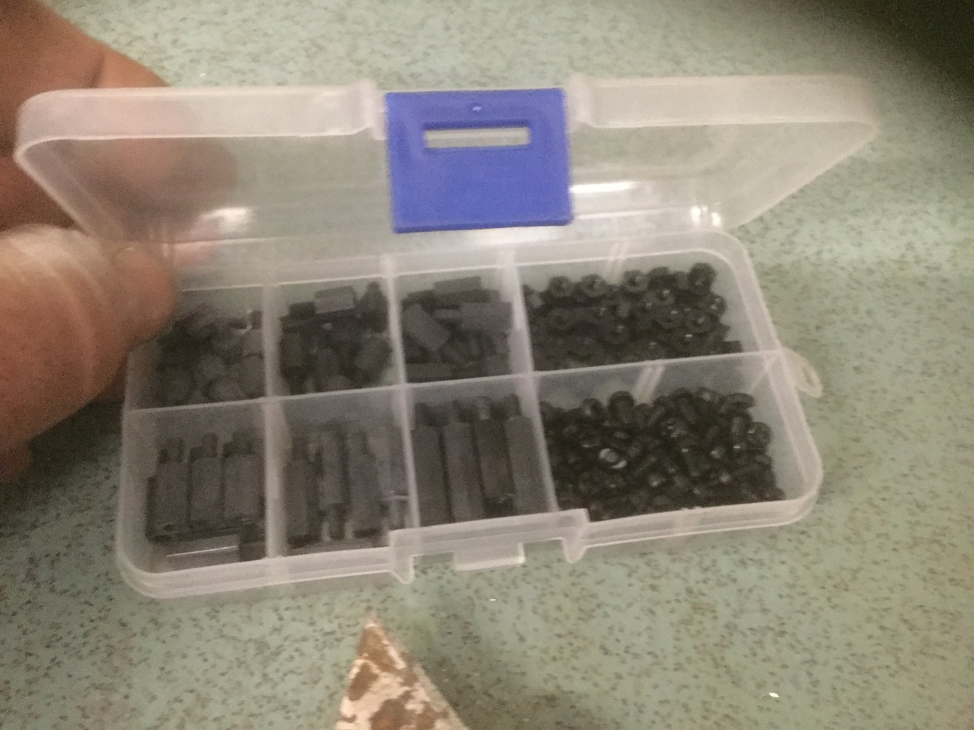

Try googling "pcb standoffs" and "pcb spacers" will give you an idea of types and sizes available
Nylon nuts & bolts make good insulated standoffs

I bought the Sealey tester on the left when tow electrics became an MOT testable item & then realised I had nothing to test the caravan electrics. The box on the right is mainly made up with bits I had lying about apart from the socket & containing box which I had to buy all powered from the car battery with the flying leads. The sealey tester had a 7 to 13 pin adapter negating the need for a separate 13 pin socket.

As far as I know it’s the 13 pins at the moment but 7 will be tested soon or that’s the plan. Anything over class 4 as well as HGV they’re all tested. What I was told, @premmington will know best I’d thinkI never knew that, and to say i have few cars with tow bars electrics fitted. and one didnt work at all and the now van is wired so the plug needs to be plugged in upside down. I had to cut out another notch for the plug to go in. couldnt be bothered to rewire it.
