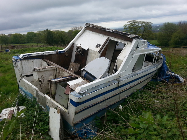

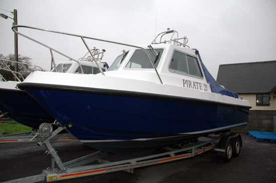

Hi all, i am not far off, well this spring to need to start making the hand rails and bow rail for my boat. I will be using 3/4" ( 19mm ) polished stainless tube with a 1.5mm wall.
Now the idea is one i have seen using ally channel to make a kit car window frame.
Plywood 18mm to rest the tube on which has a radius of 3" ( 75mm ) then either side half way up the tube height again 18mm plywood, so sits about 10mm above the central part, then a madrel to form the tube around the radius, this way the tube will not splay out.
Now not sure if it will crinkle on the raduis.
Your thoughts
