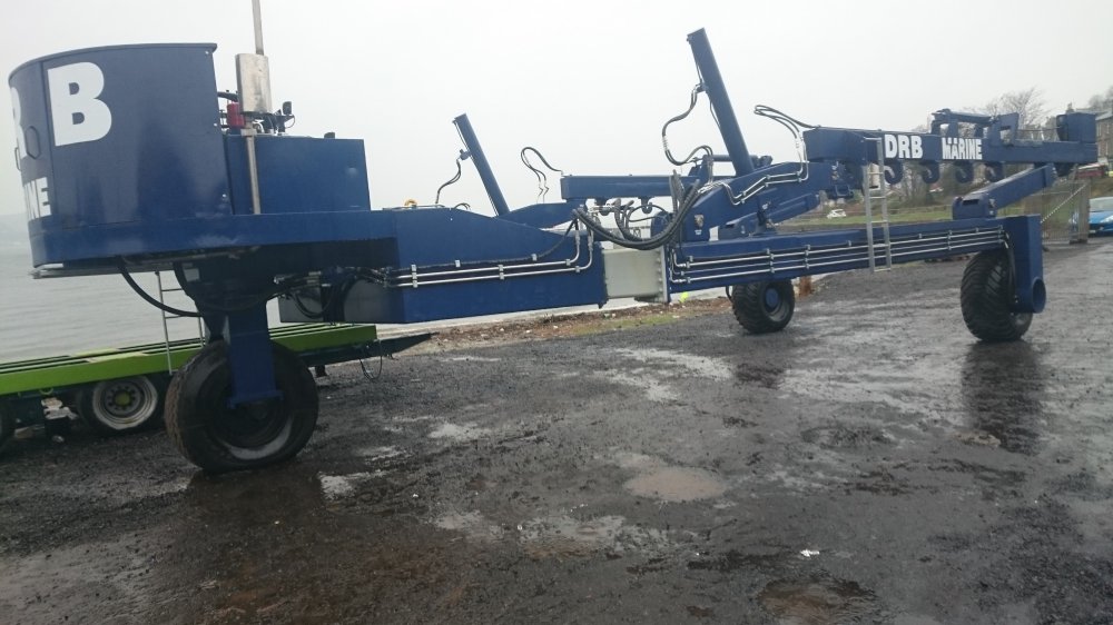

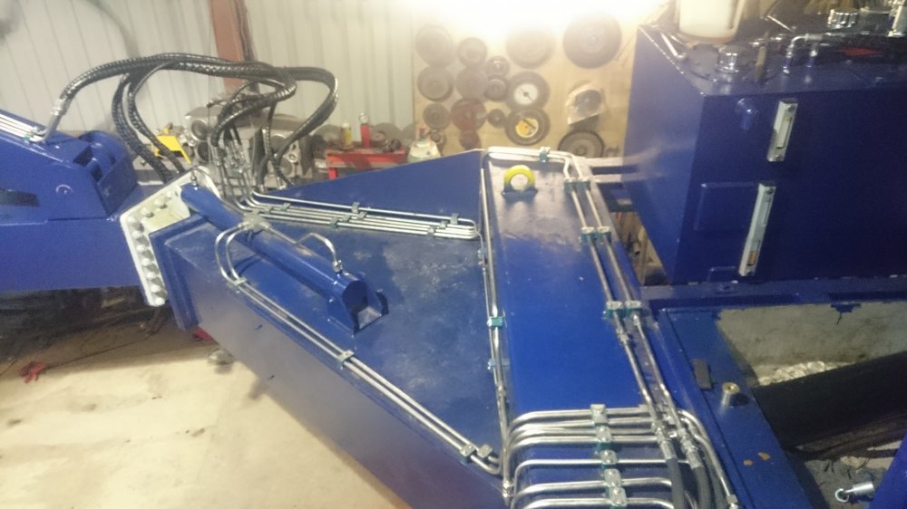

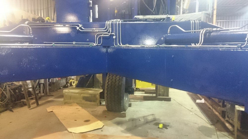

Hi mate, I am a Marine Engineer and hydraulic pipe fitter. For thin wall stainless tube do not buy the hydraulic 12 tonne crossbow type as in Clarke etc. They are for heavy walled steel pipe. You need a tube bender so pipe is supported between former and guide for entire radius of bends for crinkle free forming. I think you can see from below I know what I am talking about. I piped this beastHi all, i am not far off, well this spring to need to start making the hand rails and bow rail for my boat. I will be using 3/4" ( 19mm ) polished stainless tube with a 1.5mm wall.

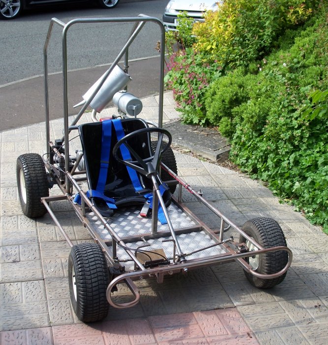

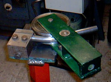

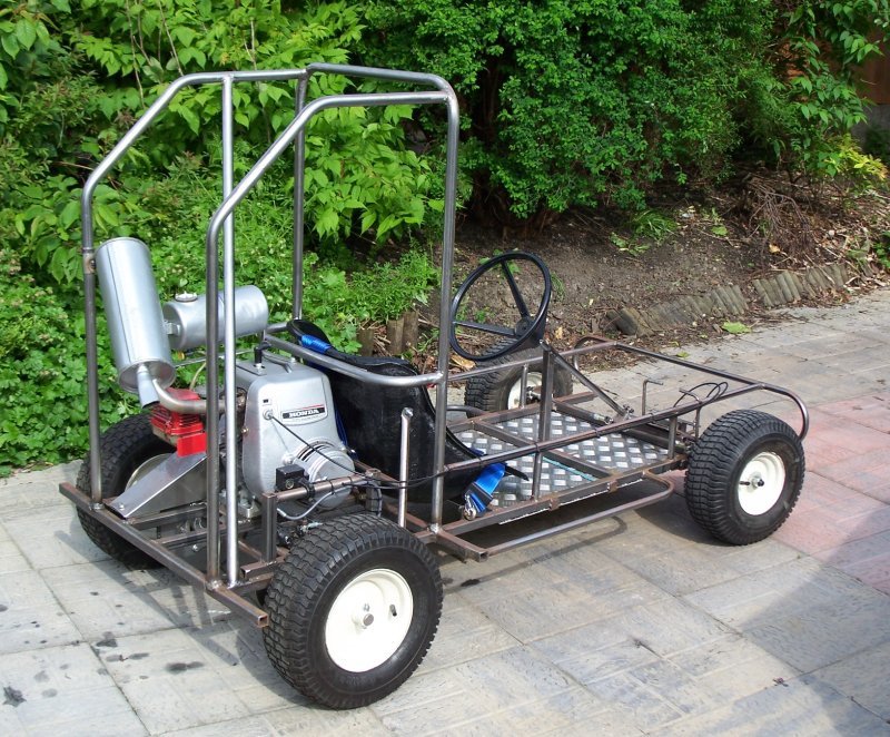

I made a bender for 19mm tube something like 2mm wall thickness and used it to do a 3 inch radius on my go cart I made, had inch and 3/4 inch tube in it, sure I posted some time ago, but anyhow here is a picture or two of the kart so you could see what bends it would do.
And the bender
It sits on top of a Clarke bender stand but sure you could fasten to something else if you wish to try.
You are not a million miles from Blackburn if you wish to borrow it or come up and try a bend.
Sure I could find the formers.

Hi mate, I am a Marine Engineer and hydraulic pipe fitter. For thin wall stainless tube do not buy the hydraulic 12 tonne crossbow type as in Clarke etc. They are for heavy walled steel pipe. You need a tube bender so pipe is supported between former and guide for entire radius of bends for crinkle free forming. I think you can see from below I know what I am talking about. I piped this beast View attachment 80132 View attachment 80134 View attachment 80134 View attachment 80136
