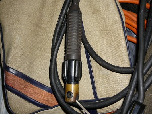

IMHO It's unfair to compare a twist type, which are usually quite robust,
with the sort of holder that comes with a cheap buzz box.
once got the hang of it you can pass the ark from one rod to the other without stoping so get a nicer looking weld
( obviously don't normaly do this but if fixing a ****up where time is the main prority it makes it much faster not haveing to change rods yourself )
How does this work then?..
Well it isn't exactly a major financial undertaking to buy an electrode holder, even if you launch the boat and go for a genuine Myking.
One thing you might check which could save you a bit of hassle is whether it clamps the bare end of the cable with an Allen key arrangement or requires a cable lug which fixes with a bolt. It would be a pain to be messing about cutting a lug off or in want of a lug if you didn't expect it.
My croc clip holder uses a lug and the screw down uses the Allen key clamping arrangement.
Twist grip type with the handle cut back to about 3-4" long. Fits in the palm of your hand and you can get into some tight spaces. Good for welding pipes when there in the rack.
If you can get some make up the last 4 or 5 feet of your welding lead with superflex cable. Really does make a diffrence.
