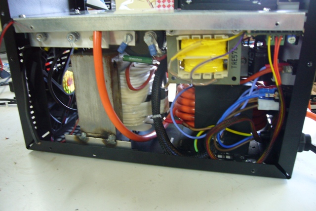

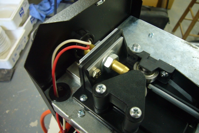

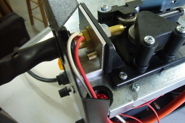

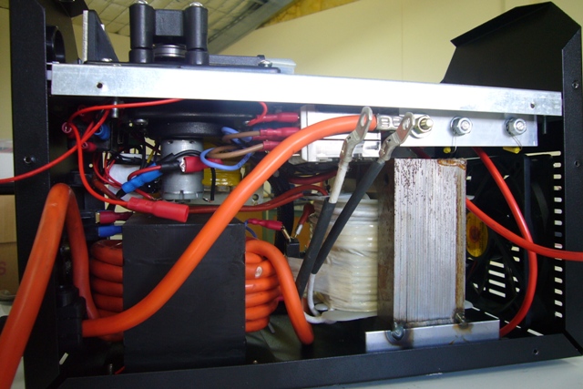

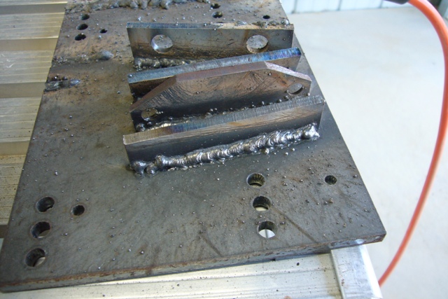

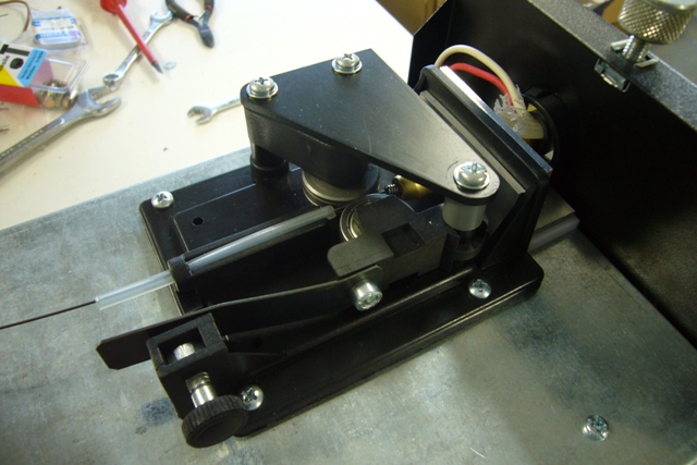

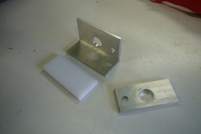

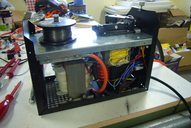

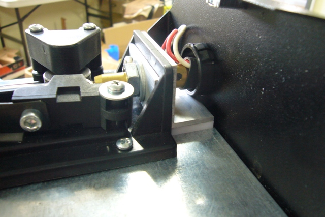

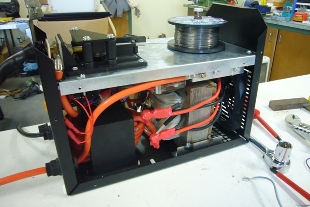

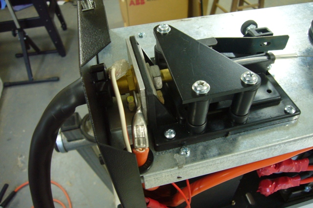

When adding an independent wire-feed power supply on my SIP 130T, I wired a normally-open relay contact across the motor to act as a brake. This reduced run-on quite significantly.there is wire over run at the end of the weld which requires triming back.
