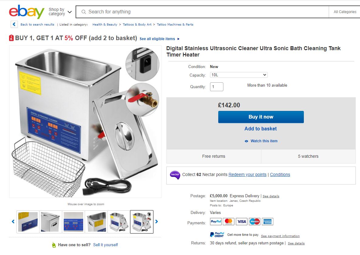

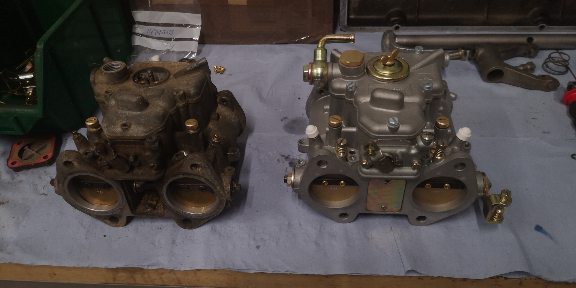

I have four Solex 44iP carbs that i want to clean up well and i hear that this Ultrasonic is the best way to go.
I see the cost is around £30 a carb to get them done, then i see you can buy a cleaner for £100 to £150.
I have picked a couple of random to show wnat i mean and was wondering fi they are good and do a proper job
VEVOR 10L Digital Ultrasonic Cleaner Timer Heater Stainless Steel Cotainer UK 891783560313 | eBay
Why Choose VEVOR?. 10L Tank Capacity. Our ultrasound jewelry cleaner machine will emit 40kHz ultrasonic waves to wash dirt on your valuables' surface and crevice deeply. 9.3L Digital Ultrasonic Cleaner.www.ebay.co.uk

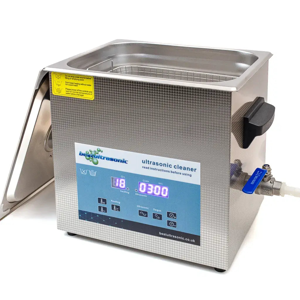

But there are no mugs in the photos to gauge size.@BikerBill web site has a clearance corner, usually machines returned because the buyer wanted a bigger tank, with 12 months warranty
Special offers and clearance ultrasonic cleaners
Clearance and special offer ultrasonic cleaners at discount prices. Sale prices and customer returns at substantial discounts on list prices.www.bestultrasonic.co.uk

Not really true.I have one, spent approx £100. I think the internal heater and degreaser fluid do a lot more than the actual ultrasonic waves.
Mmmmm..... I've always stripped them down. Float chambers are often pretty mucky and whether you could clean and drain the muck from them as well with the whole carb fully assembled and immersed is a bit of an unknown. While an ultrasonic clean of a carb often does wonders, I've still had the odd one did not respond.With ultrasonic tank, you can just stick it fully assembled.
Definitely.Mmmmm..... I've always stripped them down. Float chambers are often pretty mucky and whether you could clean and drain the muck from them as well with the whole carb fully assembled and immersed is a bit of an unknown. While an ultrasonic clean of a carb often does wonders, I've still had the odd one did not respond.
@bricol do you think these low cost home ultrasonic cleaners are powerful enough to have any significant effect? I do get a good result from mine sometimes, when I put in a greasy part it comes out clean. But when I put in my Weber carb I didn't really see any effect.Not really true.
Chemistry and heat play a part, but working ultrasonsics work impressively well - given you have chosen the right chemistry for the contamination you want to remove from the materials you have.
Given the right materials, contamination etc, even plain old water in an ultrasonic tank will work to a degree. You do have to have liquid in the parts where you want cleaning - air locks or parts out of the solutions, or shielded by baskets (you can get mesh baskets, if mesh size is just wrong, in-effect cancelling the "waves"), won't clean. Direct line of sight from working surface to the component gives the best effect of course.
Quick party-trick test to see if your ultrasonics are working at all - lower an opened bottle/container of a carbonated drink in the the solution in the working tank - within seconds you should an erupting fountain of de-grassing liquid from the bottle. There are more scientific tests available
One thing always mentioned to us - don't stick body parts in the working tank - that degassing liquid in the bottle? Same effect on the liquid in your fingers . . . and I know, some people have done it for years, with no effects . . . yet . . .
If that was a new price . . . then it's probably not got much power in the ultrasonic bits.
I can personally recommend best ultrasonic.
