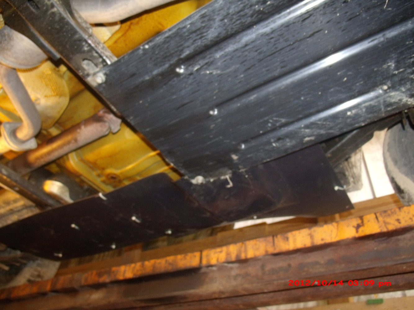

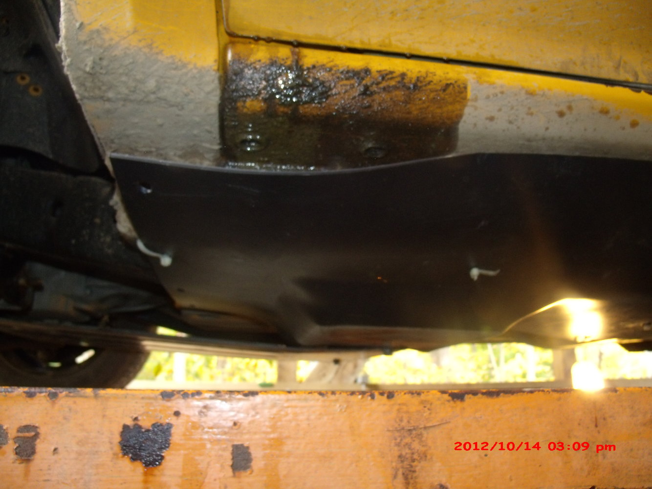

I have found that if you paint Galvafroid or similar over any sort of rust converter, it tends to peel off after a while. Only use it if you can get back to clean shiny metal. Same with anything epoxy.
It really isn't practical or possible to clean the underside of any vehicle properly, unless it is a full stripdown restoration.
I can't be bothered with even trying to attempt it these days, so a really good spray with degreaser them a good going over with steam cleaner (not cold) then scrape off any flaky paint and rust, sand the rusty bits if bad, Then apply something greasy like Bilt Hamber UB or Dinitrol equivalent.
DO NOT bother with anything lanolin, it is a complete waste of time. I have been trialling it with some test pieces for a couple of years, and it just does not last. Even less so under a vehicle. It seems to be sold entirely by ease of application, which sometimes it isn't, and that it gives a nice finish ...... for a little while.
With the Bilt Hamber UB, I cold pressure wash occasionally, then spray some of their S50 on it. Keeps it greasy and supple
And don't forget, the best way to keep rust at bay, is to keep the underside free of caked mud.
