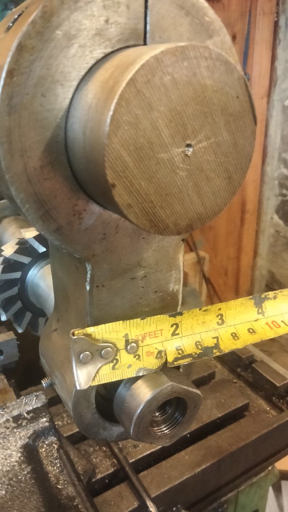

I've managed some really thick stuff maxed out at 200 amps, with multiple passes, but it was for my personal use and not structural (before someone leaps in). The whole piece was glowing red hot (which might not be tolerated) and fusion was good. As someone quite rightly stated the root has got to be good and successive passes are just a repeat of the same. I am NOT a professional welder, but have been mig/tig'ing 30yrsThanks for the response. I will get hold of some thick plate as you suggest and have a go.

 This is 3 pieces. No it hasn't been dye-penned, but has been tested in anger many times. They are ALL root welds built up with multi-passes. Ground up to finish off. I use pub gas CO² always have and being a cheapskate always will.

Are you saying this was with a 200amp welder?By thick stuff I mean.....View attachment 331386This is 3 pieces. No it hasn't been dye-penned, but has been tested in anger many times. They are ALL root welds built up with multi-passes. Ground up to finish off. I use pub gas CO² always have and being a cheapskate always will.
