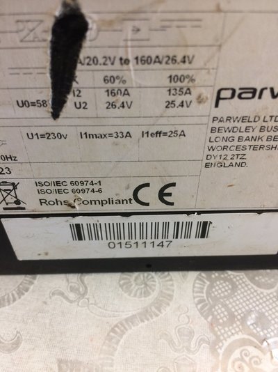

The 32A figure is the instantaneous max current when you start the arc, but it only lasts for a millisecond or two so is well within the capabilities of the 16A socket and the cabling to the machine. The 1eff figure is related to that but a bit of jiggery-pokery is applied for design purposes and the same applies.What does this mean l1eff=25a does that mean it need a 32 amp supply the welder came with 16 amp
So it will be ok at 16 amps supply full powerThe 32A figure is the instantaneous max current when you start the arc, but it only lasts for a millisecond or two so is well within the capabilities of the 16A socket and the cabling to the machine. The 1eff figure is related to that but a bit of jiggery-pokery is applied for design purposes and the same applies.
Ideally, a 32A plug and socket would be used if you're going to run the guts out of the thing all day long, but since most of the time you'll probably be using it at half to two-thirds power, you'd be fine with the 16A plug.
Hell, a lot of people use them on 13A plugs and pop the odd fuse once in a blue moon, but obviously nowhere near full power.
I throw the ball over to power sparklers to further explain the smoke and magic.
You'd probably be fine with that. Many of these machines run happily for years on a 16A socket with no problems.So it will be ok at 16 amps supply full power
