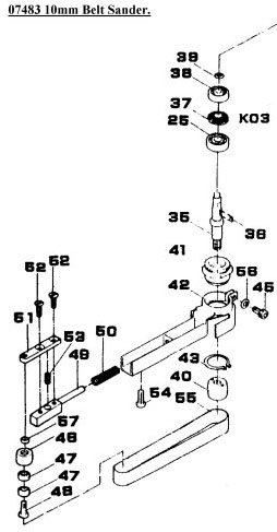

have you tried using it with the screw just loose enough to allow the spring to hold the belt under tension? Also are you using cheap belts? We had a few on a linisher in work that lasted all of a minute before they stretched or snagged up. Got a few more in that were a few pence more expensive and lasted weeks
Black and Wrecker do an electric one called the Powerfile, quieter, cheaper to run than an air tool.
