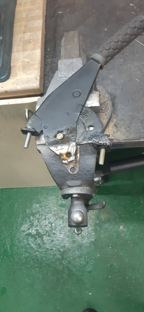

Yes, I shall have to experiment with such things. The inner pads are new and only touch the disc on one edge at the moment, so they'll need bedding in to make it work at all.Extend the handbrake lever to give more pull if you canView attachment 422267

I did something simiilar to the handbrake on the TVR to persuade the Jag calipers to try a bit harder.Extend the handbrake lever to give more pull if you canView attachment 422267
