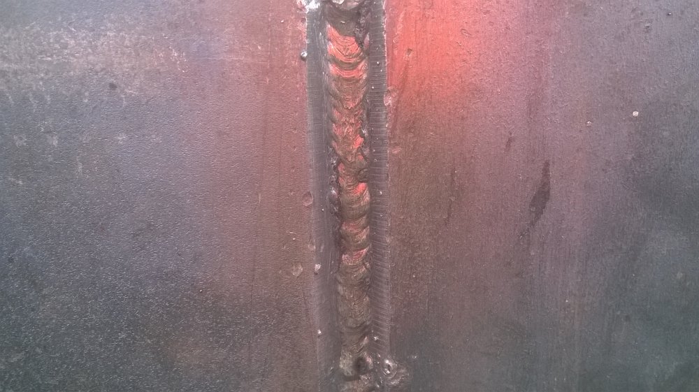

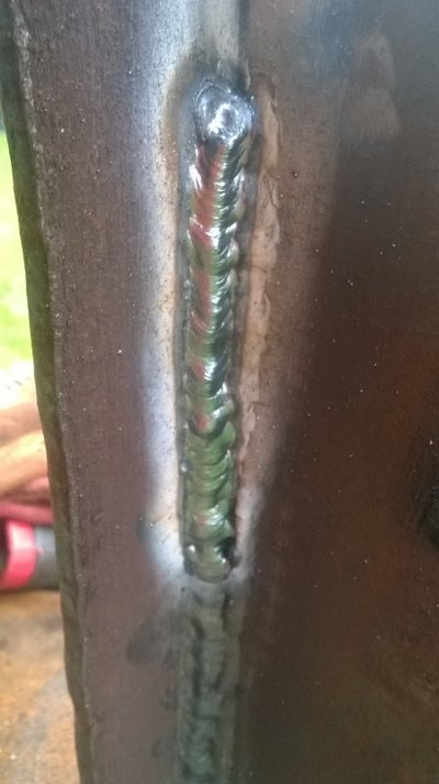

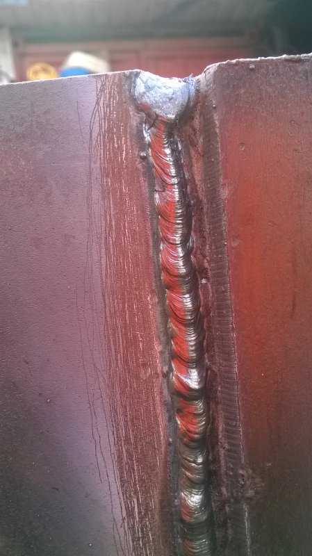

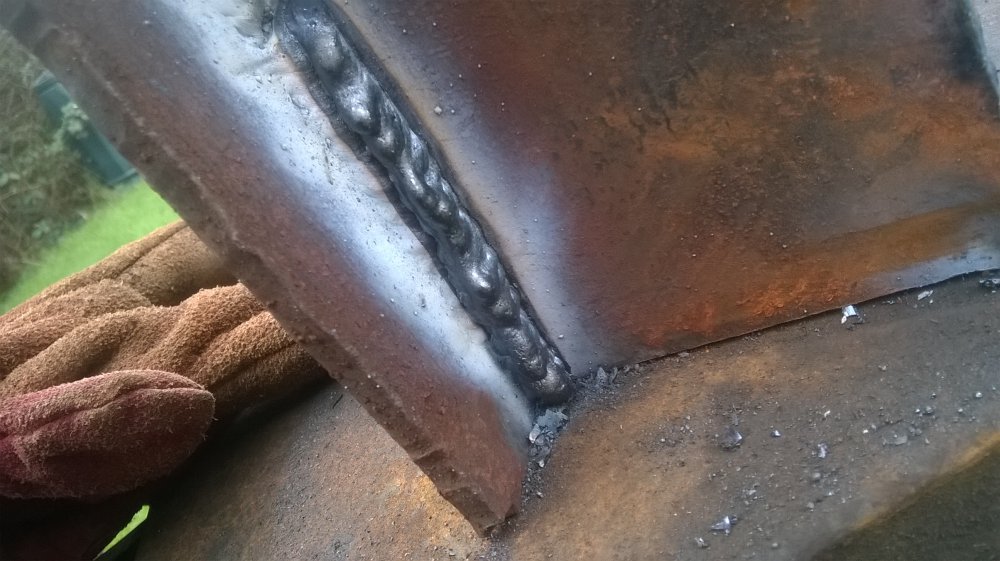

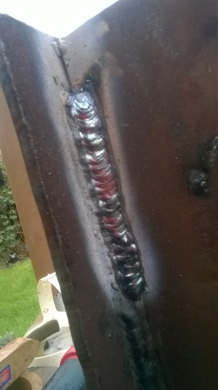

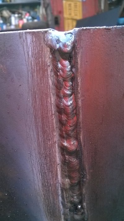

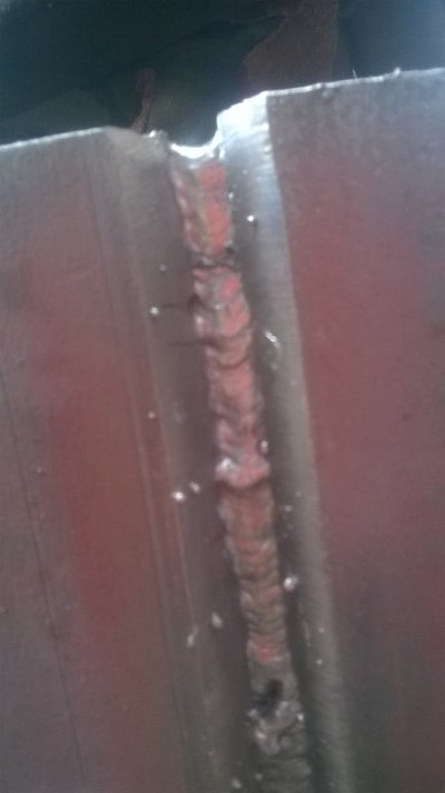

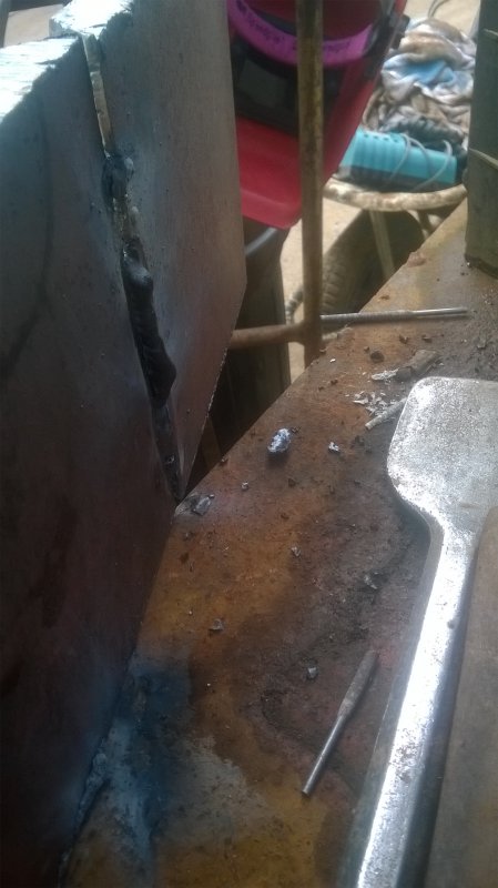

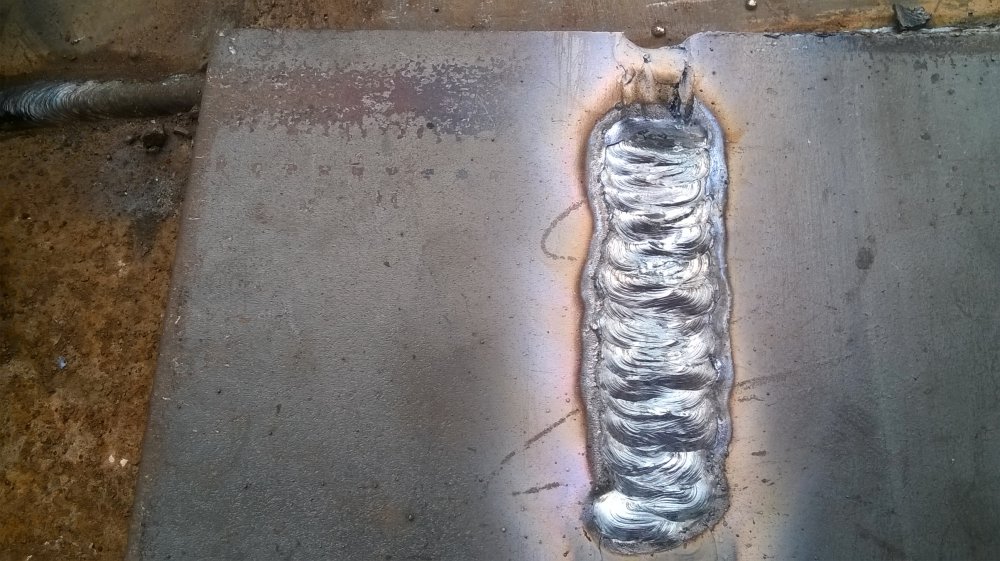

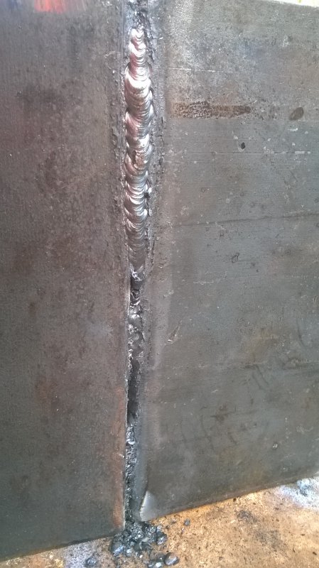

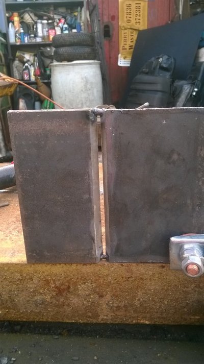

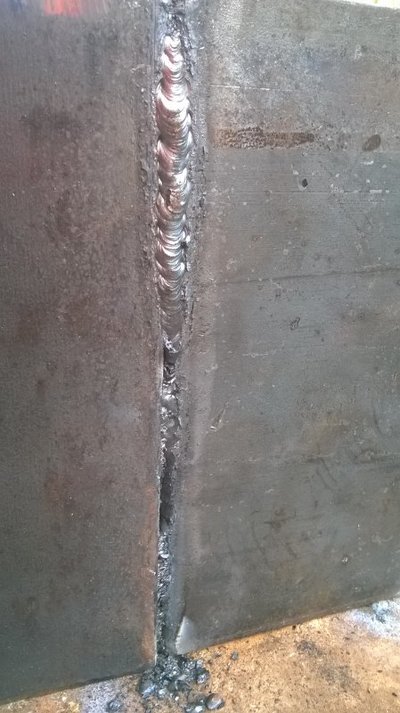

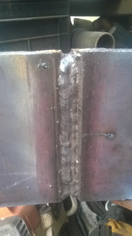

Now I saw a member hear trying this thought this would be fun to have ago at its not easy. I'm self taught all welding processes and have not had any tuition except from hear and you tube. This is a 2.5 open root vertical up butt weld attempt 1
70 amps root
75 ish two pass
75 weaved cap got bored by this point
all criticism accepted you guys have pushed my skills ten fold from what I was way back when
The Last photo was the penetration its a bit excessive but first attempt ect
