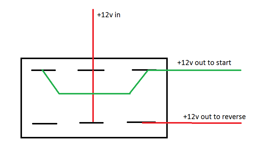

When you rotate the switch either way does it only operate one side at a time ?
Doesn’t look to me like that will work if the switch is 3 position.
If, as said above, it needs the run contact maintained as well as the reverse contact then you would ideally need 2 contacts for it to work in reverse mode, 1 to go to the Rev contact and the other to go to run contact.

If you have jog working with a momentary switch connect the output of that to the reverse connection hold the switch on and turn you main switch on (connect start) and see if direction of motor is reversed

If you put 12v on the run then it runs, yes?
If you put 12v on the reverse only it doesn't run?
Have you actually tried putting the 12v on the run and reverse together as has been suggested?
