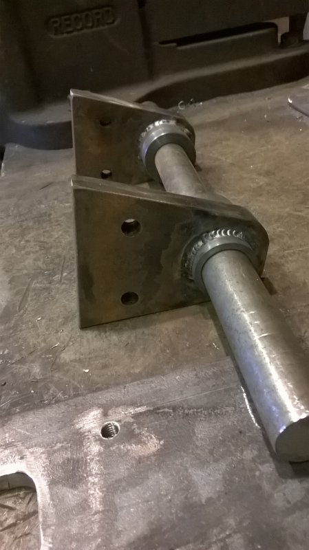

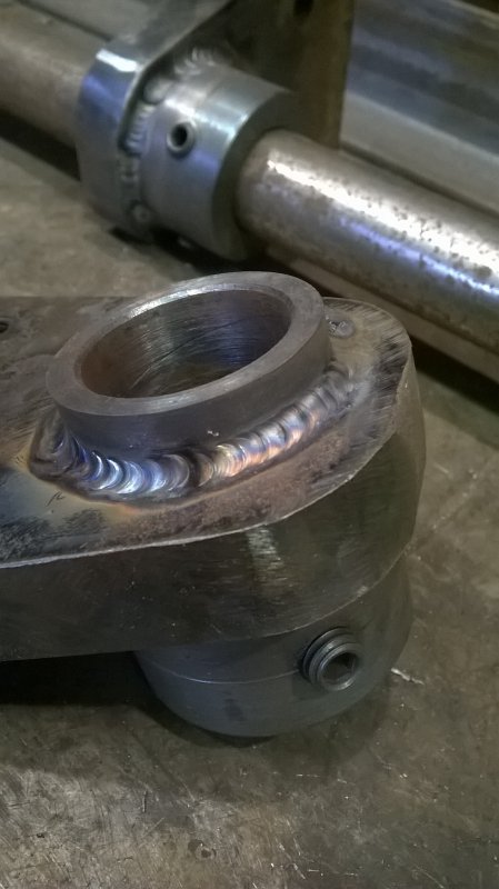

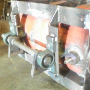

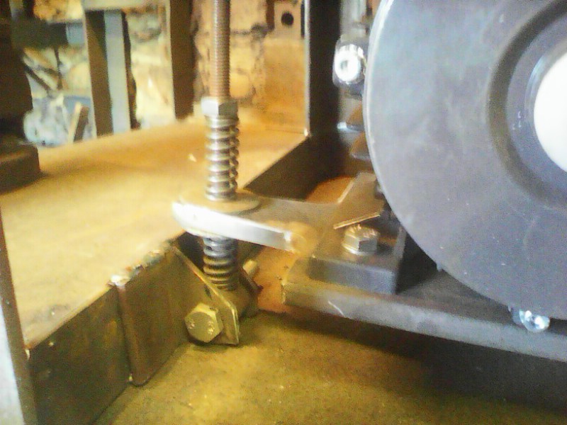

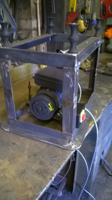

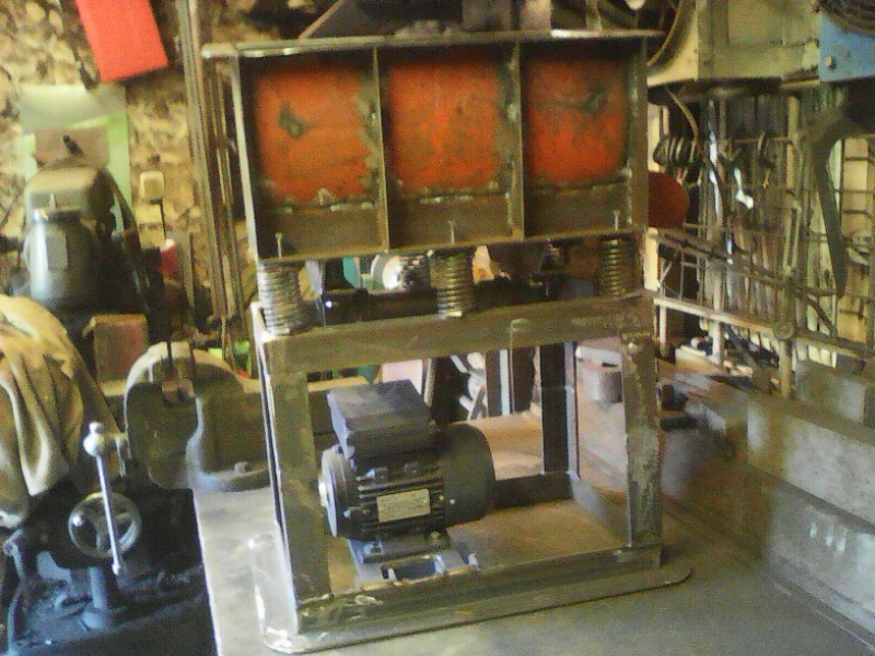

Just started to put together this thing to clean and deburr CDS tubing.
I sometimes need to tig weld some components out of CDS tubing and it's always covered in oil inside and out and has burrs from where the ends are notched. I usually end up spending a couple of hours cleaning as there can be up to 70 bits to sort out.

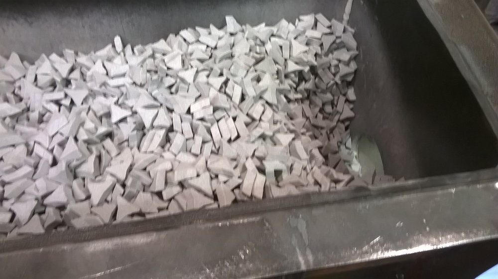

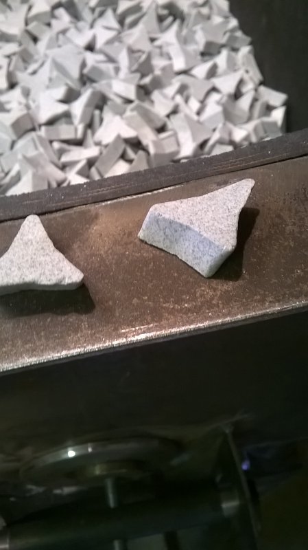

The plan is to use ceramic media to clean and deburr....i thought about using a drum a bit like a cement mixer but on having a look around the net found these tubs...i used to work a fair bit on large aggregate screens which are pretty much the same so thought i'd give it a go.
This is how it's going in pics ......

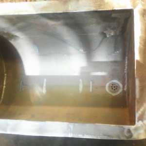

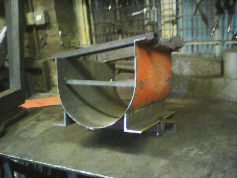

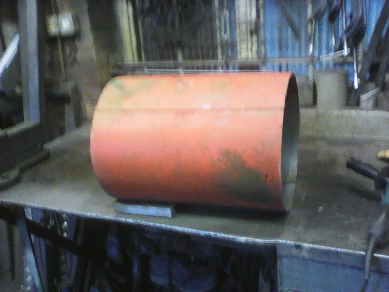

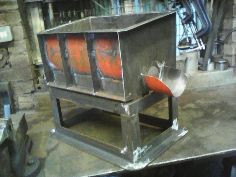

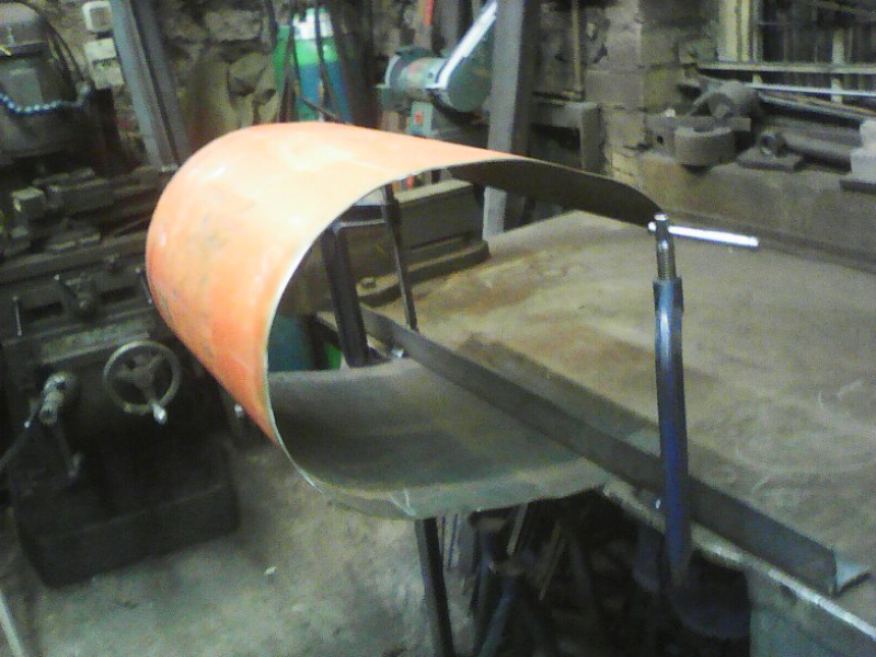

The tub made out of a handy bit of round cylinder
Straightening out the front and back

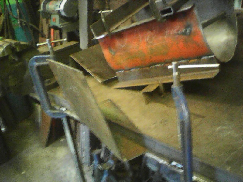

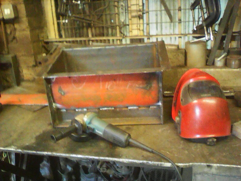

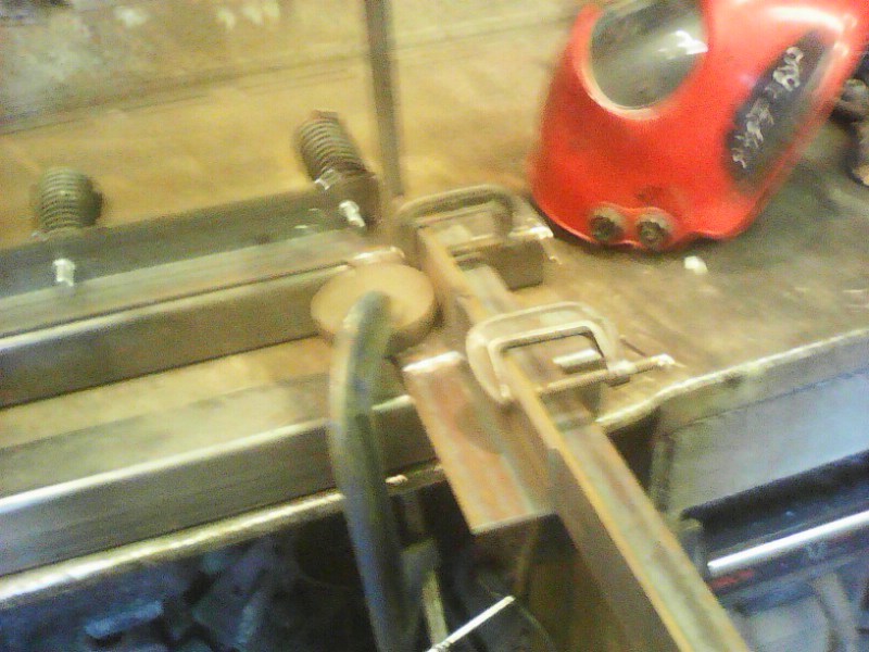

A few bits tacked on to hold the shape while the angle iron base is stuck on
Folding the top flange of the side plate....a bit of old diesel tank

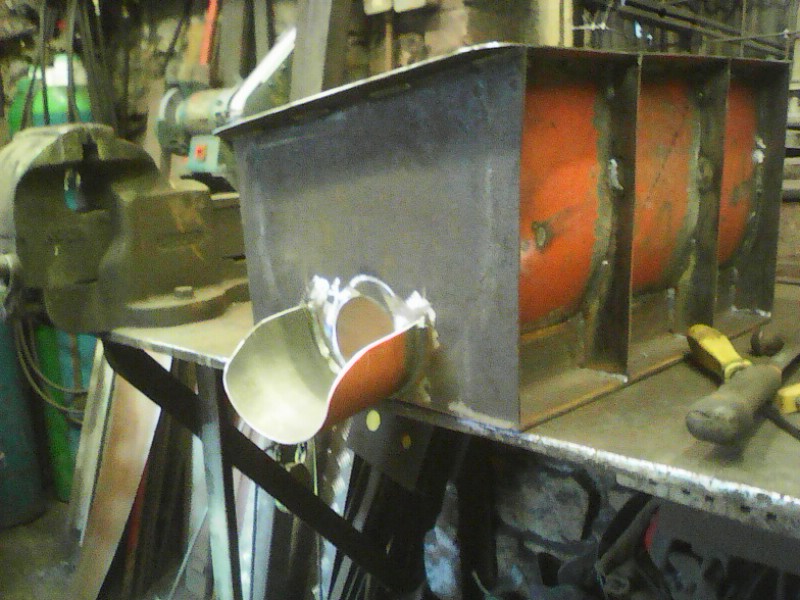

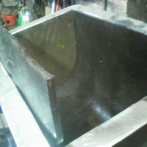

A bit of welding and the tub is coming together

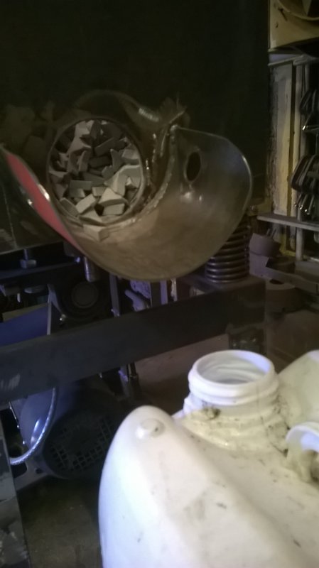

An outlet in one end if stuff needs emptying.

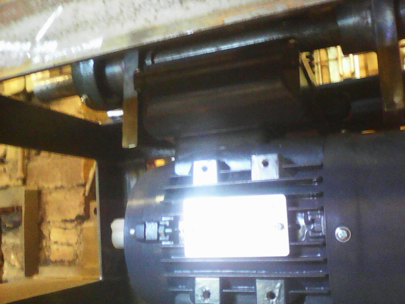

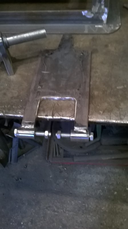

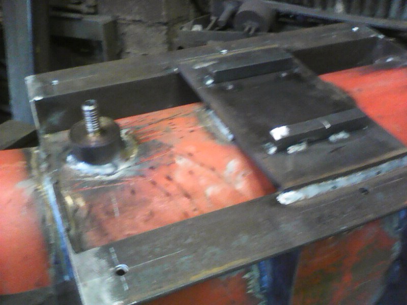

The underneath has an outlet for liquid...the motor base was for a small vibrator that was no good so has now been choped off.

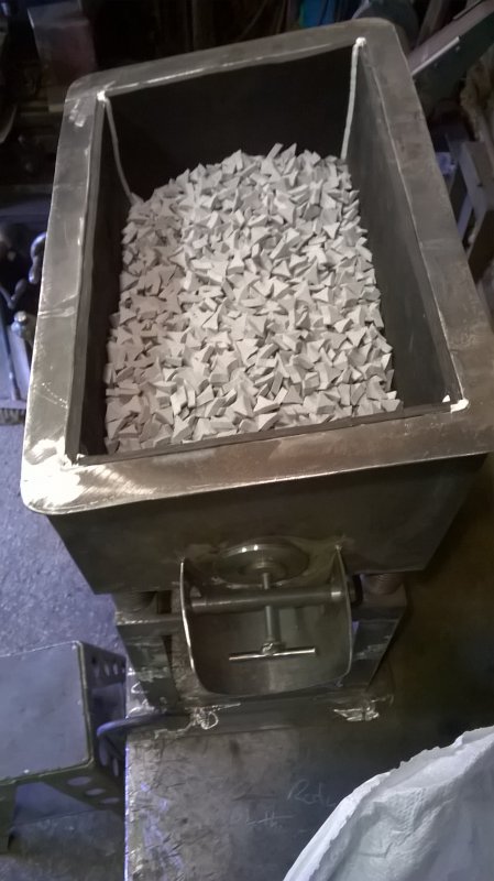

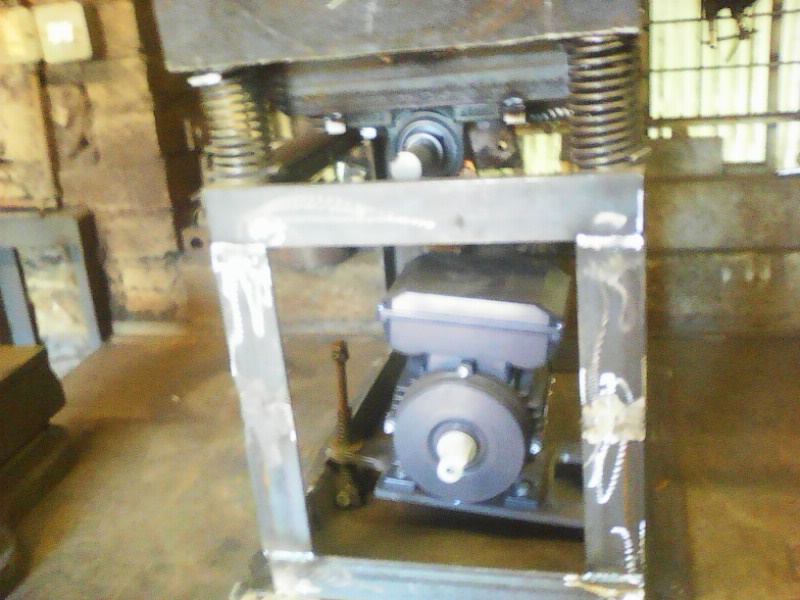

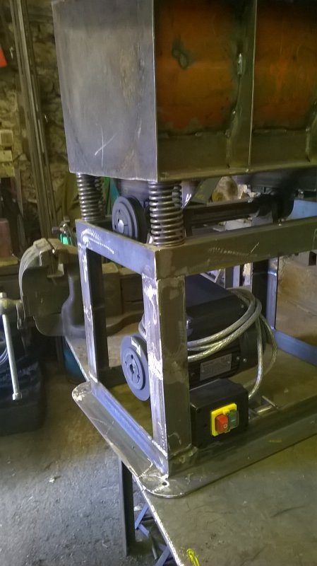

The tub sitting on the base.
The tub is 10" tall at the front 12" at the back and 20" wide. 12" from front to back. It should hold around 1.5 cuft.

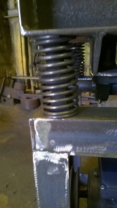

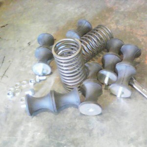

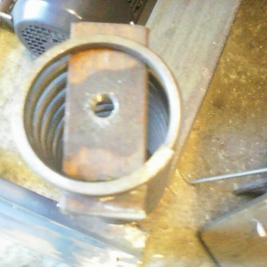

Sitting on six springs

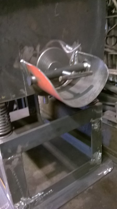

Door for the open end
