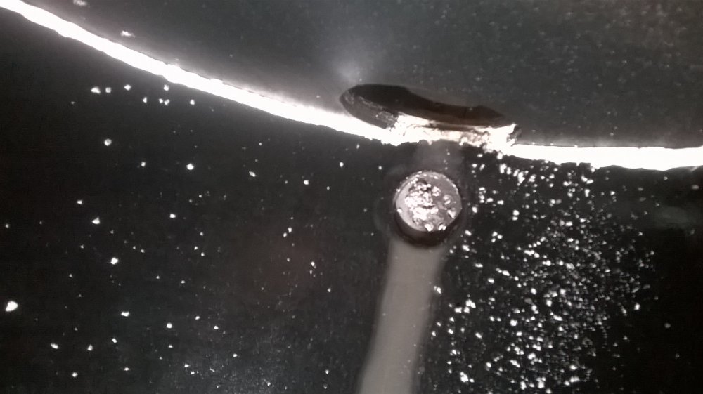

do you plan to put a lid on it, if you do you would only need a small amount of liquid in there to stop the dust and would end up a sludge
I'm not too sure on a lid yet.
From what i've read the liquid is just supposed to keep the ceramic clean so it "cuts" better and the abrasive surface doesn't block up.
Too much water is supposed to be bad as the ceramic just sort of floats and doesn't do anything.....it has a drain in the bottom so liquid can be constantly circulated around.
