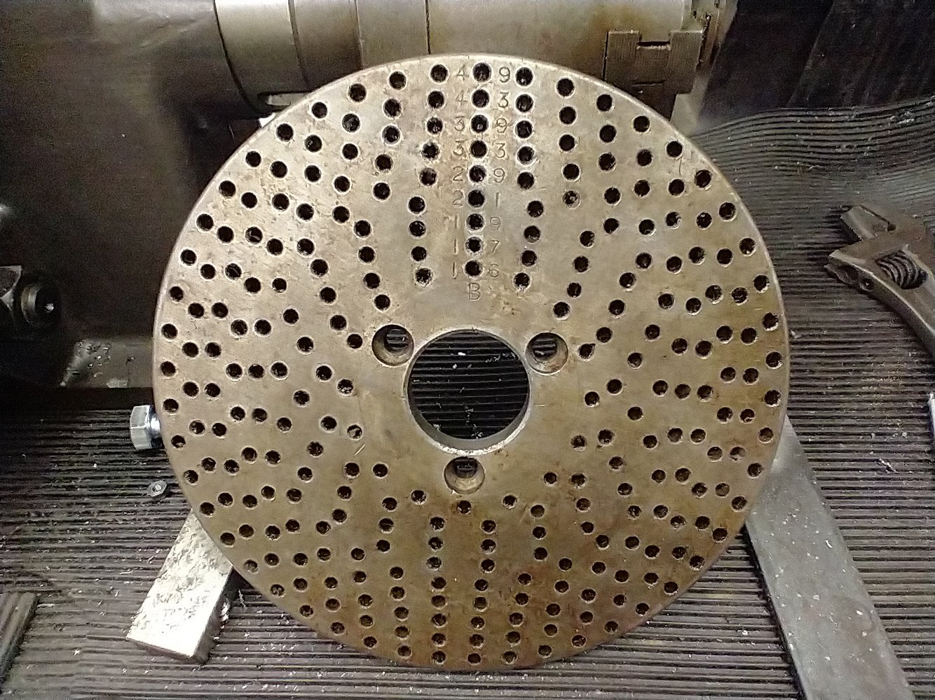

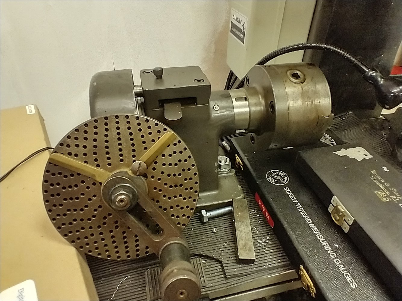

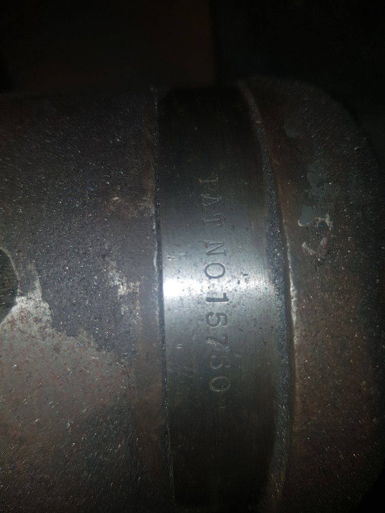

Help needed dose any body have any info on these rotary table.. I have have one but only got the 9ne indexing plate... should there be more then thr one plate...

Can you share a pic of the plate you have? I have an Elliot dividing head I can see if the plates are the same.

To the OP: the important thing to determine is the worm ratio of the table. That is, how many full turns of the handle give one full turn of the table. For that table, my guess is 90:1 but it could be 60:1 or 120:1 or 180:1. Once we know what the ratio is, there are a standard set of plates that go with each ratio.

Will take a pic when I can get to the work shop... I have part numberCan you share a pic of the plate you have? I have an Elliot dividing head I can see if the plates are the same.

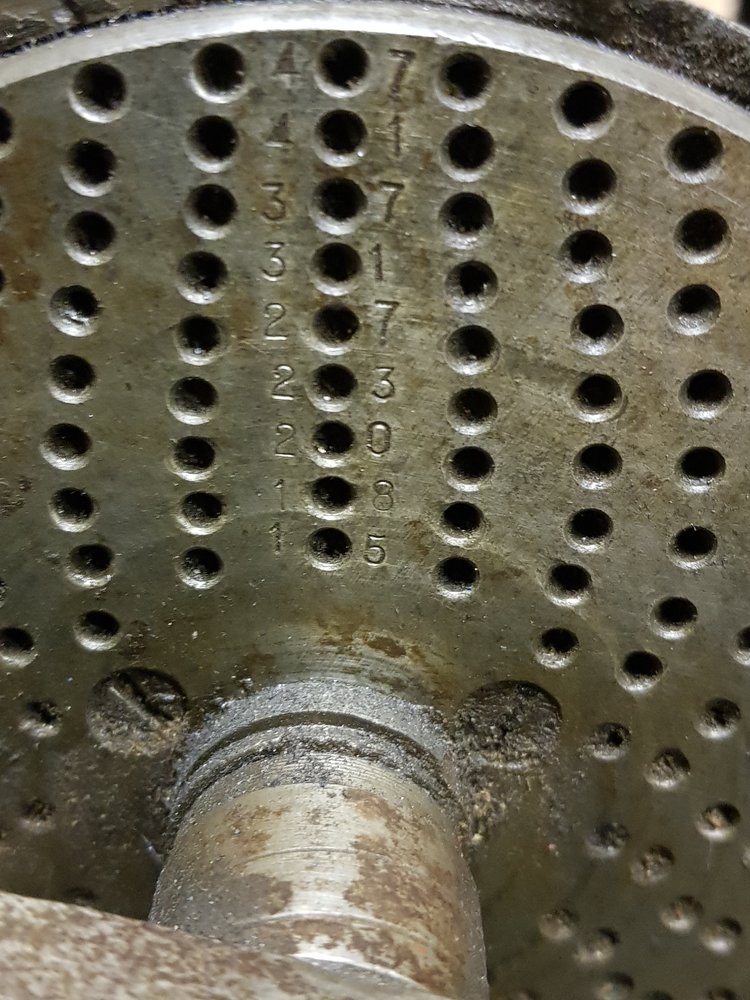

This is the plate I have on the table..sorry for taking so long to get back but not been wellCan you share a pic of the plate you have? I have an Elliot dividing head I can see if the plates are the same.

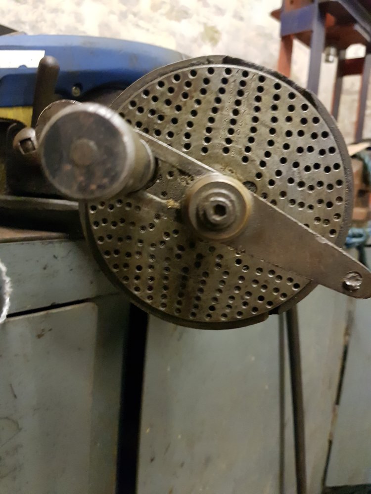

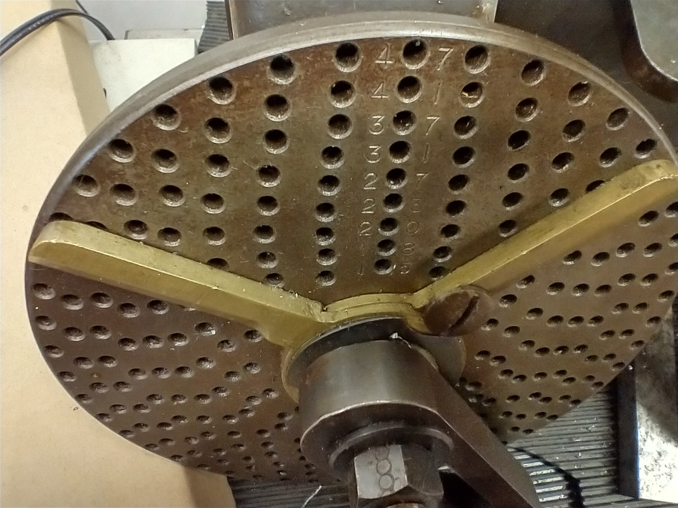

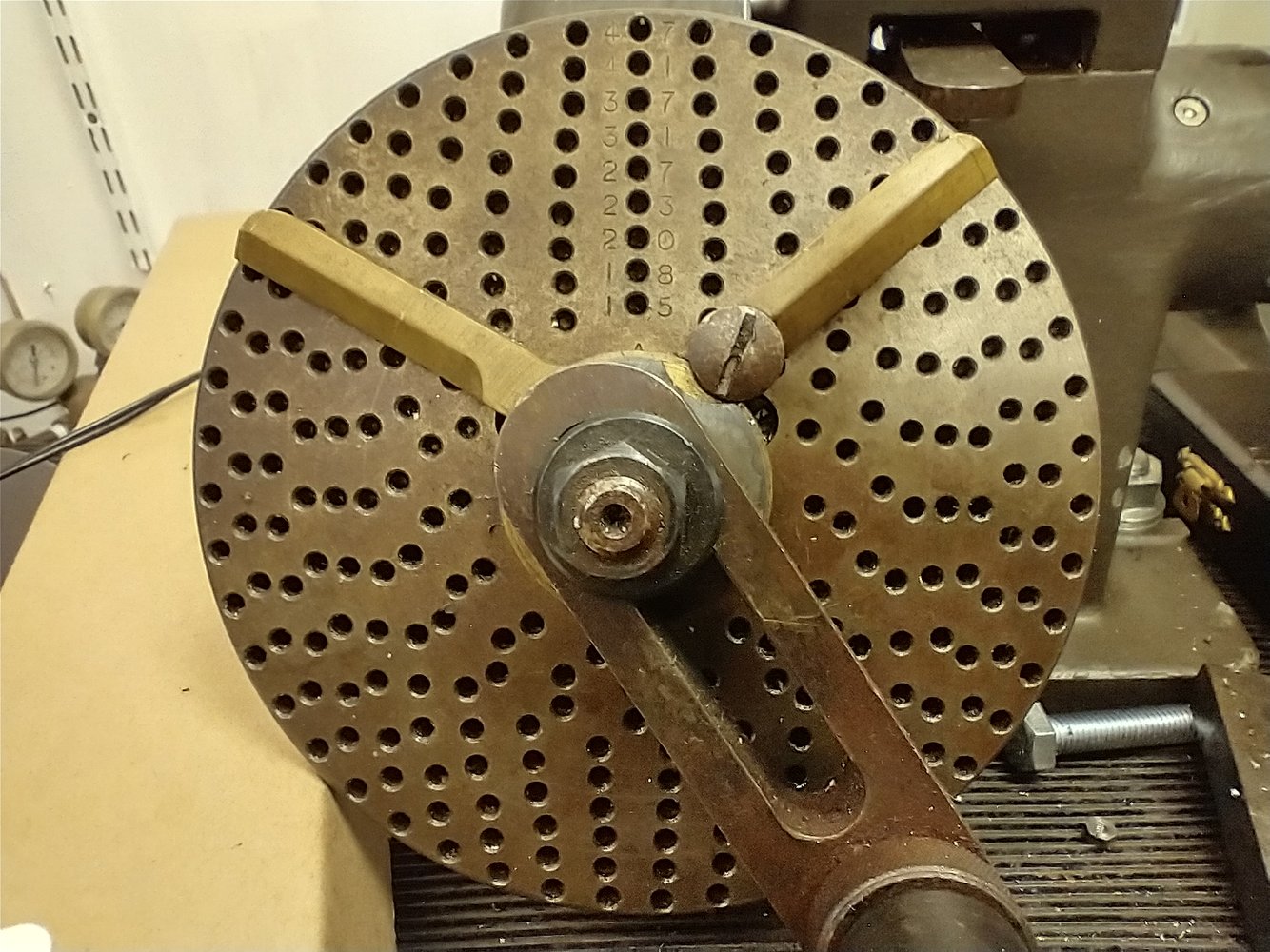

That looks very similar to the plates I have, I'll check and provide photos of the arms on mine and the plates.This is the plate I have on the table..sorry for taking so long to get back but not been well
View attachment 310803 View attachment 310804 View attachment 310805 View attachment 310806
