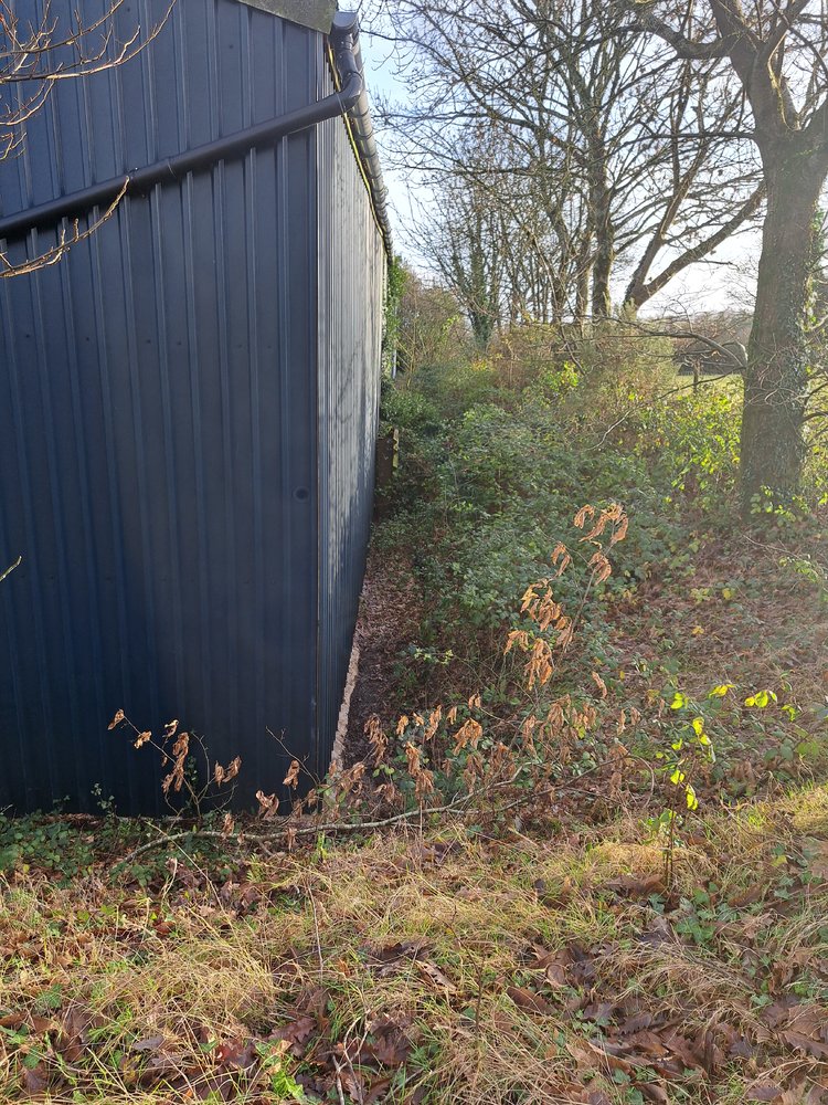

Depending on the structure beneath, water can come up in unexpected places. Cornwall has plenty of "geology" about so I wouldn't guarantee anything.

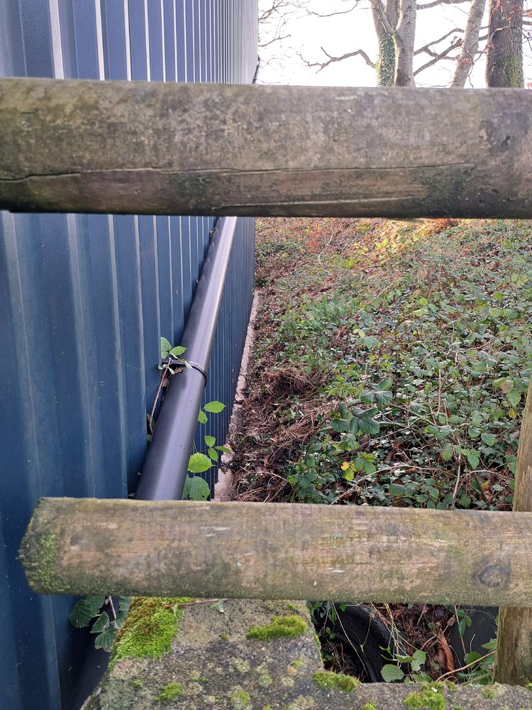

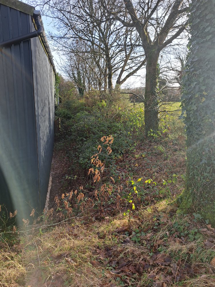

But having said that, a big part of the problem, given recent weather, is likely to be runoff collecting at the back of the slab with nowhere adequate to go. See if you can get that back gulley running away, either through or around the building
If diggering, ask someone who hires them with drivers to call out, look at the job and recommend. Looks like ~8ton would sit in the field and with a ditch cleaning bucket, reach the foot of the shed to clear a ditch that you can run to one side. Get too small a machine and it'll be trying to operate on the slope and won't have the reach to do anything sensible with the waste. But a contractor would be able to recommend better than me.

clay tops and gulleys are deeper than there plastic eqivelent this is where id aim for as you can do a direct to drain french drain
id also take the digger through the side wall and clear the side in doing this you have a few advantages here
you can create a deep land gully and fill it with pebbles any water will aim for this point
land drains can be 1 metre square and deep but you can lengthen them rather well 2ft wide or 16" by the length of the stables would be a good collectiion point of land water

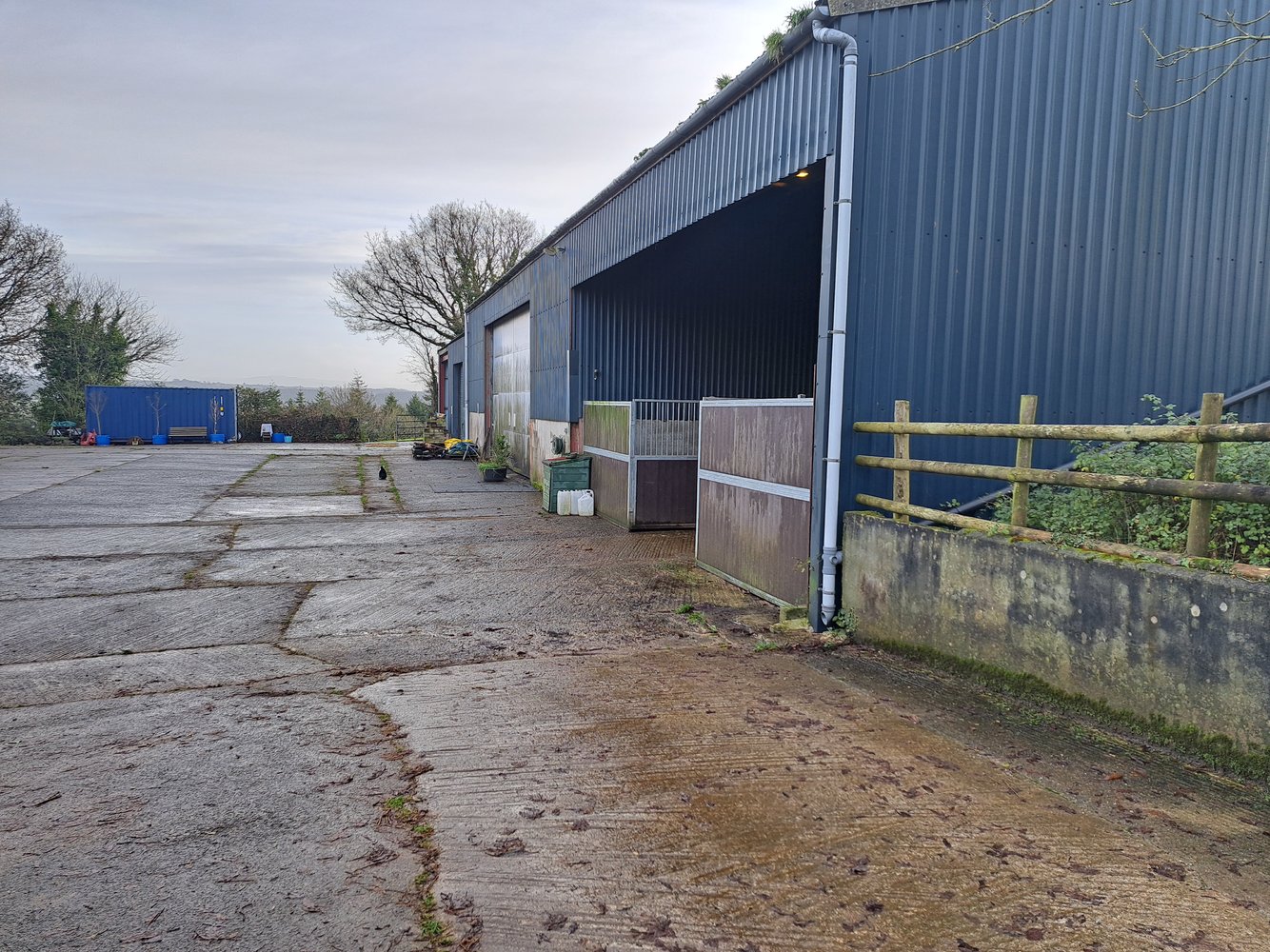

clean out your gutters first.... if they're overflowing they'll be dumping water right at the wall (mostly a problem round the back)
and check your drains are all flowing away ok
whats the ground like around the place, is it all really soggy? is it all on a hill or are your buildings at the bottom of the hill?
dig a hole somewhere lower than the buildings, see if it fills up / how quick it fills up
lets you know if the whole area is soggy or if it's just water passing underneath and popping up on it's way down hill
