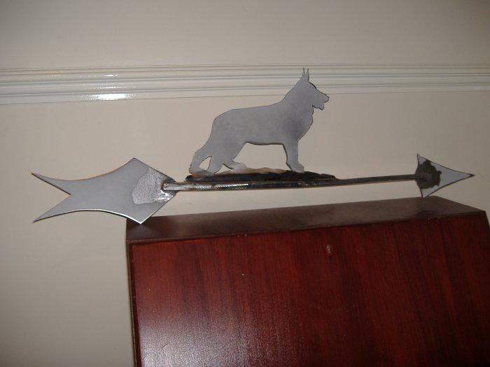

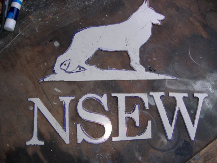

Hi Guys, made a start on trying to make a weathervane, first attempt at this type of thing and skills and tools a bit limited so go easy on me.
Started off with part of a steel box about 1.6mm thick picked up from a local scrap merchant for a few pence, made some paper patterns of a profile, letters and arrow head / tail and drew them onto the box.
Cut out with a jigsaw, cleaned edges up with a file and welded onto some 10mm bar to make the main pointer which is about 800mm long end to end.
That's as far as I have got, an enjoyable few hours spent relaxing in the garage and little bit more practise at welding, this is the thinnest stuff I have tried to weld so far.
and there's a fairly thin line between a weld and a hole
I know you can buy the profiles and letters but it's supposed to be home made and a bit of a memorial for my german shepherd. I Will update as I progress
Regards Norm.

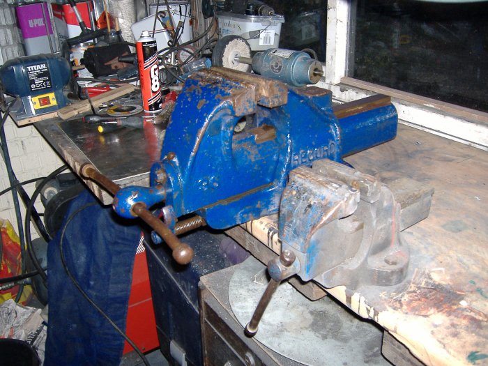

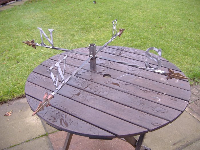

finally resulted in this, early days yet but still a little more progress.
It's mahoosive and makes my original look tiny in comparison
needs a little fettling, a clean up and a spot of paint and I should now be able to bend anything I want as it's more likely to be me that gives up before the vice. Think I'll need to strengthen the workbench first. It's missing a couple of screws for the jaws but I'm sure I'll be able to get those easily enough massive thanks to Roofman for this
