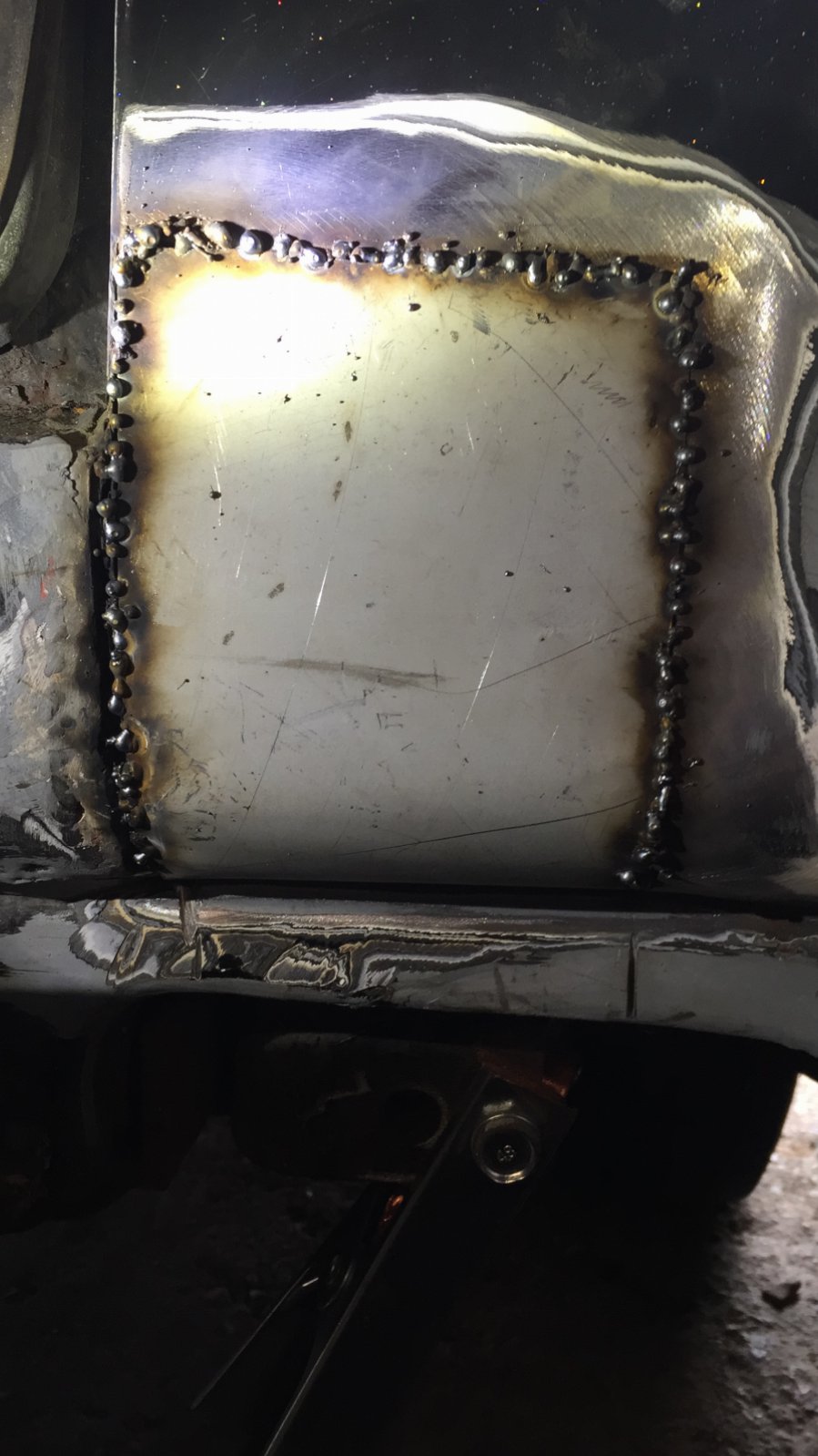

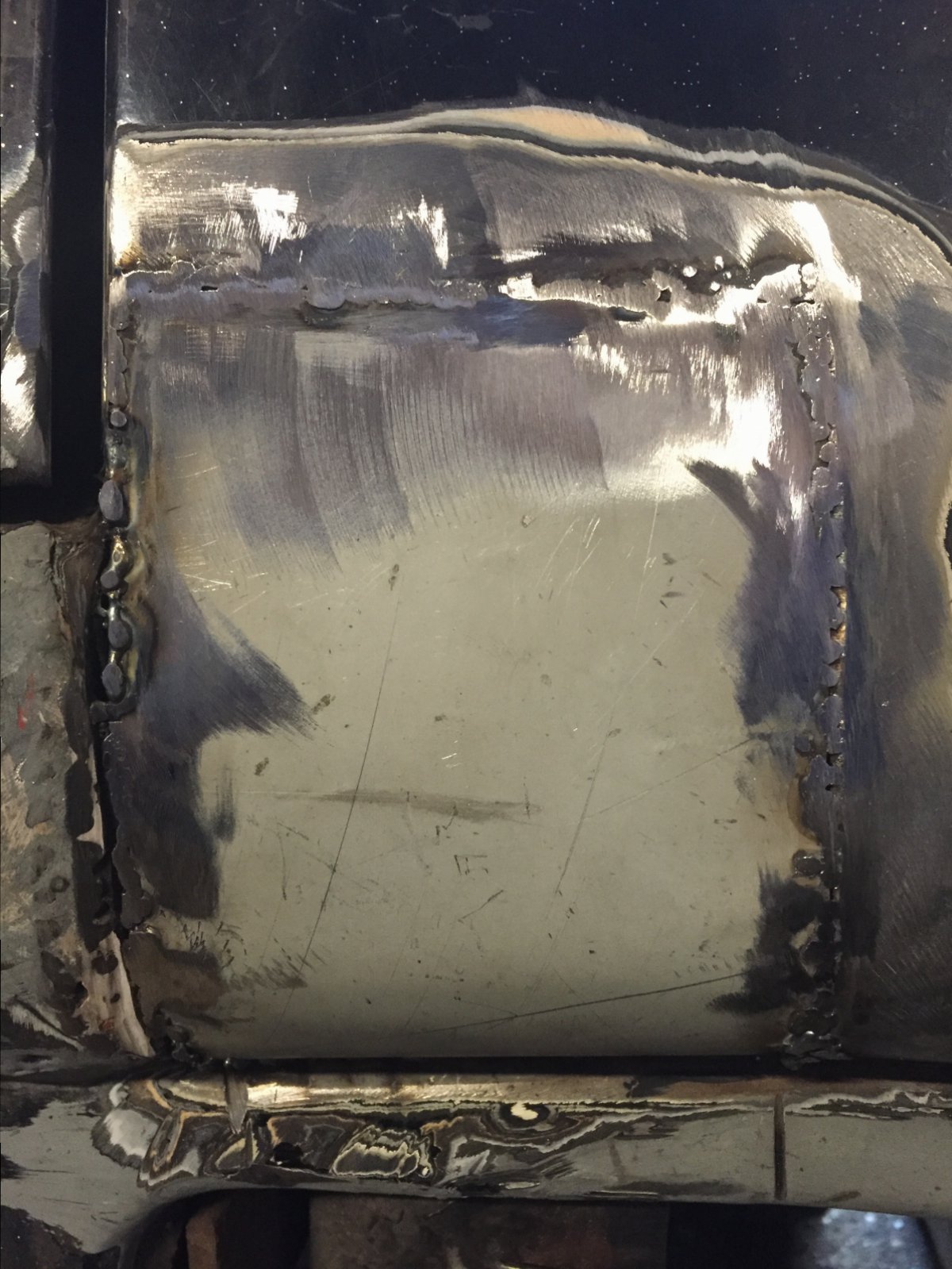

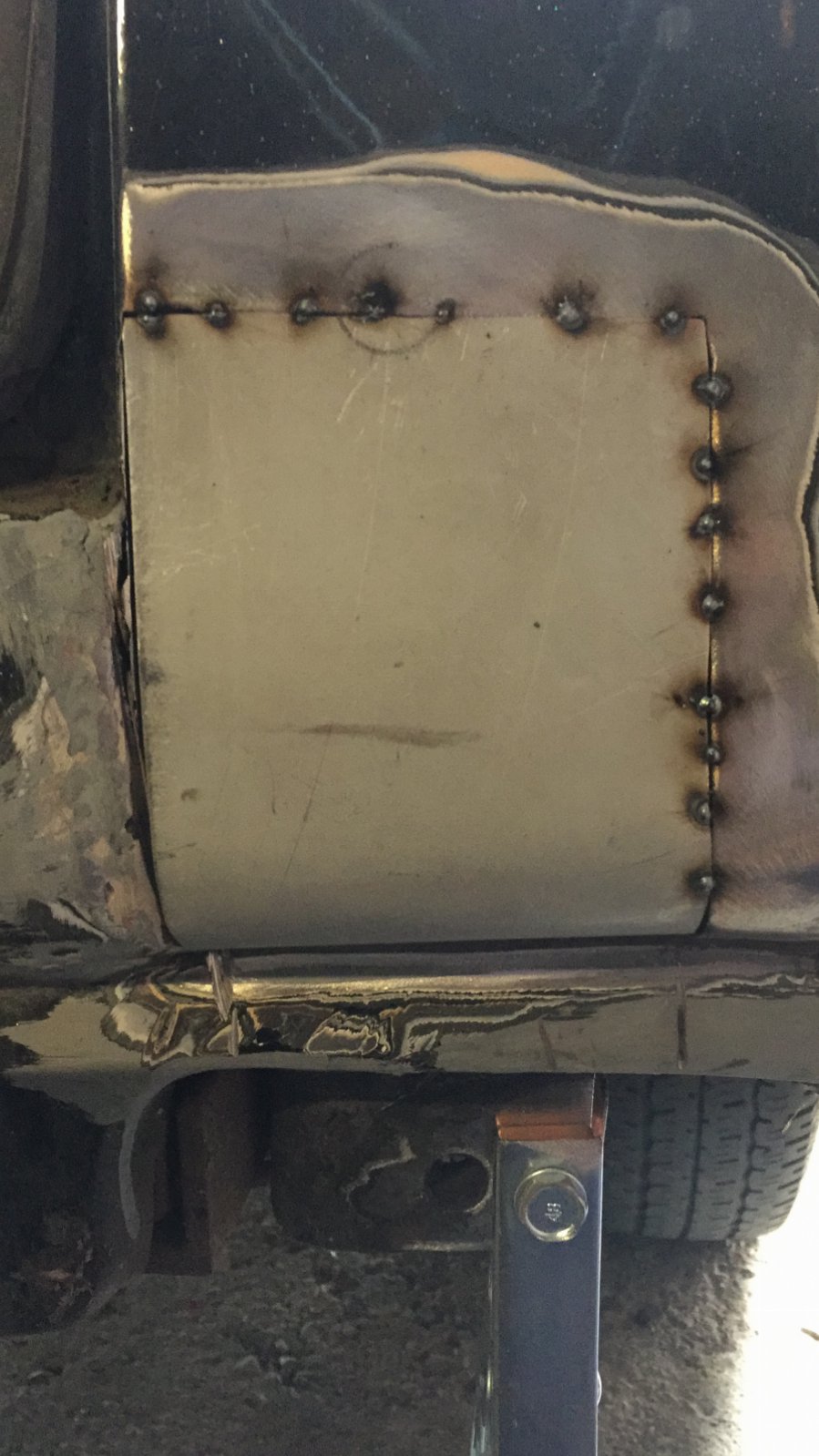

I weld 1mm on those settings with full penetration, sometimes even blow through (operator error), you should see at least some, if not full penetration on 1.5mm using the same settings.
That is the only problem with the design. But I'm a thin strong lad so ill be fine. I did consider putting a hinge on the bottle part for easy removal but lack of hinge prompted a change of plan

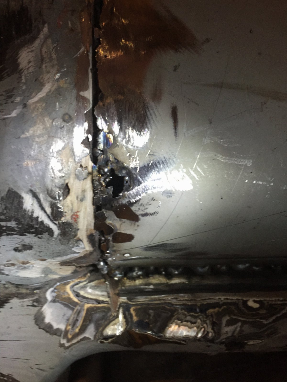

The problem I've got now is that if you look closely you can still see lots of holes. If I weld continuously over it all I'm concerned it will melt holes in it.

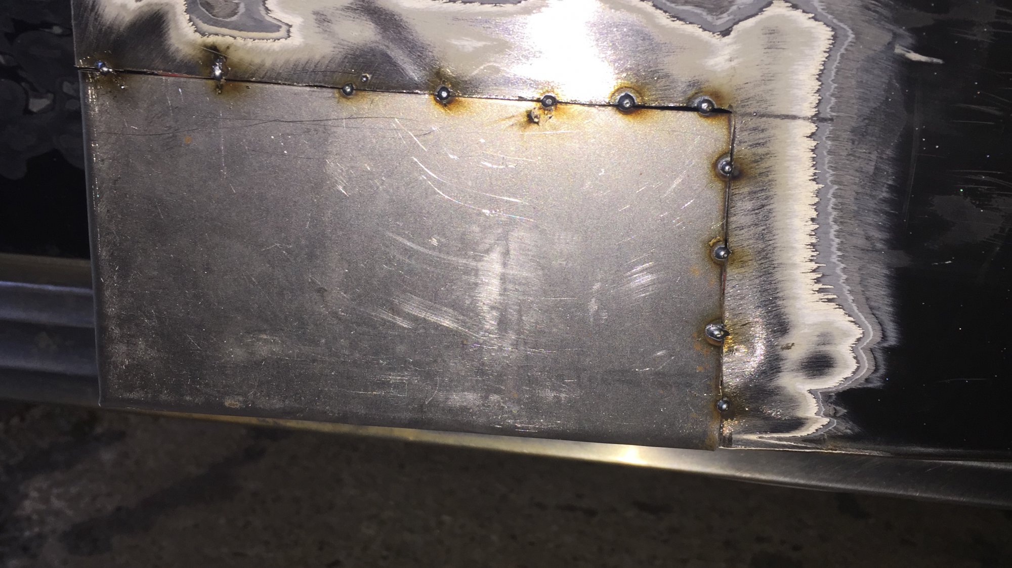

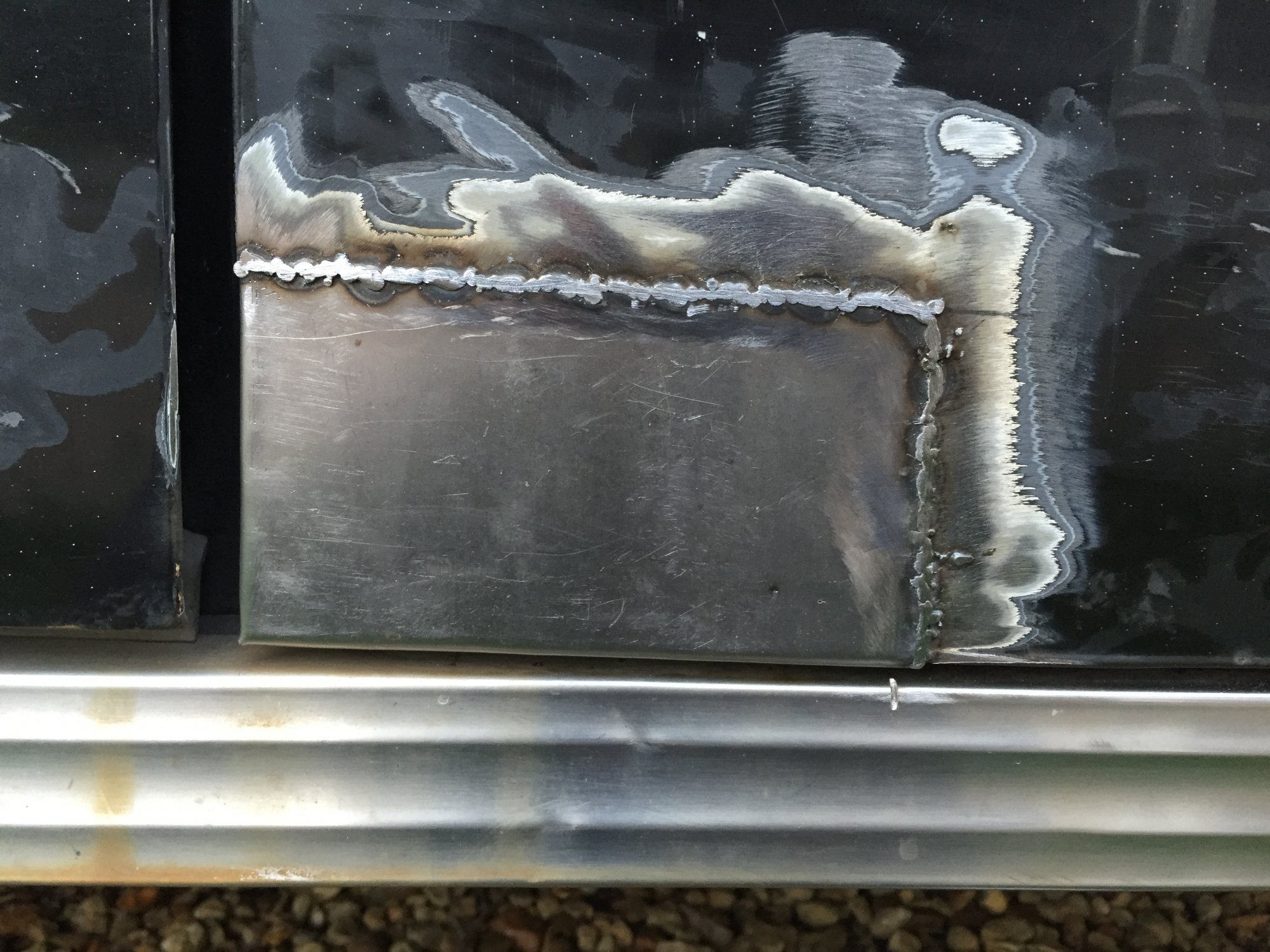

The welds above are flatter but also wider than mine, not sure how to achieve this
Did a bit of welding today. Wire tensioner turned up and what a difference. I may turn it up a little more just because it's not quite right but very nearly
