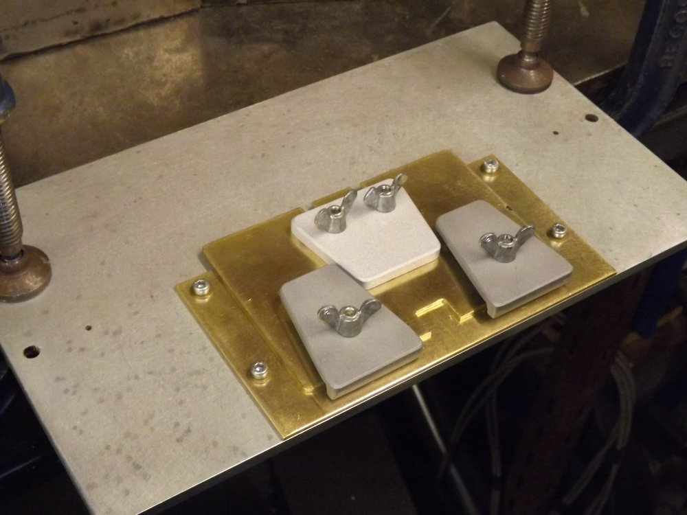

New bandsaw blades are welded autogenous. 312 or 309 would be my choice as filler when TIG welding them, but I have 312 on hand.Used the weld back together with 312 filler and pein it with a hammer straight away used to last a good while until we got replacements
Likewise, that’s what I do until the blade becomes too short….Have silver soldered mine a few times, easy enough to do, I made a simple jig out of angle and feather the cut edges of the blade
