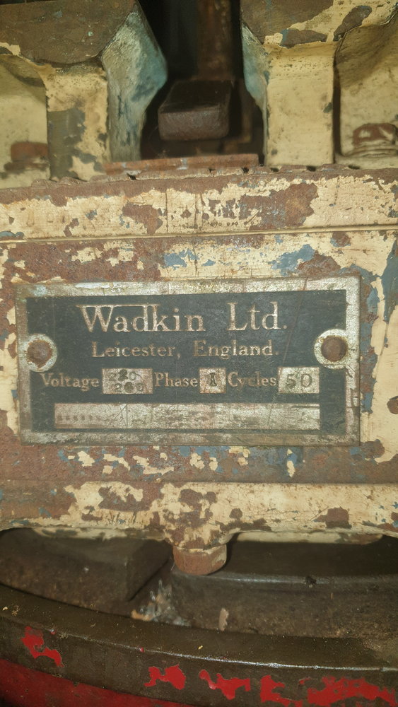

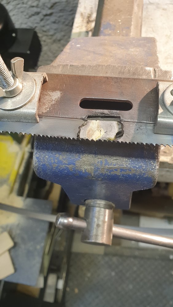

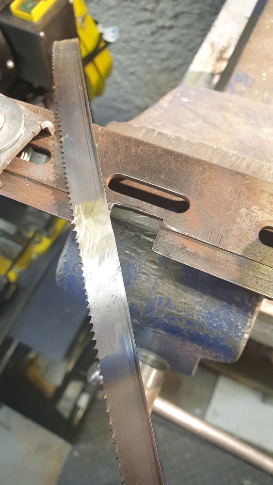

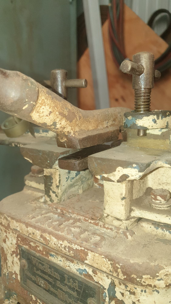

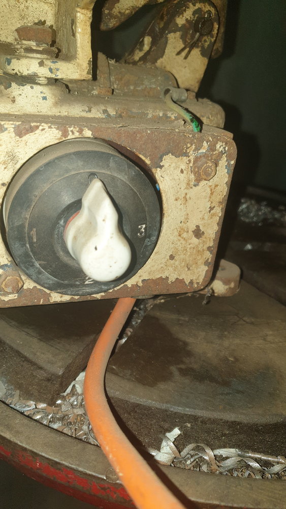

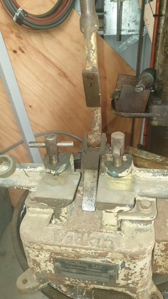

Hi Jim,yes that's the same one that I have,afraid I've not got a manual for it, but I make a very shallow scarf angle about3/.8" -1/2" long so there's a good area of contact to silver braze,I then mix a liquid easyflow flux with a small dab of washing up liquid & coat the joints & put a piece of silver braze in between if it's round I uusually hammer it flat then put in the jig & press down on number 2 [depending which temp range ] then it melts & switch off keeping it clamoed & your ready to clean itup to thickness you can put it on higher to anneal it but I dont bother hope this helps.HI Artfull Codger, I too have a Wadkin bandsaw brazer. Would you have the operators manual for this or know the procedure for it's use.
thanks you Jim.
