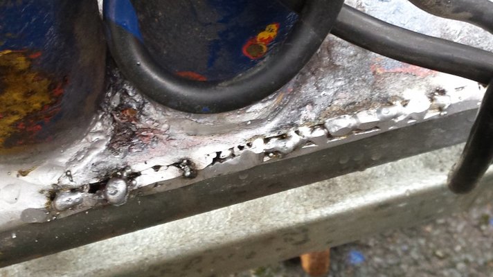

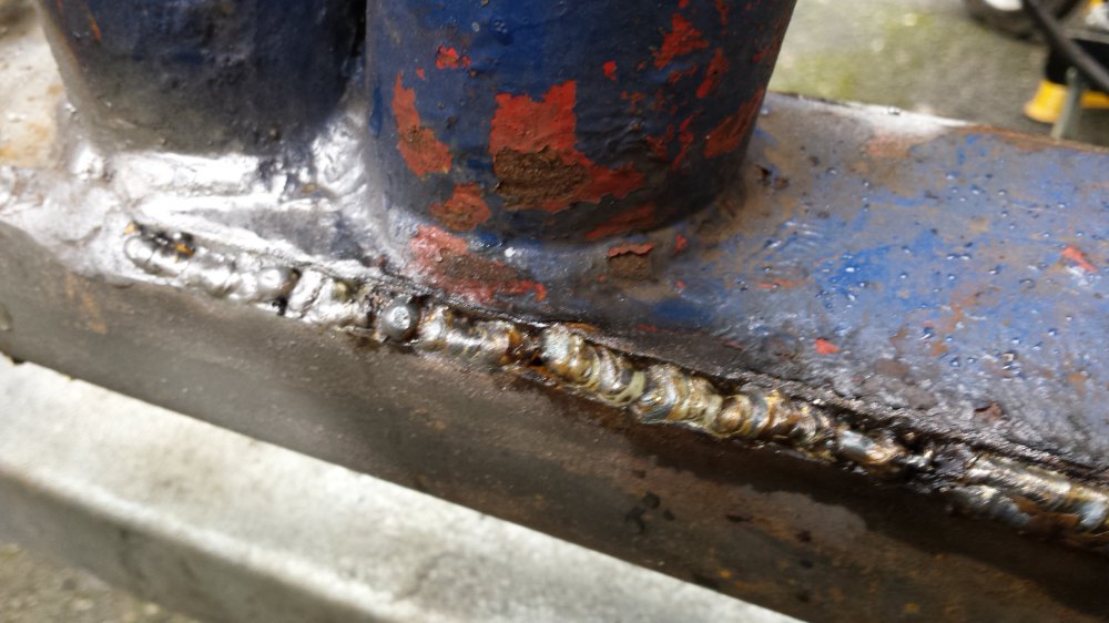

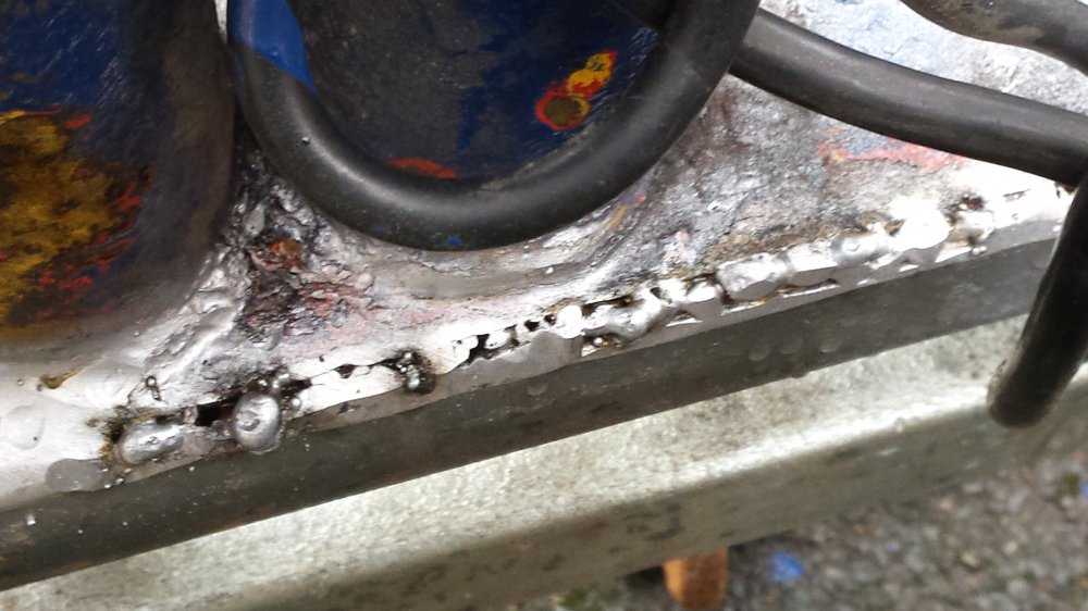

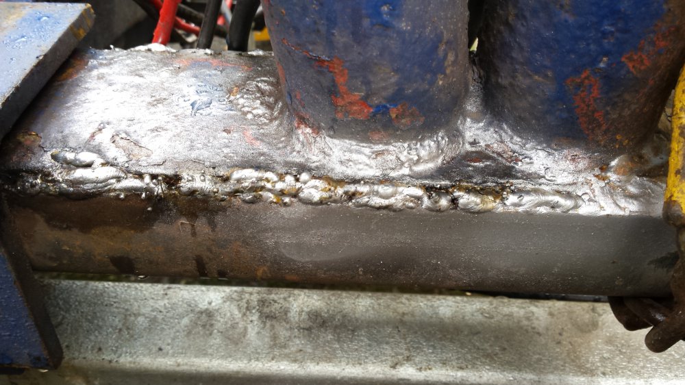

Going to go off on atangent here.We talk about putting your ear up to the nozzle to listern if gas is flowing.When I was serving my time with welding equipment my theory WAS to listern for gas,but I was soon taught that if you stick a lighted fag on the end of the nozzle,if there was gas flowwing out,the fag would go out!
Yes but it's a take your pick without working thoughtless possibles one by one prooving or disprovingSounds like volt drop
Basically yesWhile we on the subject I have started using my migatronic 180 mono on a heritage railway it welds perfectly (For what I want anyway).but every setting seems to be up a notch since moving it from home. The power source (13 amp) is about 35 metres distant its forever tripping, 2metres at home no probs, Length of cable or 13amp socket or both at fault?.![]()
