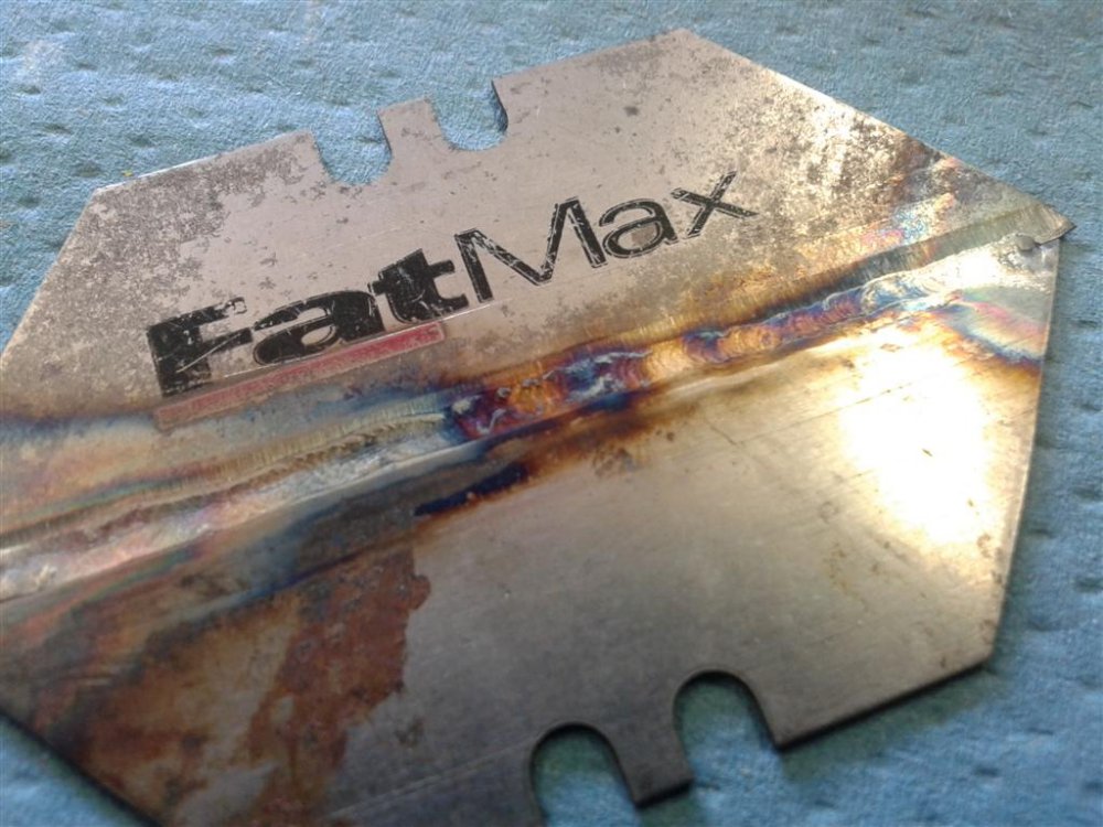

I will get more blades & try a but weldNo big deal to do it that way,
The thickest edge of a blade onto the middle of another, hmmm.
sounds good though saying you can weld stanley blades,
A while back i was having a mess around doing end to end ali coke cans, much harder.
Morris Marina sill sections LOLOn a side note...whats the hardest material people have ever tried to tig together? Alu baking foil? or is there something worse?
I'd love to see that in a future video JohnA while back i was having a mess around doing end to end ali coke cans, much harder
.I had three or four of them in the 80's, disposable cars, I would buy them with a years tax and dodgy mot and run them till they died. One brought five of us back from Devon on only three pots, by the time I got the head off in London one of the pistons was almost entirely gone. It did need about a gallon of oil every servise station along the M4 and made a smoke cloud worthy of James Bond, oh to be young and care free again.Morris Marina sill sections LOL
I've done this a few times having a mess about. The coke can is not too bad as its bigger diameter makes it easier for stability and heat conduction. Try a couple of red bull tins. That's even more challenging.No big deal to do it that way,
It's not always the thinnest that's the hardest. Some Alu car panels contain copper, zinc and loads of unfriendly rubbish to add strength. The weld cracks almost immediately after a tackOn a side note...whats the hardest material people have ever tried to tig together? Alu baking foil? or is there something worse?
Next you should try a butt joint at the sharp edges![]()
Switch or pedal?Just messing about earlier, started off at 9 amps but a bit too hot, then dropped it back to 4 to finish it.
Switch, I don't use a pedal,Switch or pedal?
And the point is ???
The crack of dawn or a broken heart.On a side note...whats the hardest material people have ever tried to tig together? Alu baking foil? or is there something worse?
If fit up and speed/amps are very good you could do it autogenous. It would be pretty difficult trying to dip any thing into a 4-9 amp pool.What did you use for filler a bit of 0.6mm mig wire or nothing at all?
