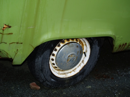

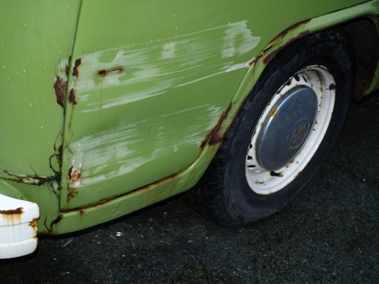

Looks like you will be dealing with rust more than accident damage. Should get it inside and take the bubbly paint off to see what's underneath.
Ive got one of them, that a international transport company tore off the rear bumper in a amazing fit of mishandling getting it on and off a flatdeck to come over to france to live. Ive got to do some chassis repairs to the rear frame horns as theyve tore out where the bumper bolts, so might be worth checking to see if yours has got any damage there as a result.
Mines a devon mind, still the same late bay base though. I had to replace my rear quarters too from rot, but just wimped out and bought the repair panels from vw heritage in sussex...

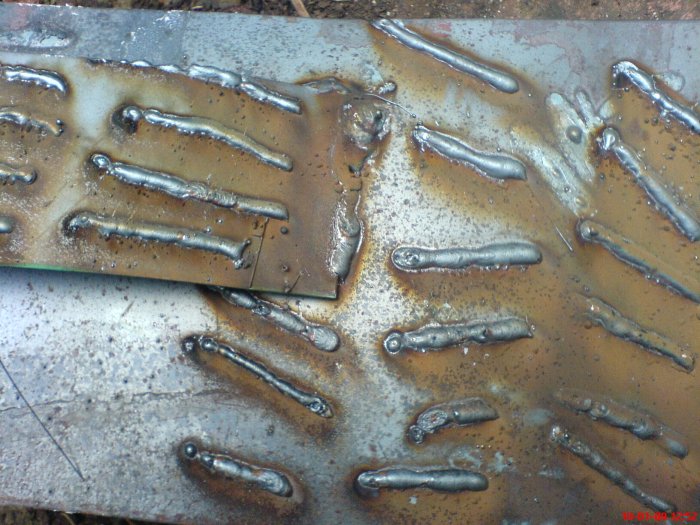

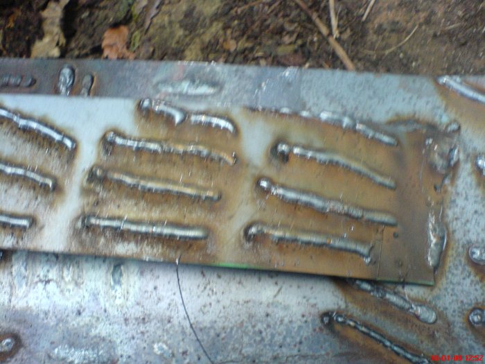

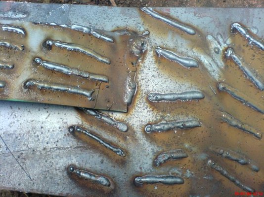

produced a variety of welds, some were too embarrassing to show.... but some i was quite happy with. after couple of hours, as suggested on here i found that with a two handed grip i could control better, the speed and angle.
see what you think, feedback much appreciated.
was surprised by all the rust, these are fresh welds, does that suggest prob with gas or the wind maybe or is it normal?
The rust will be due to the wind blowing all of your shielding gas away. A wind break of some sort might be worth a shot - it would make it warmer too. Could also be the distance between torch and metal is too large.
Looks like it's working though. Which welder did you buy in the end? Worth concentrating on getting a weld pool going and taking it with you as you move the torch. That'll help when you get to doing joints. There's a video on http://www.mig-welding.co.uk/learning-mig.htm that might be worth a look.

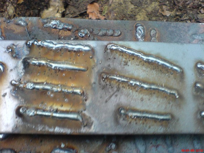

well still not picked up the grinder, but managed to find time for some more welding, pics to follow when it stops raining....
finally got a house sorted, but it aint got a garage... Just couldn't find a house with a garage tall enough to get my van in. got a shed and a sheltered place to work in peace. Been driving the wife mad turning down houses so she's happy now.
the clarkes running sweet now, using 2 mil sheet an box section, power on the 3rd setting out of six an wire speed between five an seven. duty cycle not been an issue, cos keep stopping to look at my handiwork. managed to break a few of my welds, but most hold.
