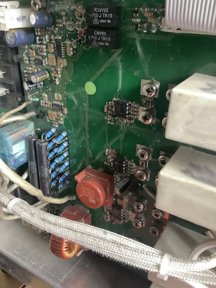

Yeah, unfortunately. Jan-DIY I haven’t tested it yet as no 3~ at home. When I bought it it was for parts with apparently intermittent error code which seller doesn’t remember. Tomorrow I am going to do that at a local business and see what the problem is. I have 400ac from a boost transformer and it came with a U-P for probably a phase missing as I see a row of resistors and 2 optos for that purpose on the BPS 26 board.Ah.
