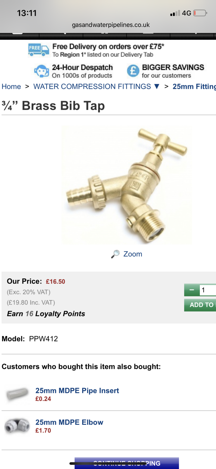

brass tap came with this fitting, expecting it to be 3/4” BSP I ordered a hozelock connector and it’s miles too small.
3/4” BSP tap is too small, 1” BSP Tap too big.

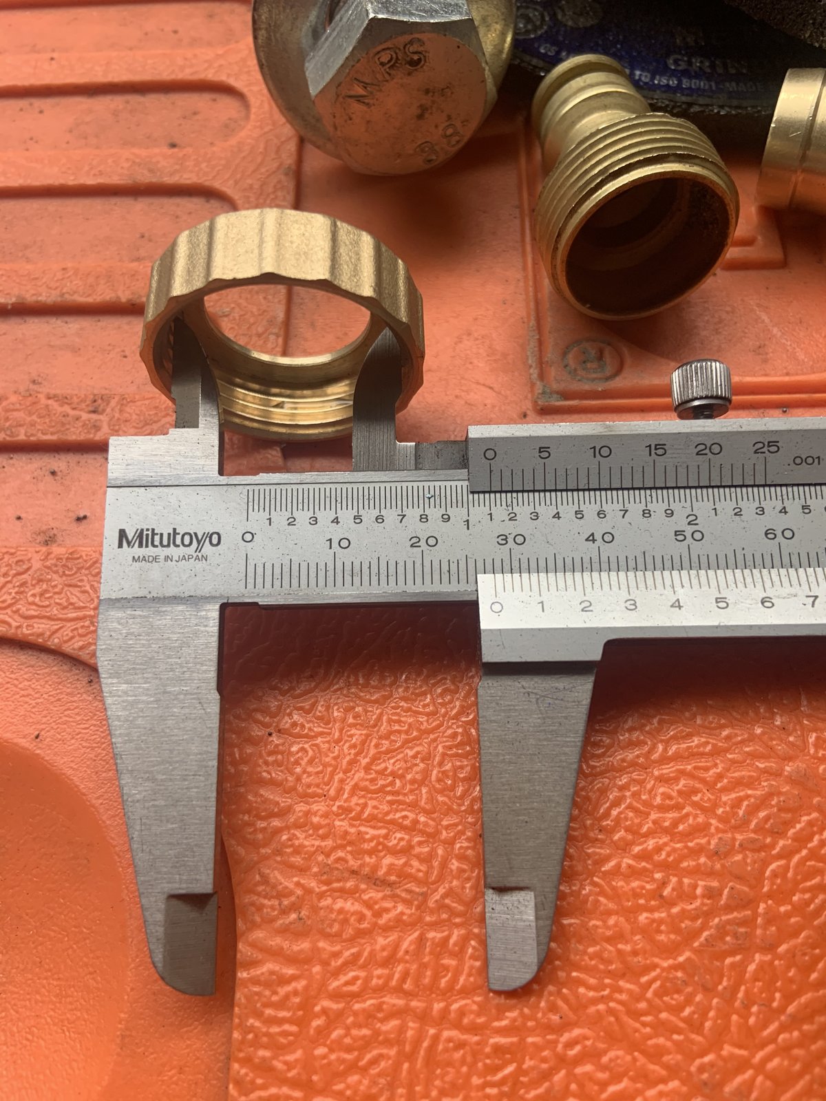

1.105” or 28.08mm minor diameter threads.
Can’t find my Whitworth thread gauges, but it’s somewhere between 1.75 and 2.0mm pitch on my metric ones.
