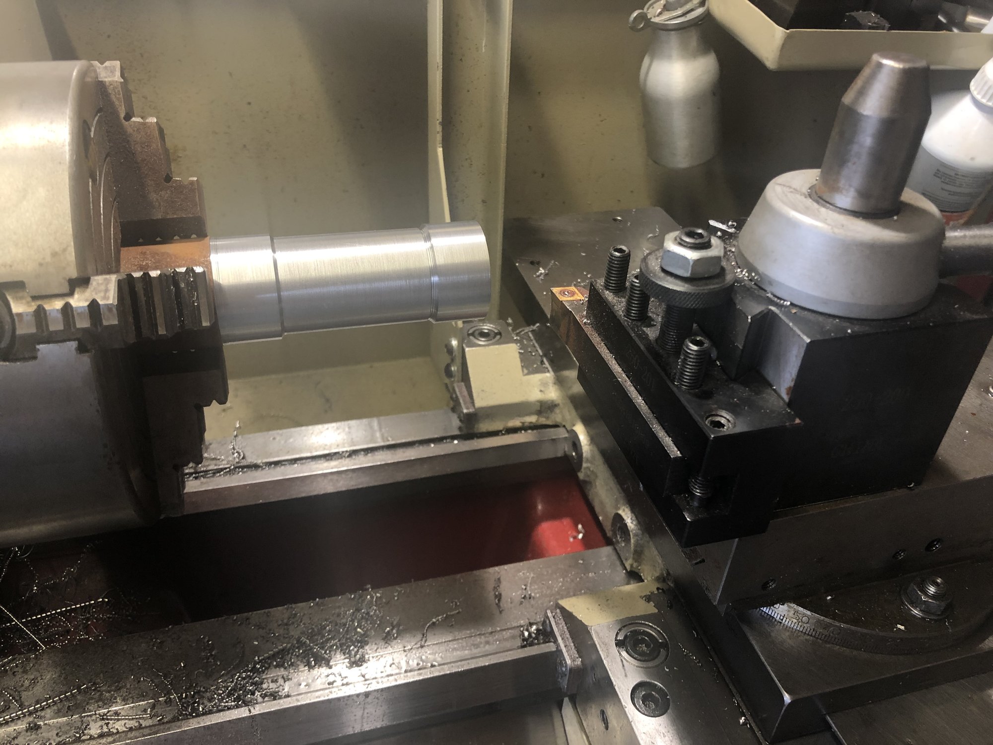

I properly levelled the ways at both ends using a machinist level and made a test bar up. Tweaked the front tailstock leg I now have a 0.003mm taper over 150mm the larger end being near the headstock. This was on 40mm steel with .002mm cuts.
I wasted an hour trying to get it better but seemed to be travelling down a long dark rabbit hole.
What’s the thoughts shall I call this good?
