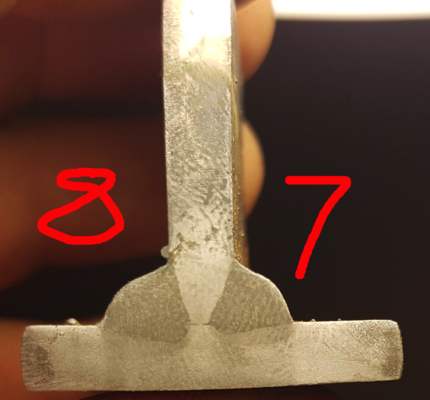

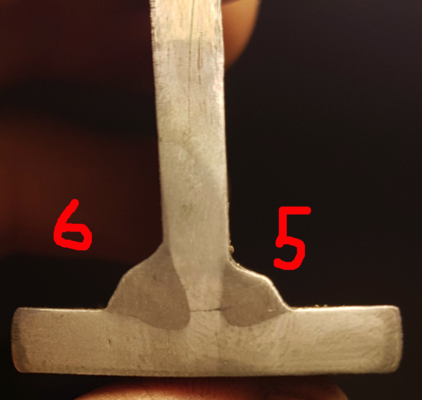

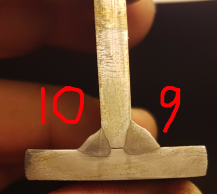

Is the polarity the right way round. I had mine wrong and all the welds sat up, swapped it over and wow I can weld again?
More things it could be...

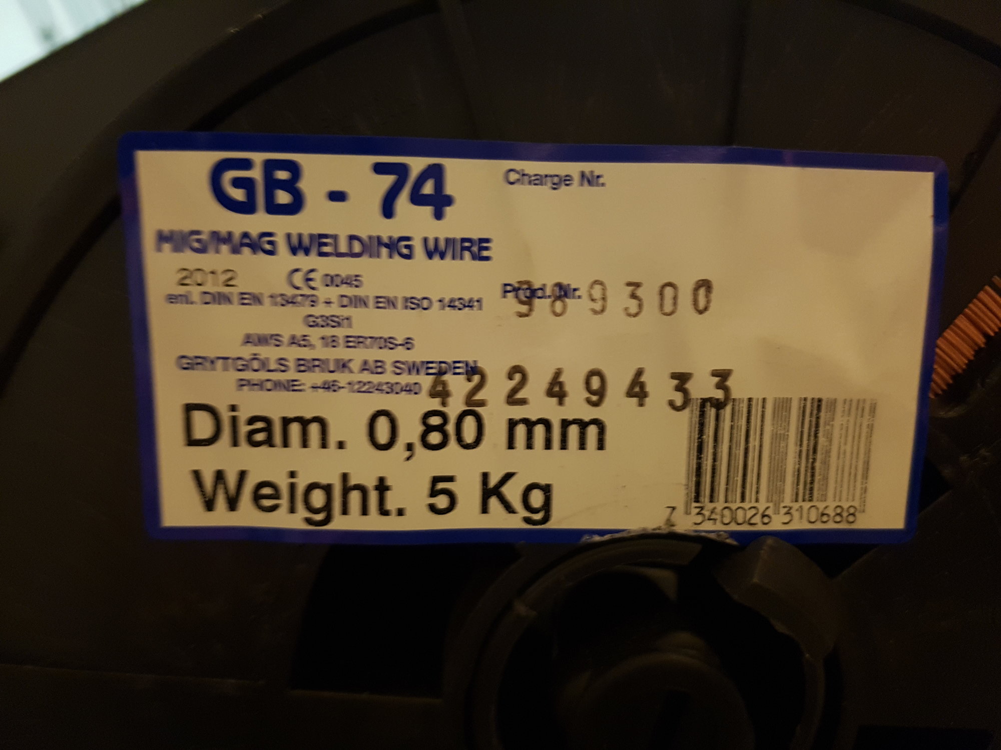

What’s your wire?

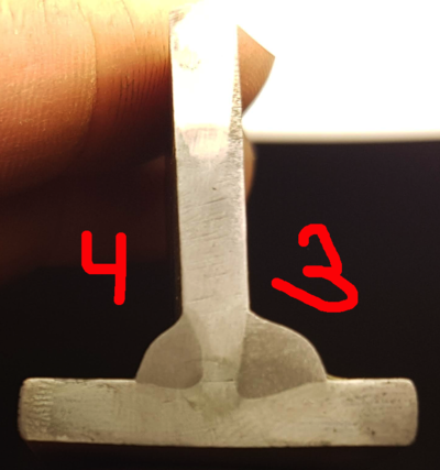

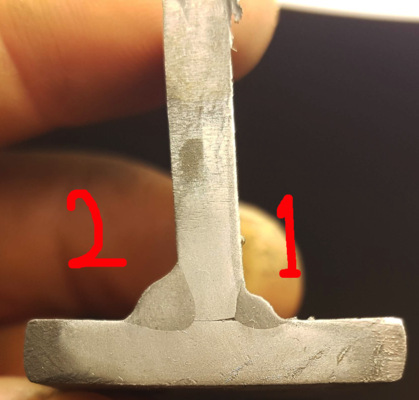

Think you’re chasing your tail a bit. When you switched to push and stopped trying to lay down a big, fat bead (Picture #4 half way along) I don’t think you were a million miles away from okay, without practicing the series of ‘e’ or similar to get a larger bead without that convex profile using 0.8.

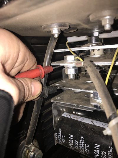

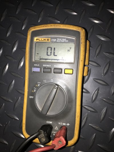

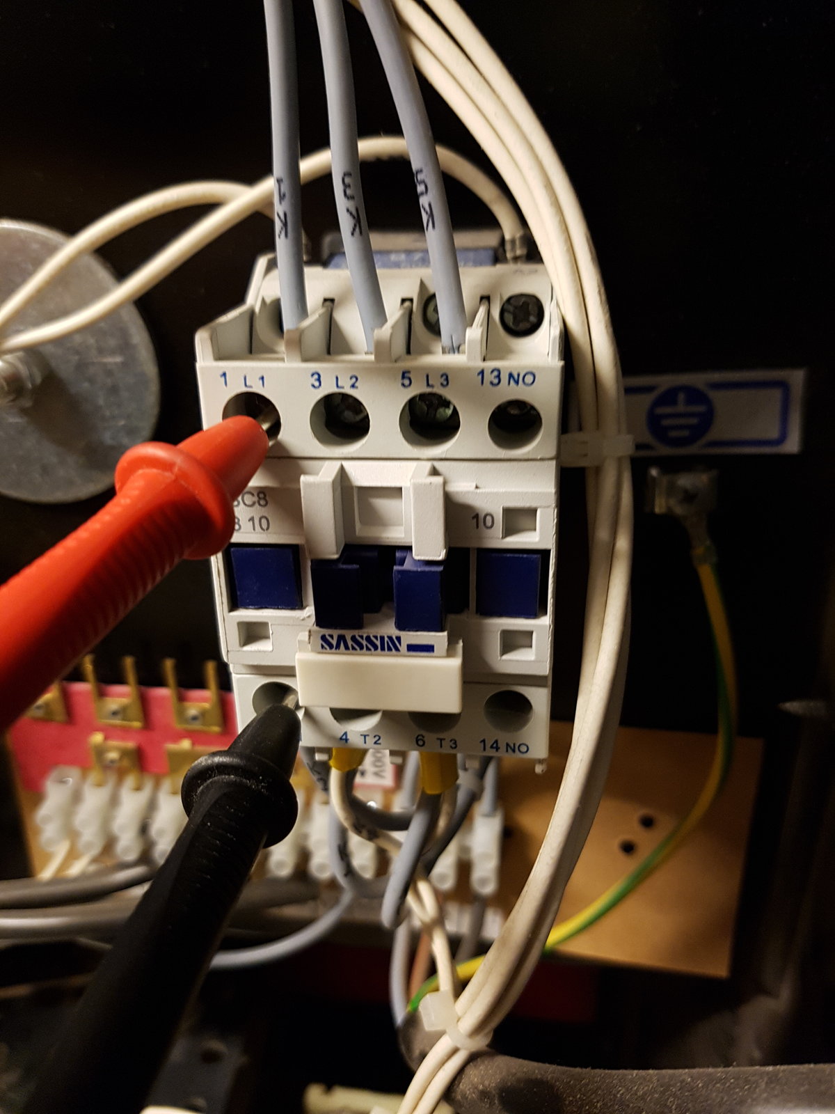

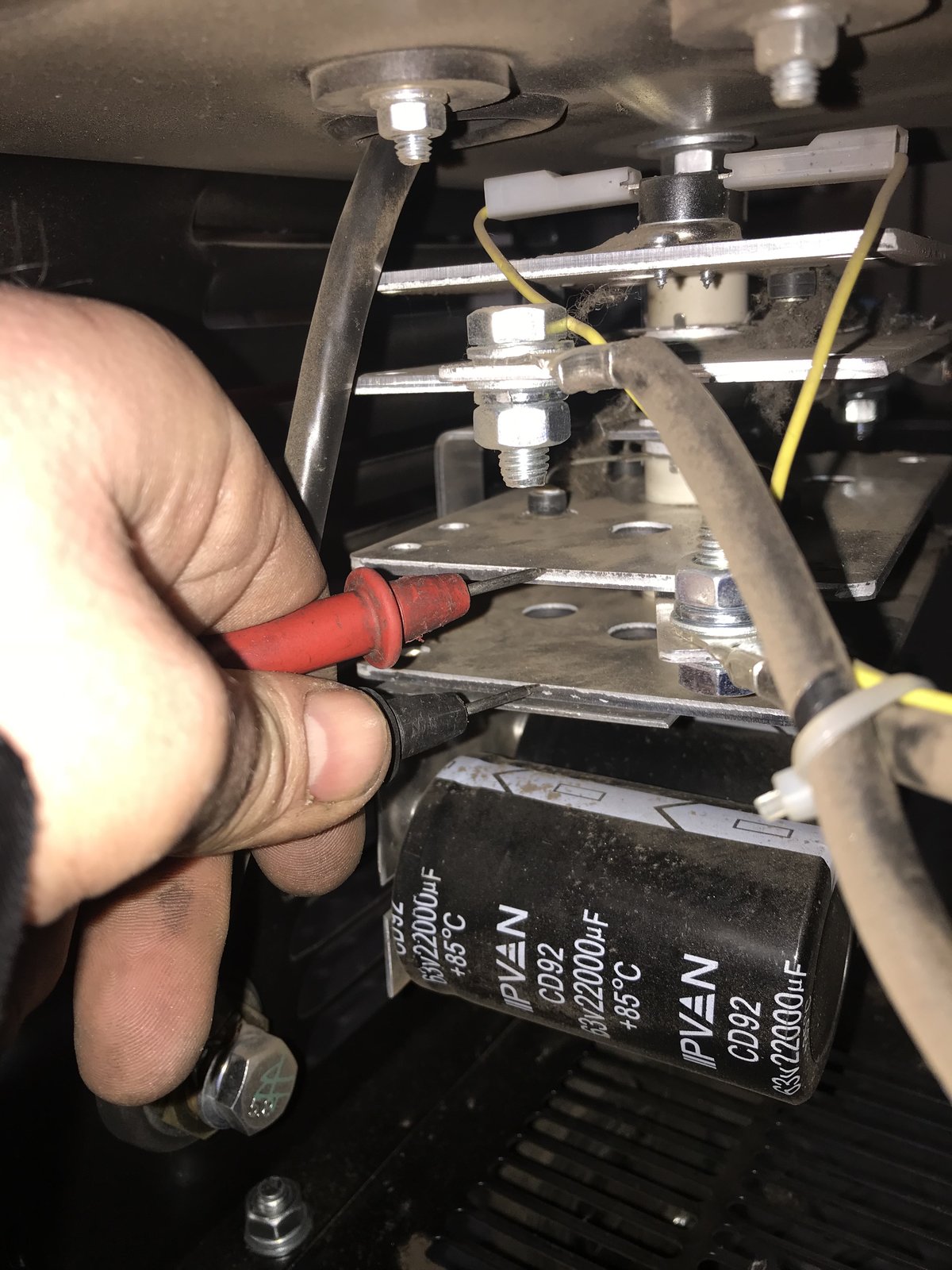

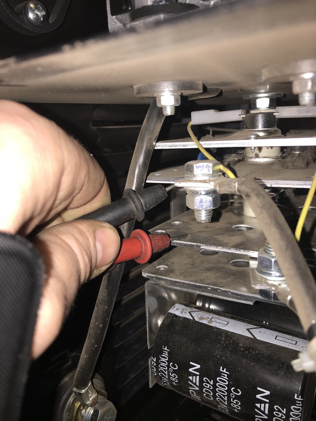

You are measuring in the right place but it needs to be done with the contacts closed.
Are you saying I should aim for a smaller bead?
