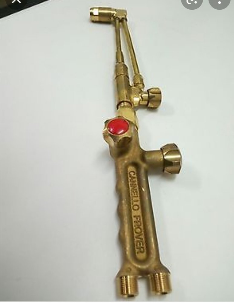

You only open the torch valves up as much as you need whatever the pressure is set to at the regulator.
That's the cutting torchThe problem is that if there's no valve on the cutting lever what comes out depends on the pressure set. Also, not paying attention to your gas pressures increases the risk of flashback dramatically and if you do get a flashback having the pressures wound right up increases the hazard significantly too.
