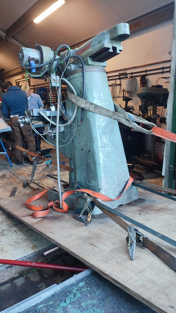

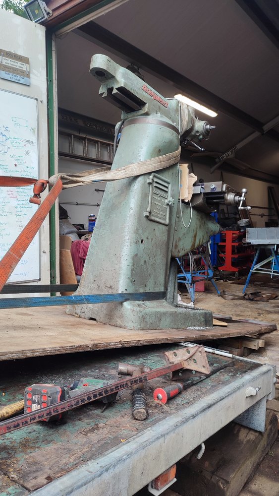

Even the baby 500kg Tirfor/Jockey hoist with 6mm wire rope will easily pull a 5000kg lathe on rollers. I also dragged a stretched American Limo up a very steep slope with one.
The biggest Tirfor will pull a fully loaded fire engine sideways up a grass bank. Yes helped with that one. Also used to drag a full 20ft shipping container up a steep slope using greased railway sleepers.
They are VERY slow though. My brother says you could use them to nick stuff as they are so slow people won't notice the thing moving!
