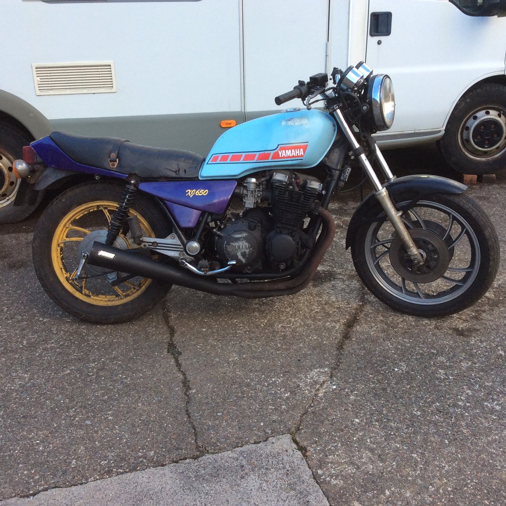

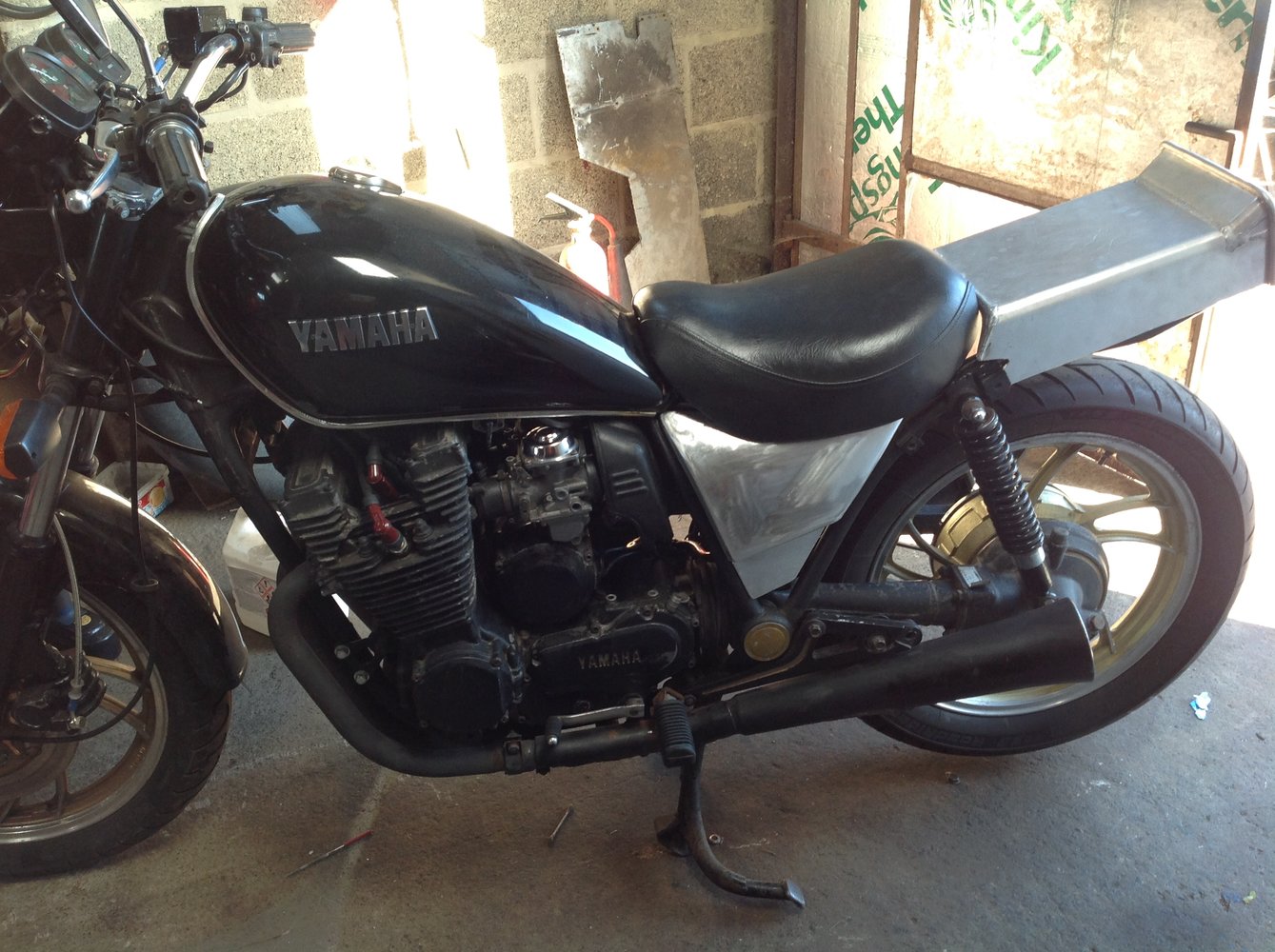

The decision is made on wheels, it’s tyre that needs pinning down, and I expect to buy one, fit it, measure up, remove if from the wheel for machining, then refit.
I suspect that the innate difficulties of altering much (due to the shaft drive run and alignment) the drive system is going to dictate your max tyre size - end of.
The issue I think, is that you're not really going to be sure if an oversize tyre will clear the swinger - until you actually fit it and inflate it?
Even then, if its very close, then when you ride the bike any tyre deformation might kibosh what looks great stationary.
Sounds like it'll be a "suck it and see" job.
so I can get my head around wot your trying to do LOL & IF the pics that have been put up are the bike ? then a xs1100 wheel will NOT fit
