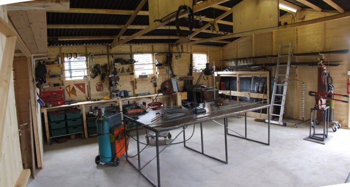

Finally got the garage cleared out to a point where I can put a bench in.
Few things I am trying to work out before I attempt it.
1st: The main structure of it (legs and support bars) Do I buy some dexion type stuff or would normal angle iron be better? If Dexion, anyone know of a cheap online supplier of dexion or alternative? If angle iron, what sort of size would be strong enough? I have found some supadex angle which is 40mm x 40mm x 1.6mm, do you reckon that would be strong enough to make a bench with?
2nd: The top. I am not that rich, so buying 10-15mm steel sheet isnt going to happen any time soon. I have access to plenty of kitchen worktops for free, so I was thinking 1 of them topped with maybe 2-3mm mild sheet. I know heat will warp it, so my plan was to put plenty of screws in and when I need to weld, use a small section of 10mm plate under the weld to absorb the heat.
3rd: Protecting the rest of the garage. Due to the garage being a dumping ground for various things including fuel for chainsaw and mower, I need a way of stopping the sparks from the welding from setting fire to the garage and me Would a couple of boards covered with 0.9mm steel sheet going from bench to ceiling at both ends be enough or would I need to cover even more?
Ideally I would like to be welding the frame together rather than bolting it, as I need the welding practice
