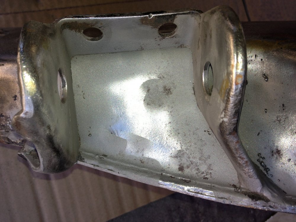

yea they get there EVENTUALYA quick update I did buy a spot blast kit from machine mart yesterday and I tried it today. It was cheap £18 and it does it job although the nozzle is bulky and the recycle bag is already torn but thanks for the help.

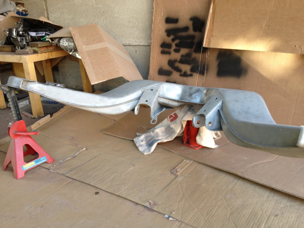

That's one of the pictures I've taken while spot sand blasting.
